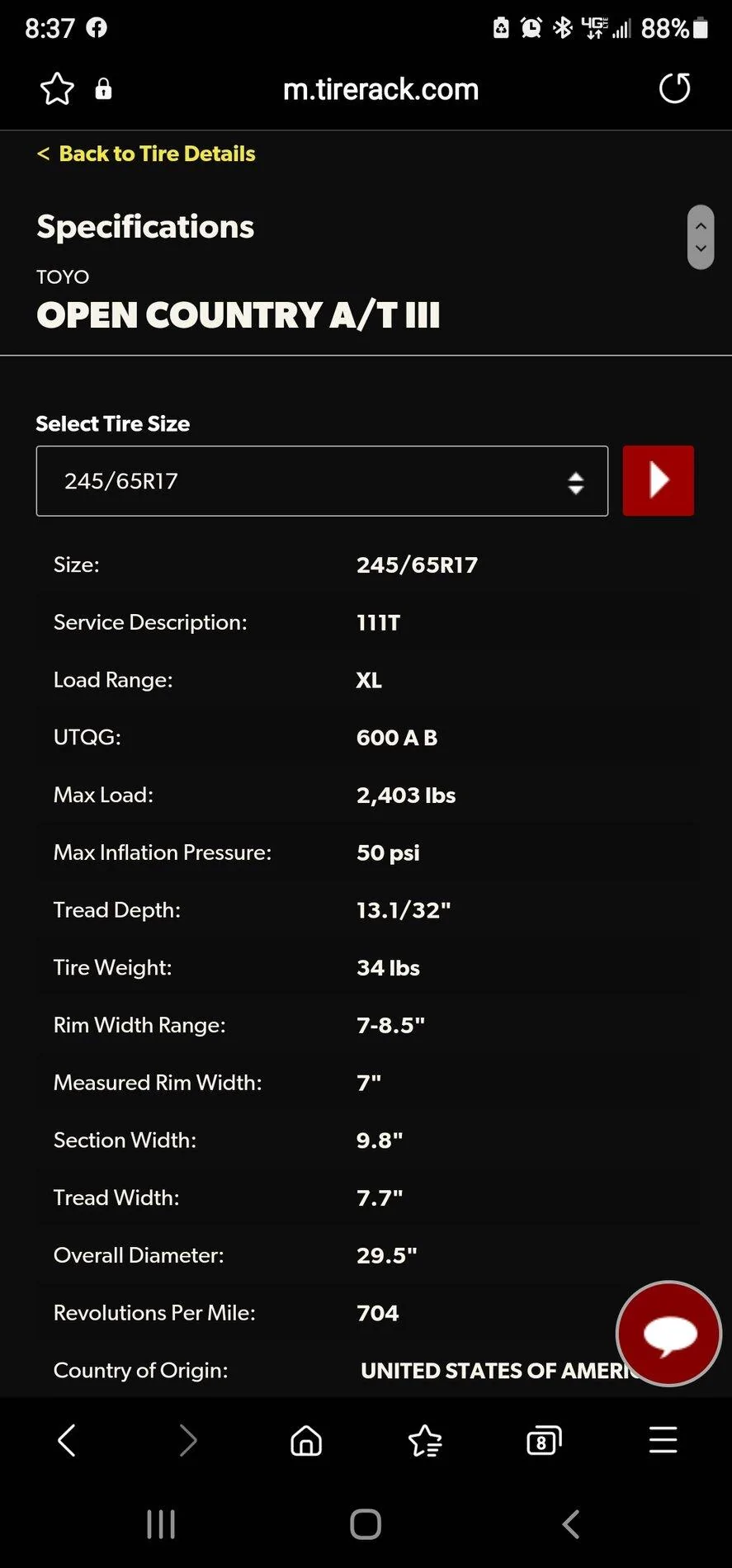

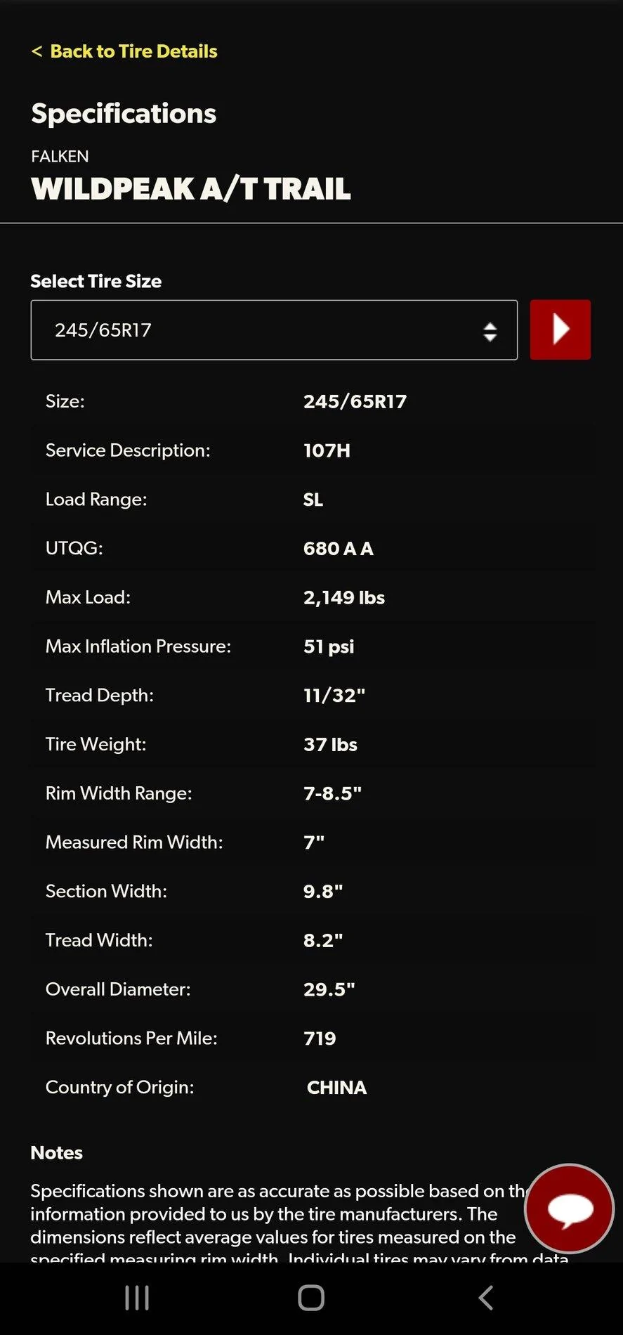

I couldn't find then in that size but if you can l cool. I'm gonna share the specs on the toyos and wild peaks at 245
Ford Maverick Lariat Ground Clearance 1" higher? Screenshot_20211028-083721_Samsung Internet
Ford Maverick Lariat Ground Clearance 1" higher? Screenshot_20211028-084207_Samsung Internet

I went with the wild peaks trail at for ya so it was closer to the bfg trails
