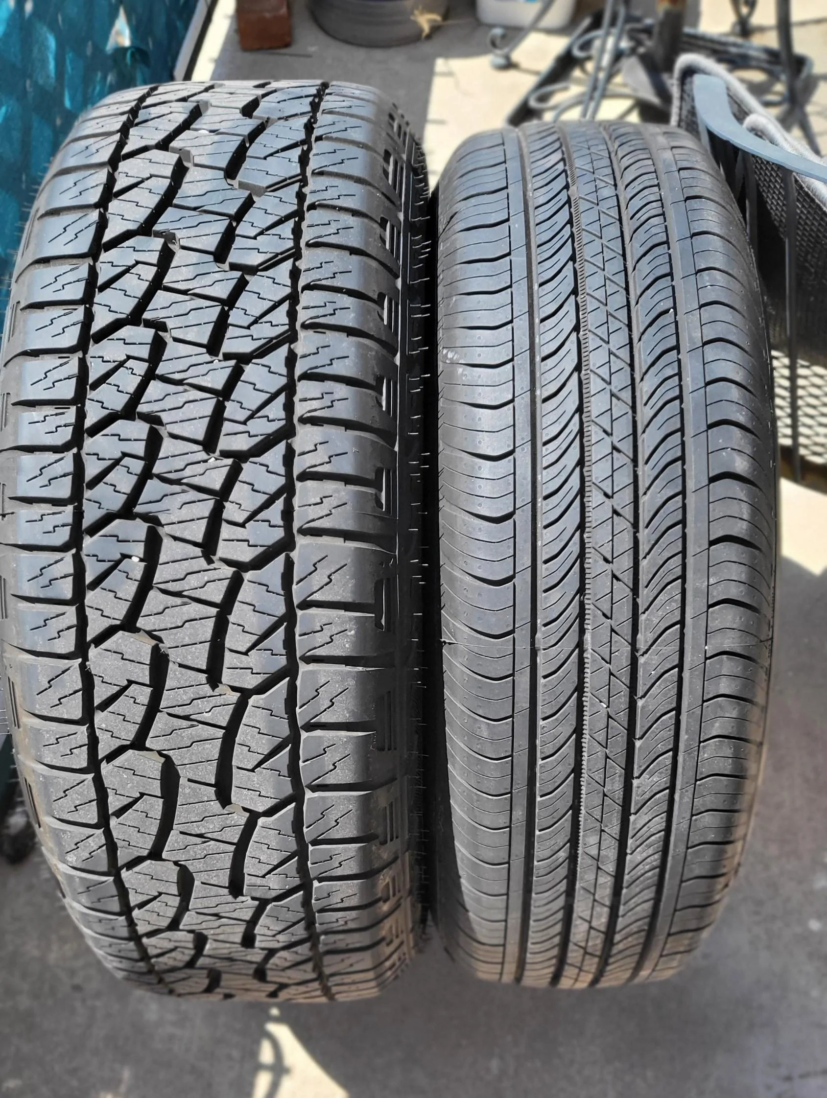

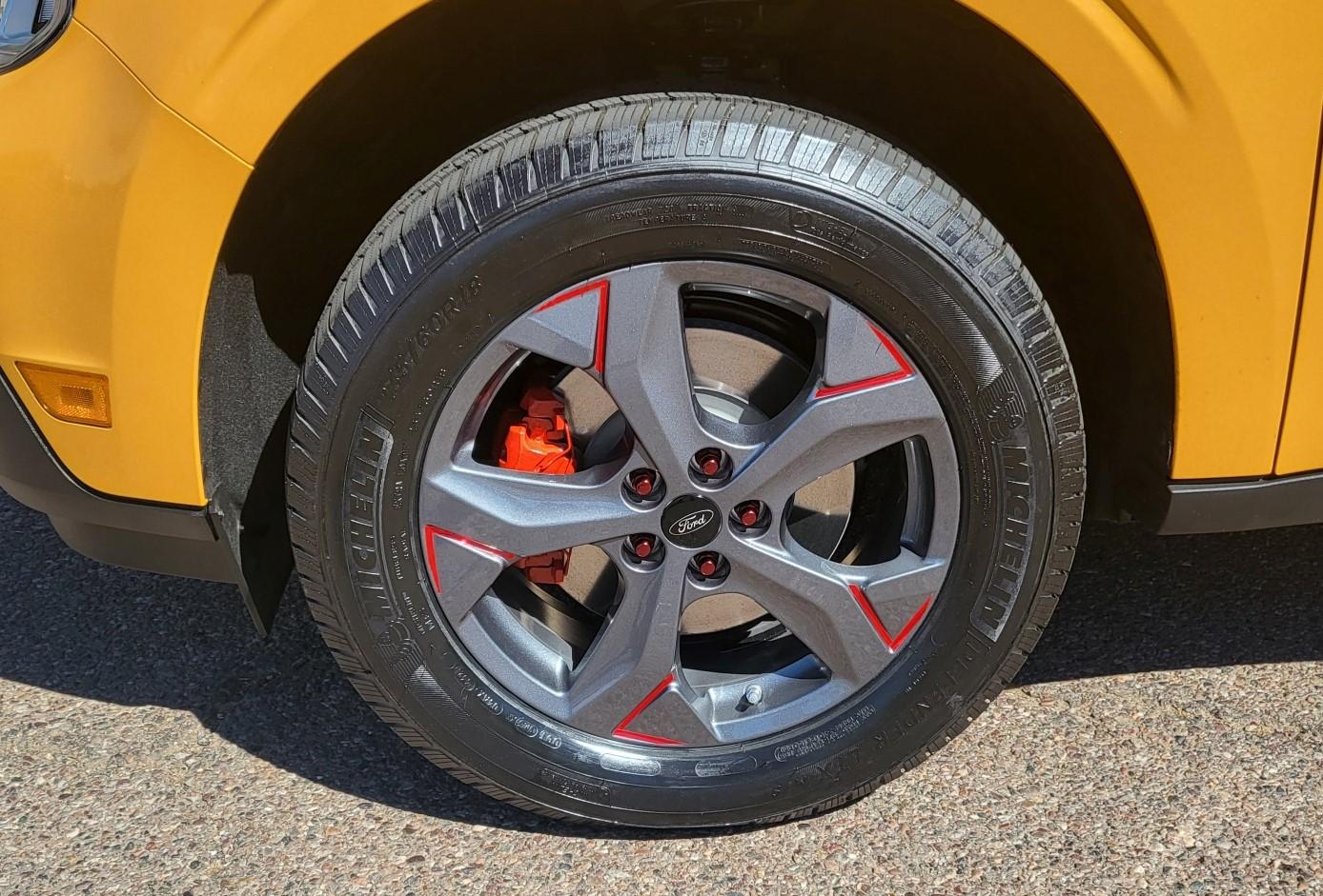

These were 18x8 Bronze wheels (et 40) with 265/60/18 (no rubbing on stock suspension)
The Mach-E wheels are 18x7 (et 47.5) with 235/60/18
No rubbing on stock suspension? These will add 1" in height plus about 3/4" in width, correct?
Correct! if you are talking about the Bronze set
