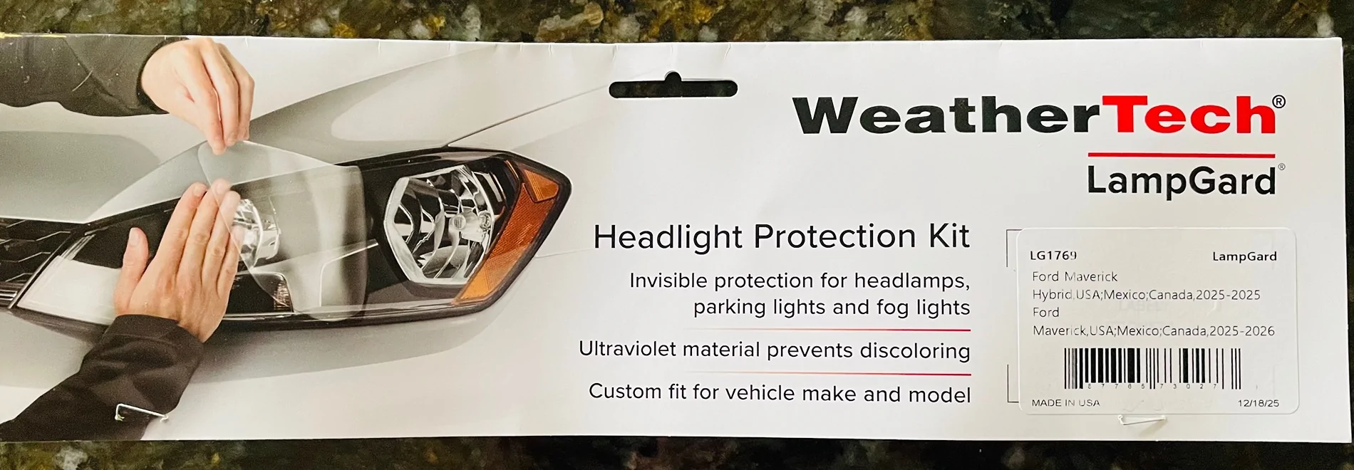

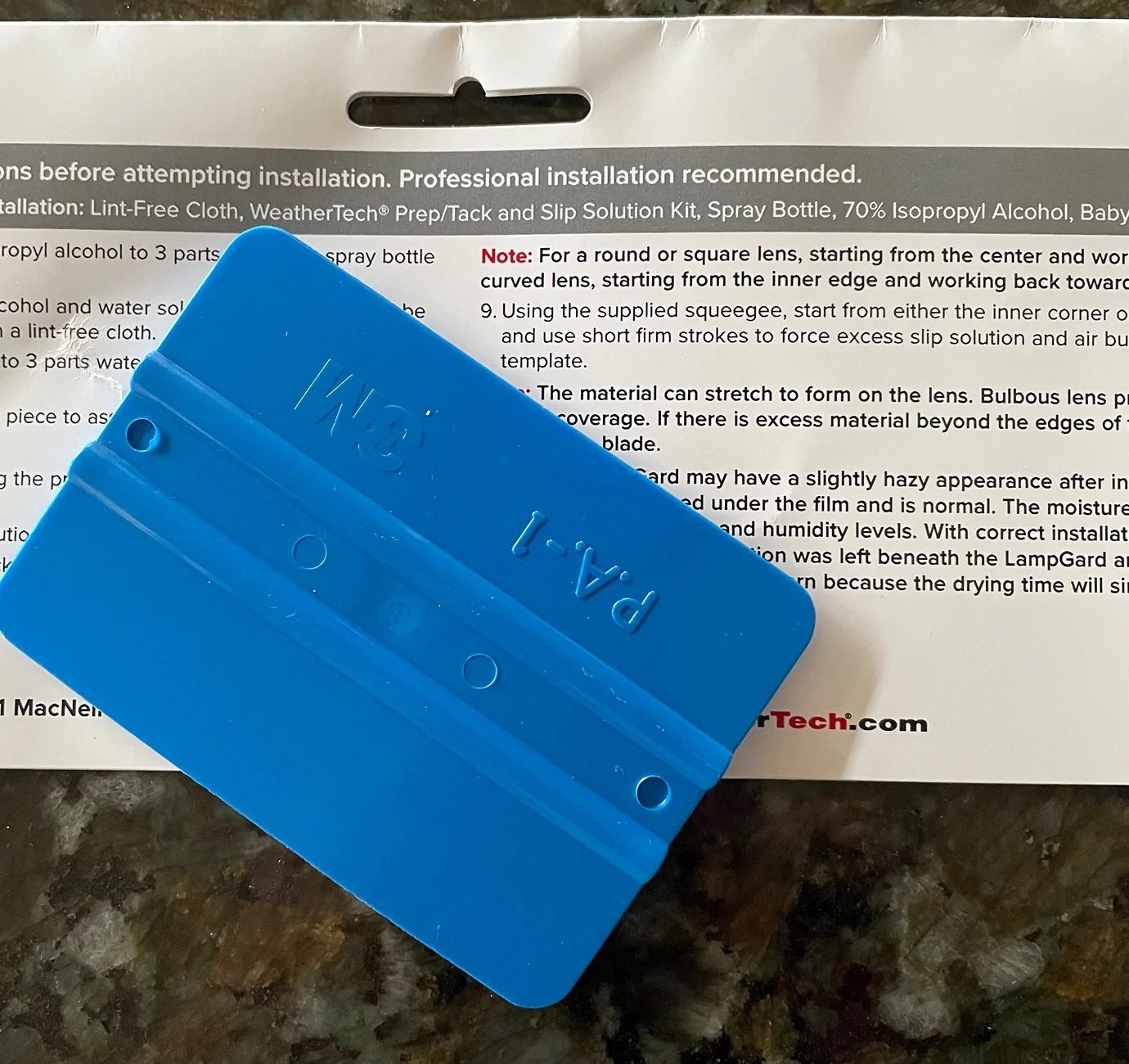

Apparently the 2025 Lariat headlight is a pretty pricey part so I purchased the WeatherTech films to try and protect them. As I was reading the instructions I noticed it says that professional installation is recommended! I tried to install them myself but the last compound curve defeated me. I ended up having a car wrap/ tint place put a new set on with no problems at all. They cut up the old set and made door handle protectors, including the tailgate, so all was not lost. I watched the install and they used a heat gun and hot water spray to defeat the curves. They also said a softer squeegee would be helpful. Looks great but only time will tell.
