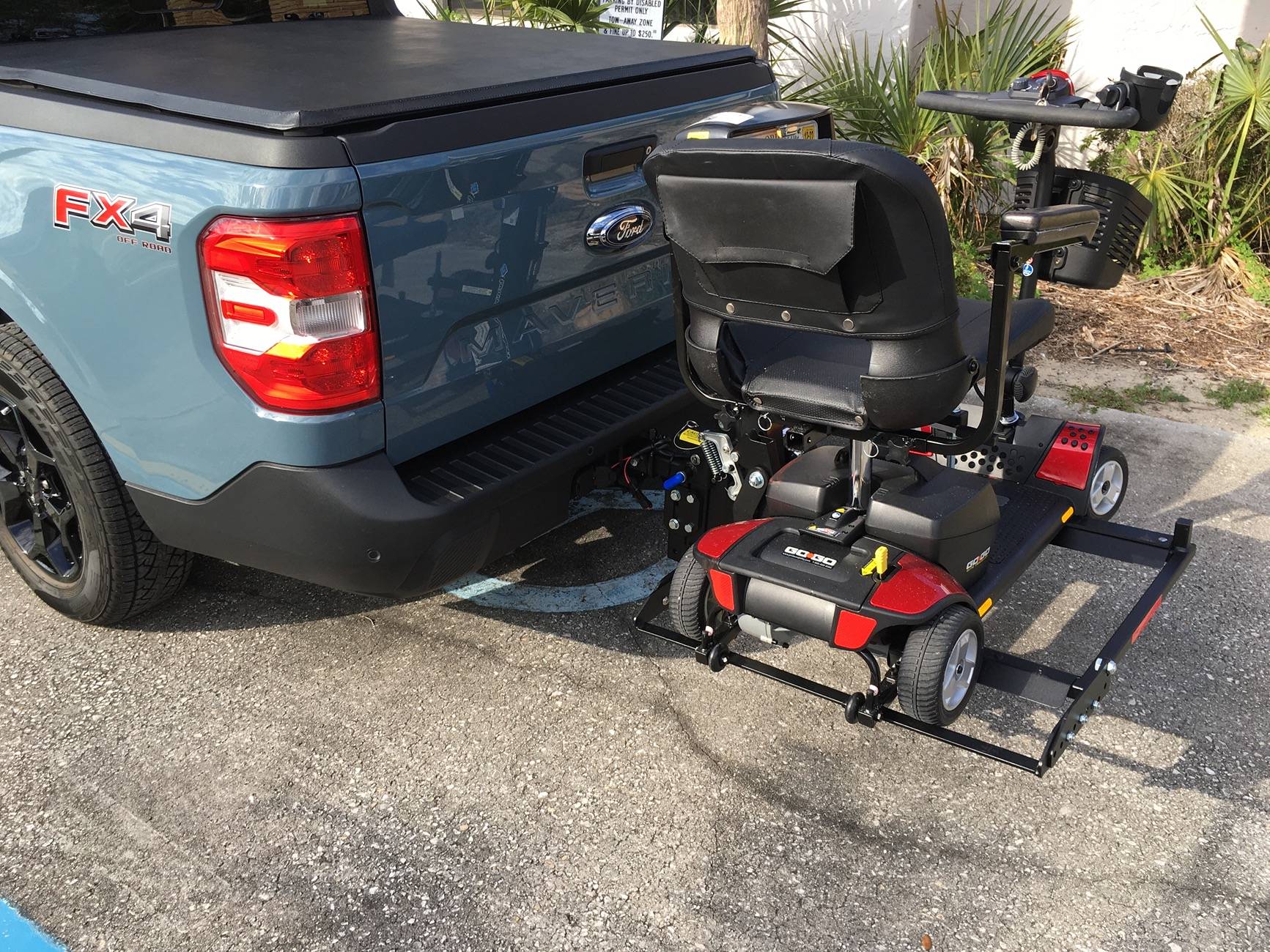

I always have the engine running when I use mine. Getting ready now to load up my Wife’s scooter for a trip to Legoland.
Looks nice? We got a Legoland not far from me in NY. May be worth the trip

We always take the scooter when we go to Legoland! My Wife has two bad knees and it’s about a mile walk to get from the parking lot to the Water park which is where we like to hang out during the summer months!!
