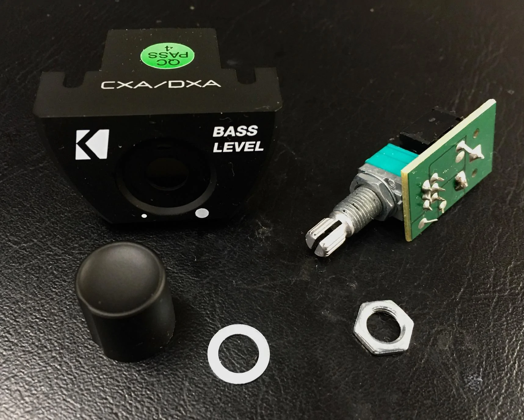

After looking around the dash and test fitting the Kicker Remote Bass Level Knob in several places, I decided it would look best in the dash. Inconspicuous and easy to reach, I mounted it in the location shown below:
Ford Maverick In dash Kicker Remote Bass Level Knob mounting 1 Knob Assy
1. Knob assembly (removed from bracket)

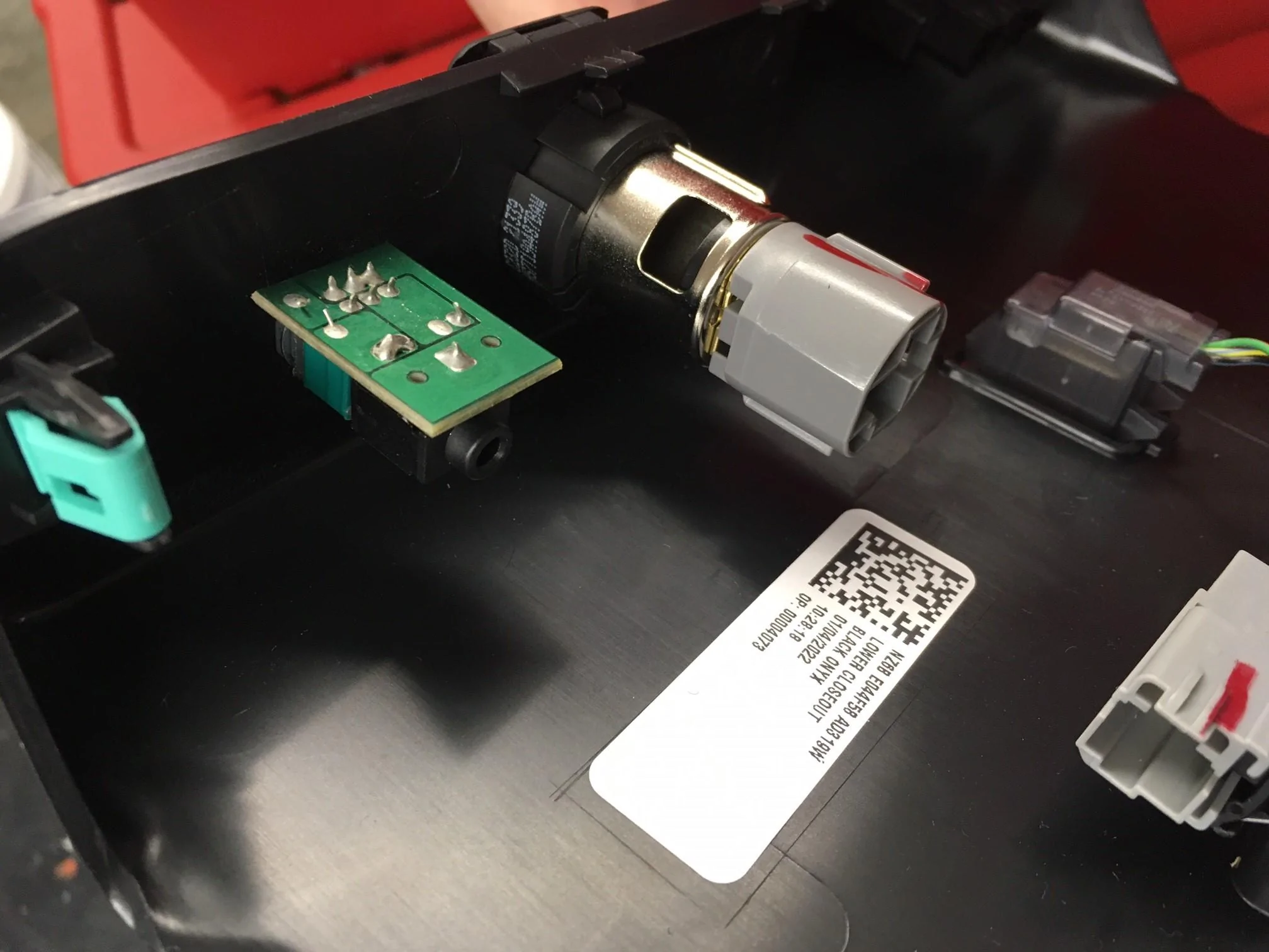

Ford Maverick In dash Kicker Remote Bass Level Knob mounting 2 Mounted Rear
2. Knob mounted (rear view) 9/32 drill bit was perfect size for potentiometer mounting hole

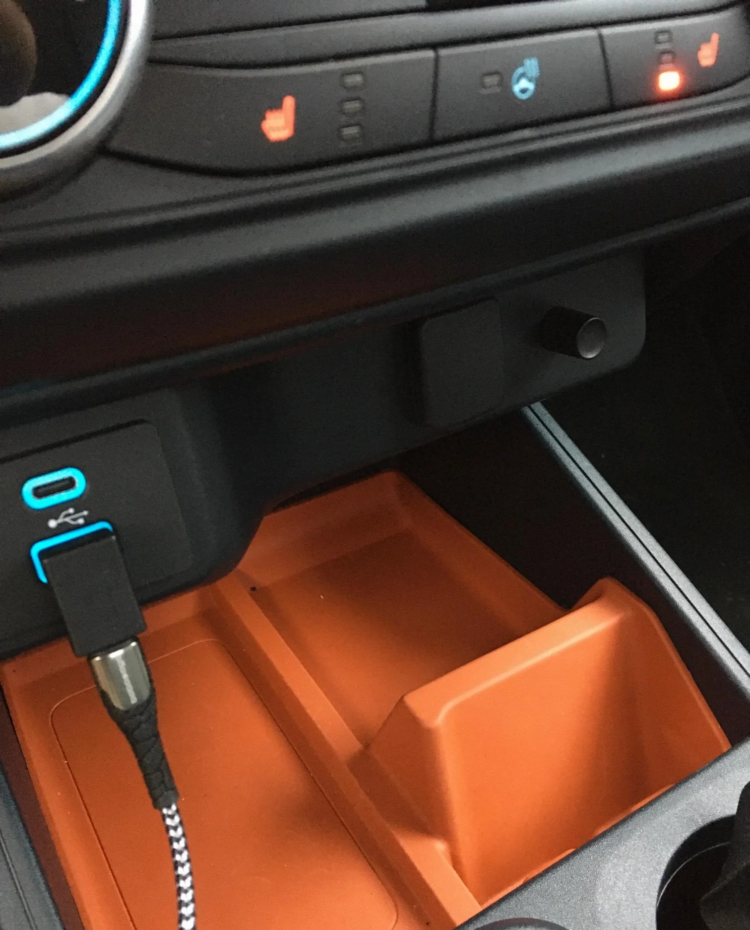

Ford Maverick In dash Kicker Remote Bass Level Knob mounting 4 Installed
3. Front view (out of the way and looks like it was meant to be there)
Nice to have it there too. Per Kicker's whitepaper, I set the Bass Knob at 75%, the Mav's volume at 23 (~75%) and turned the HS-10's gain up until I heard some light distortion and backed it off a click or two. That worked well and provides the adjustability for various artist/genres.

After looking around the dash and test fitting the Kicker Remote Bass Level Knob in several places, I decided it would look best in the dash. Inconspicuous and easy to reach...
It does like a factory install and looks very nice. Good work. :cool:
