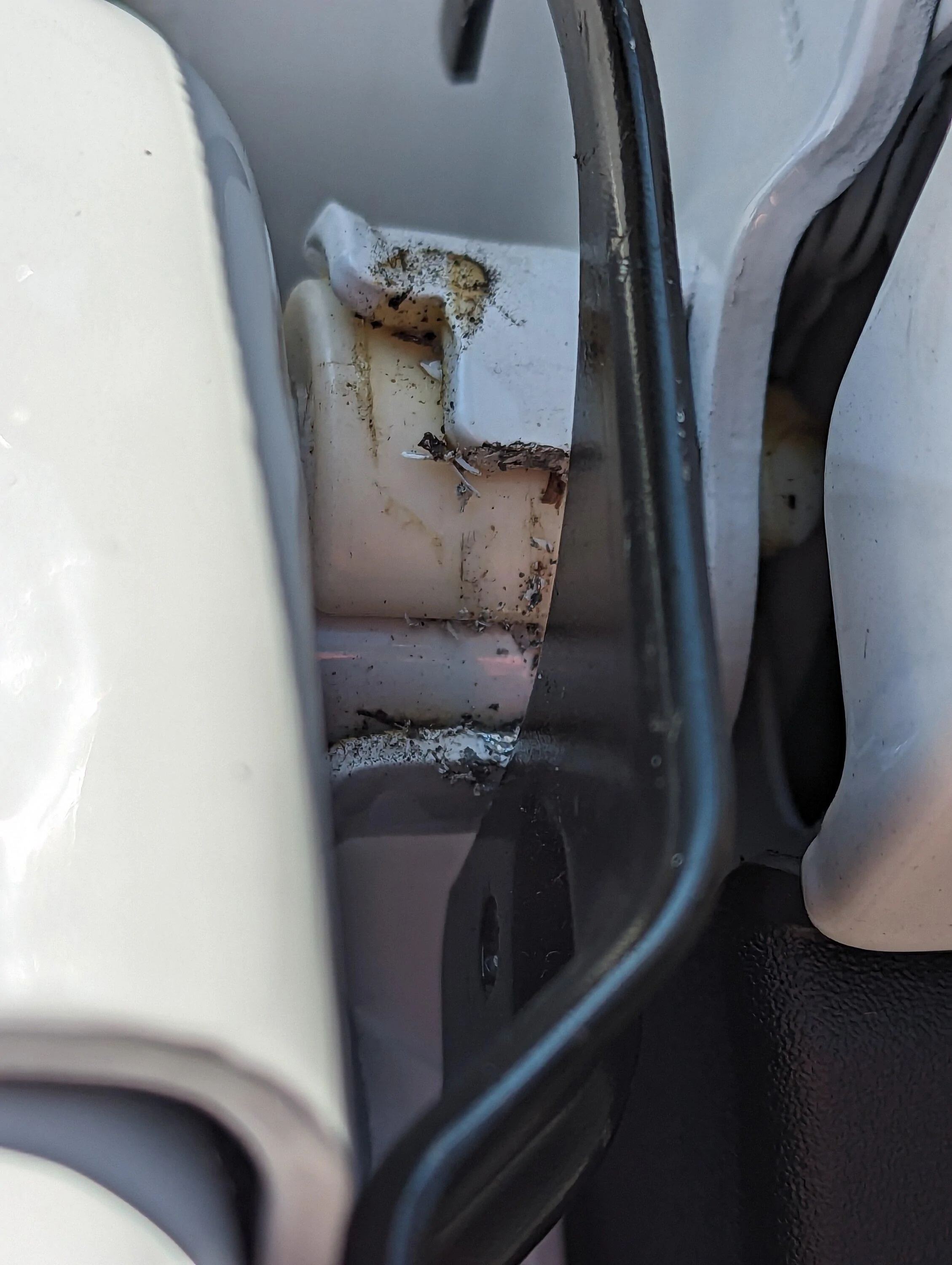

Welp, I just tried to close the tailgate without realizing that one of my ratchet straps fell down into the gap. Thankfully I didn't put a ton of force behind it, but it scratched up the paint and afterwards I found the bed didn't want to close until I shifted it a little forward back into its hinge. The right side hinge looks like part of it might have busted off of it, but I can't find a broken off part on the ground anywhere. Could one of y'all do me a favor and post a picture of your passenger side bed hinge so I can see if there's a piece missing on mine?
Ford Maverick I think I might have busted a bed hinge PXL_20230901_203828084

I don't think anything broke off, should just need FL3Z83430B38C roller, retails for $11.60 but would need to be painted, comes in black. You may need FL3Z99430B22A white plastic insert as well, retails for $7.07
