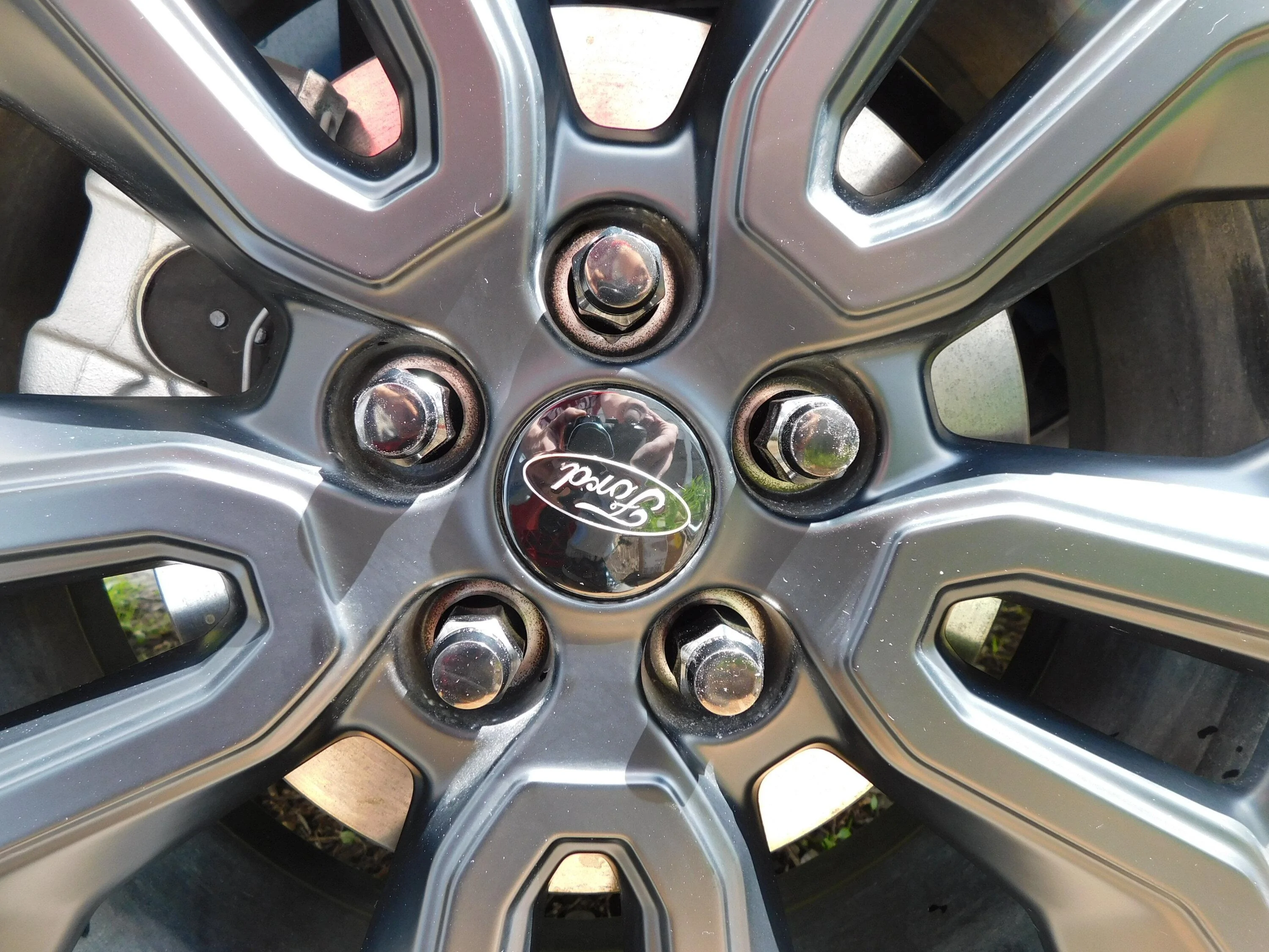

I replaced the two piece stock lug nuts with one piece black lug nuts.

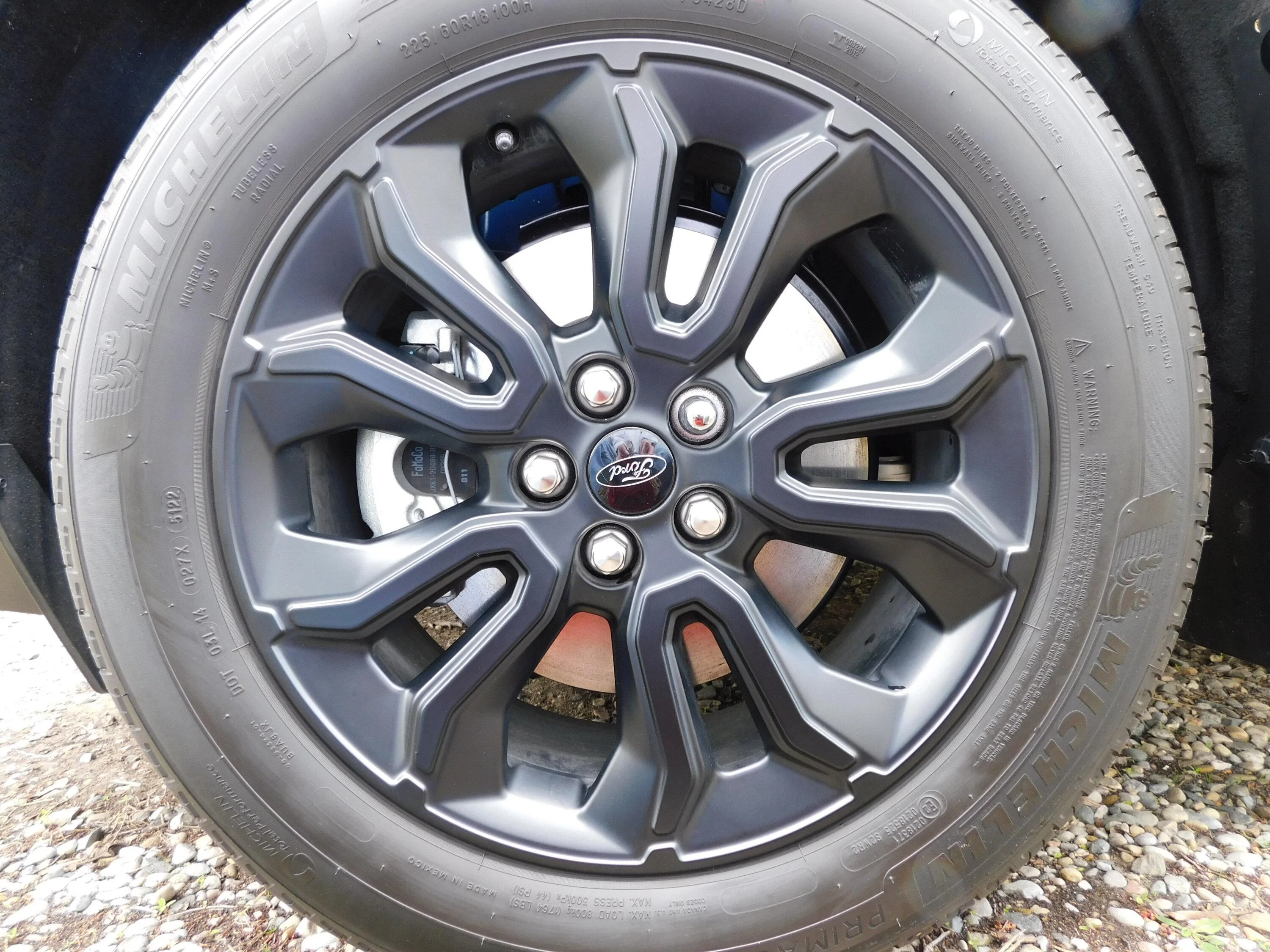

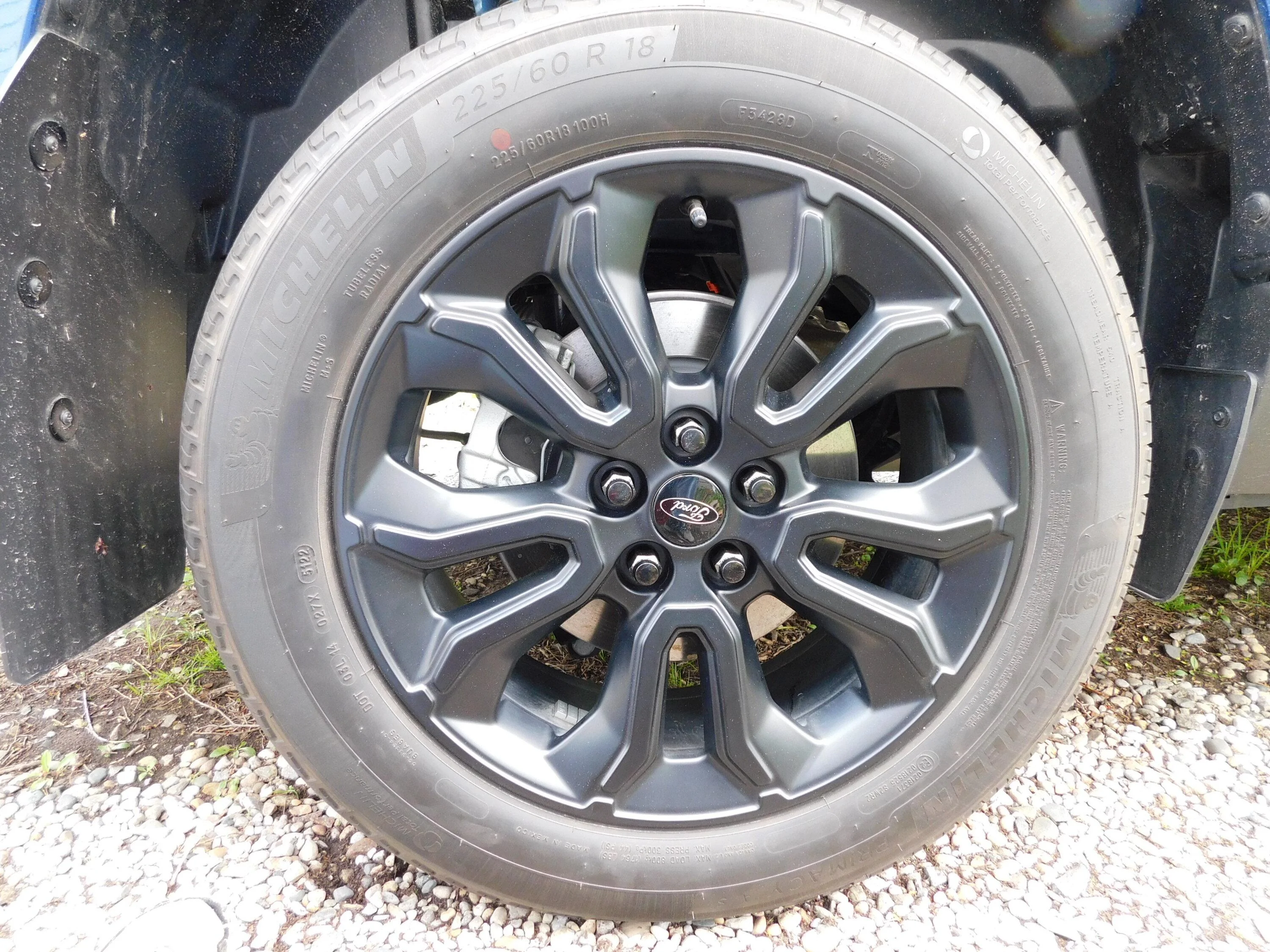

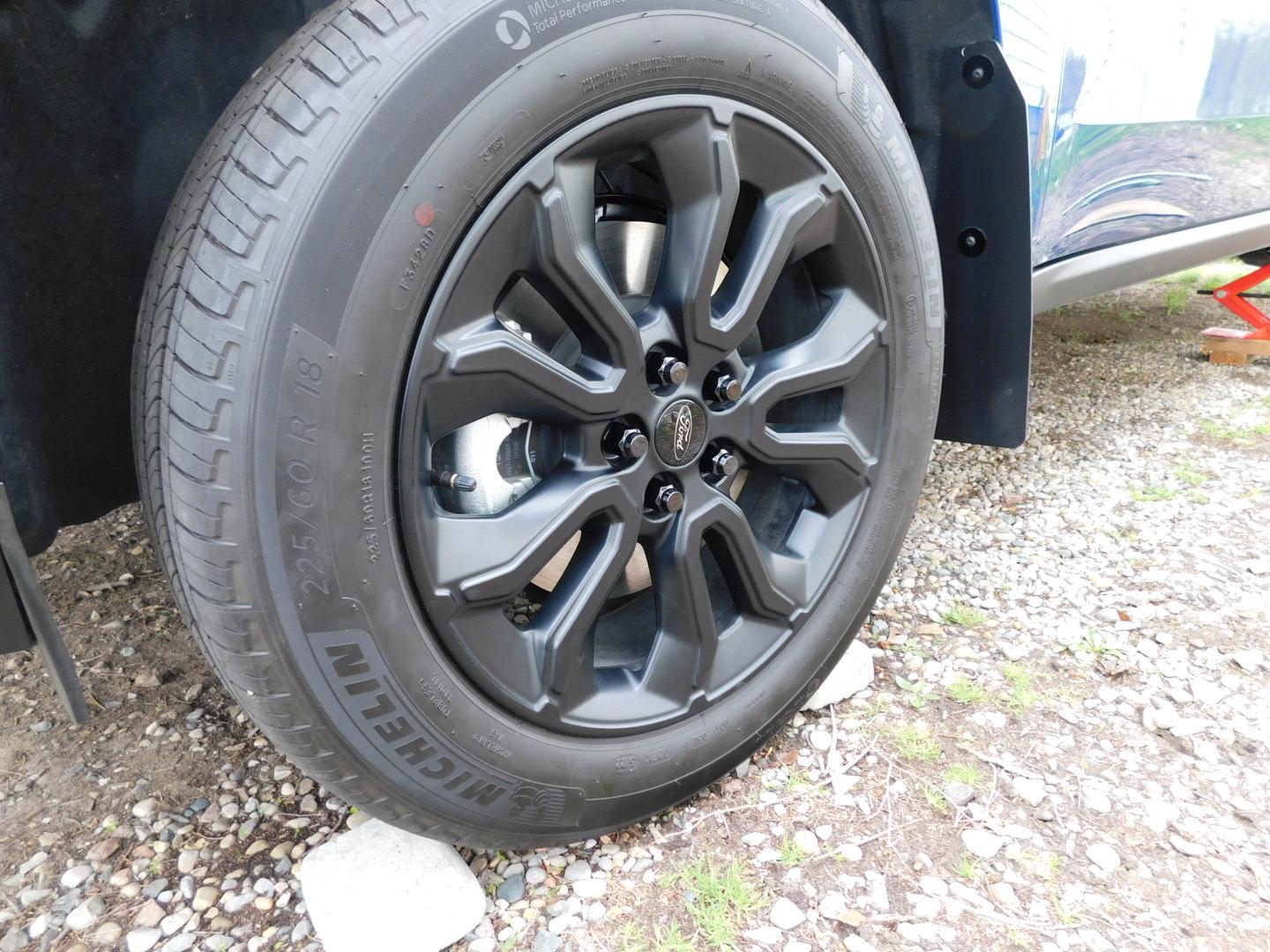

Living in the rust belt, I didn't want to deal with the stock lug nuts expanding due to rust, so I replaced them. I noticed the rims on the BAP were not painted around the seating area of the rim for the lug nuts. I wanted the rims to be fully back so I bought flat black barbeque paint and painted the silver parts of the rim, taking care not to paint the taper area where the lugs seat. I used a funnel to avoid painting any part of the rim that is black already.
I think it came out pretty well.

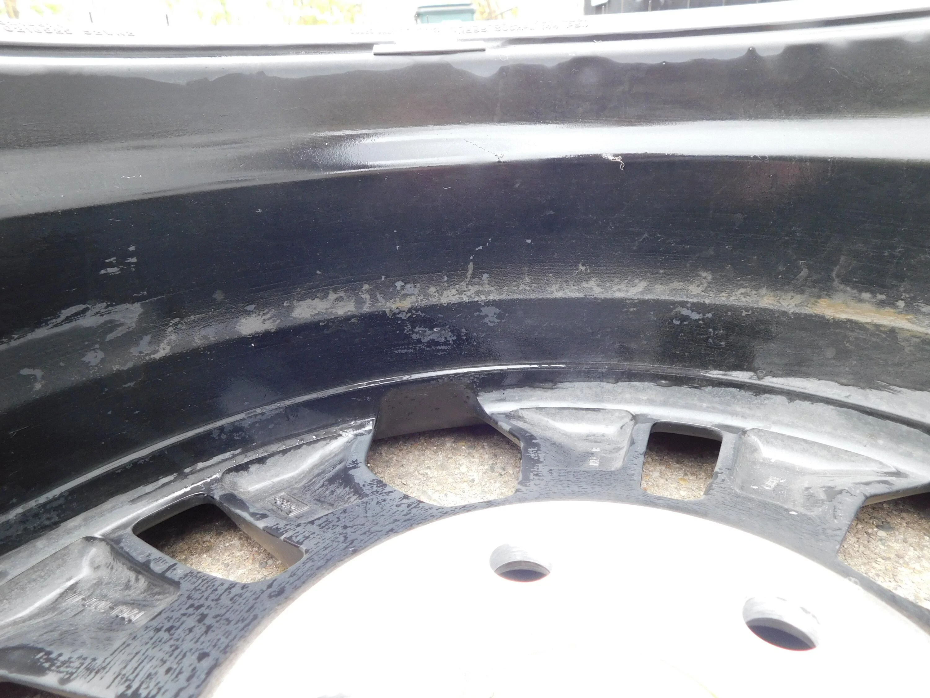

I also included a picture of the inside of one of the rims that was pretty rough, it looks like it got scratched or something.
Ford Maverick I replaced the two piece stock lug nuts with one piece black lug nuts. before lugs

Ford Maverick I replaced the two piece stock lug nuts with one piece black lug nuts. after lugs

Ford Maverick I replaced the two piece stock lug nuts with one piece black lug nuts. after close.JPG
Ford Maverick I replaced the two piece stock lug nuts with one piece black lug nuts. final close.JPG
Ford Maverick I replaced the two piece stock lug nuts with one piece black lug nuts. rim2
