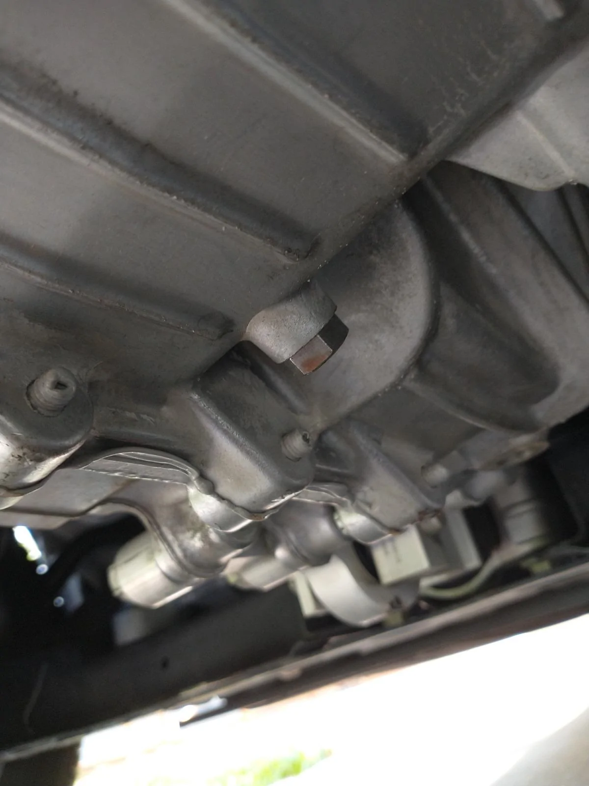

Had a slow leaking noticed at 35,000 on the transmission that resulted in a loss of a half a quart of trans fluid. Initially I thought it was the drain plug that had not been tightened from the factory. Did a fluid change and of course tightened the drain plug.
Checked again at 40,000 and it was still wet at the bottom and no where else. Took it to the dealer and had them look and they scheduled me in for 3 weeks ahead. Lost another quarter of quart in 5,000 miles

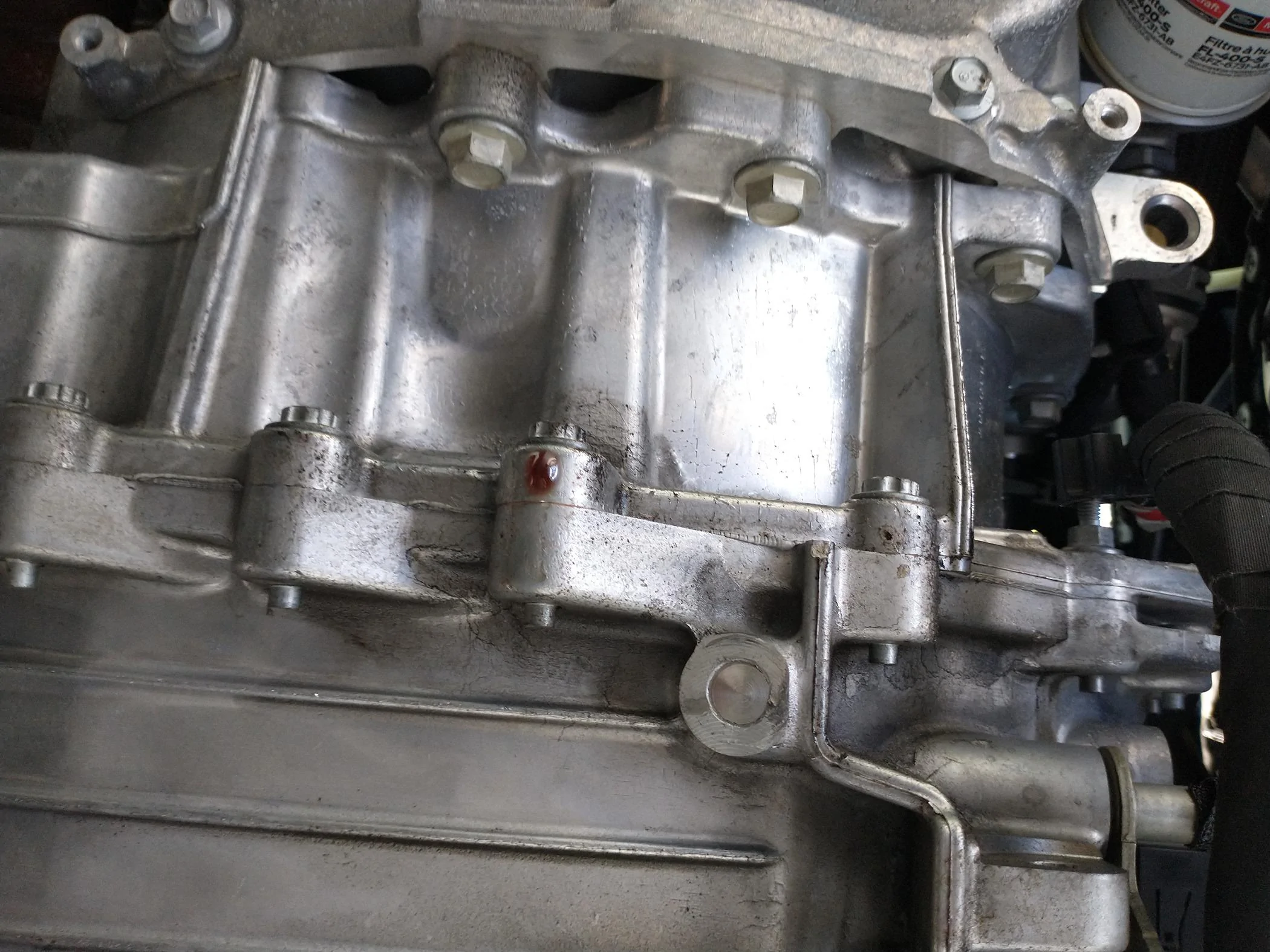

Dealer has it for a few days, tried re- silicone the bolts and it was just speeding up the leak that now was seen as being right on the part line of the two halves, which is supposedly robot's silicone at the factory. Approval came from above to split the trans and re-silicone. To do this is a 10 hour, $2300 job where the engine and trans get dropped as a unit, repair and reinstall.

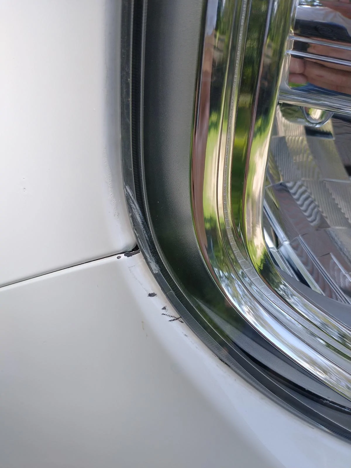

Noticed right away it was out of alignment which I verified by just getting out and looking at what direction the tires were pointing. While looking I also start seeing all the paint scratches on the bumper and fender.

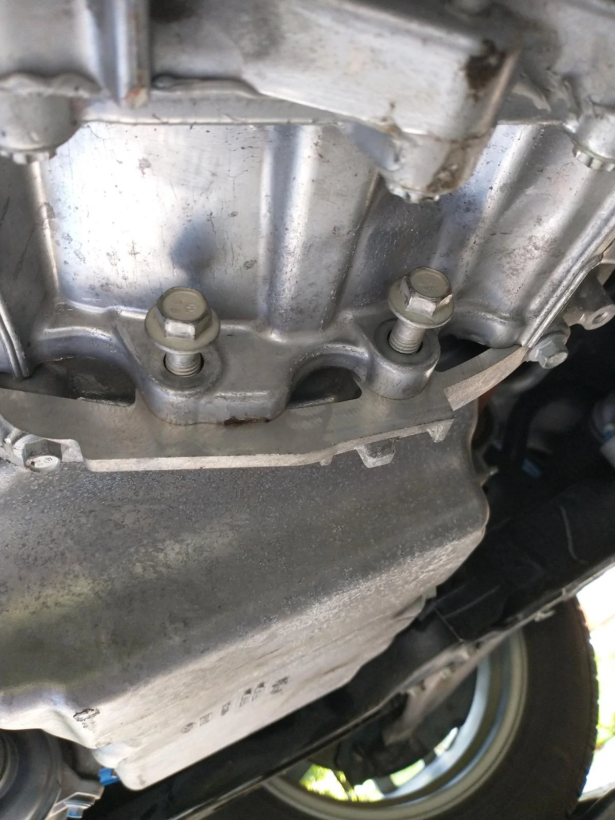

First one of the screws on the bottom cover is just jammed at the wrong angle. They just left it that way. Once I get the cover off I find they did not tighten the bolts from the trans to engine which is so obvious. How would you miss that.

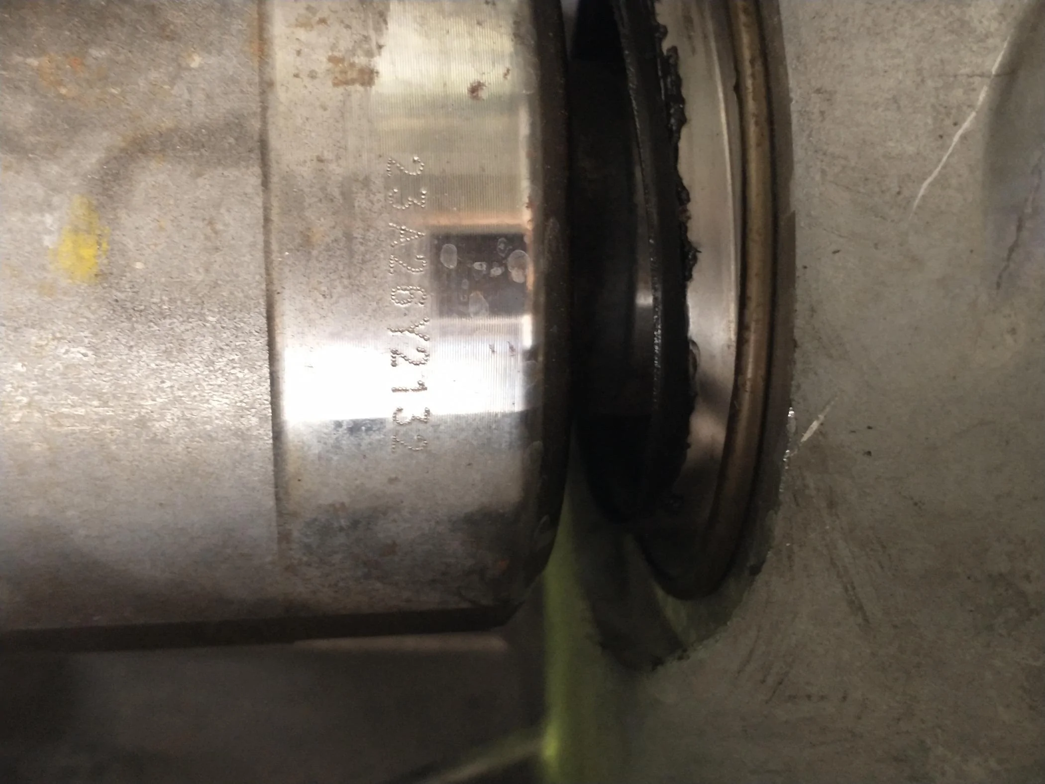

Next I see the drain is dripping trans fluid. Then I find that one of the seals on the CV shaft is bent and crooked. They hit it with something while it was apart but did not care to make it right. Why on earth you would put it back together that way, I am totally amazed. It will wear it out but if I had not looked it would have lasted long enough for the warranty to expire.
I guess it was partly a good thing they did not align the tires as otherwise I would have bolts falling out and seals leaking a few months down the road.

They did finally tighten the engine to transmission bolts. But still waiting to hear if they are going to correct the bent seal and do an alignment. They did ask for my pictures I took. I suppose the are trying to get some sort of approval from above so Ford covers the cost to the dealer and the alignment was not on the original 10 hour repair order. Now the bent seal and slow leak drain plug may have to be replaced by me because I am not seeing much agreement on there part. They got copies of my pictures and we put it on the lift and I showed them the seal is bent and now crooked, but to them it's not leaking right now. So....I suppose they feel I am being to picky!

Just found out they are going to replace the bent seal. Will take a couple of days to get it. Maybe that is the reason, if they noticed it was bent, to put it all back together because it would have taken two extra days siting on a lift with engine and trans sitting on the floor. It appears that the drain plug washer is missing though....and there is no drain plug or washer shown in the Ford parts catalog for the eCVT. Will have to find a generic one for the plug to stop the drip.
