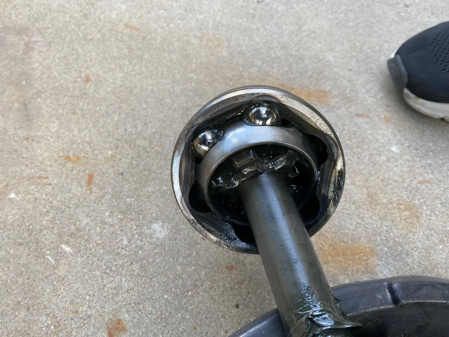

I had a spare set here that i offered up to anyone in san diego area to help put in to solidify my measurements .
No takers , so thats the ones i debooted for the pics . They are off to an aftermarket shop to see if i can get an improved tremor axle ( usual polishing of cage or swapped for cromoly or 300m parts and better aftermarket boots and grease )I would say yes all day , just order both sets for the replacements and full comparison on your old take outs will tell and send the unused pair back .

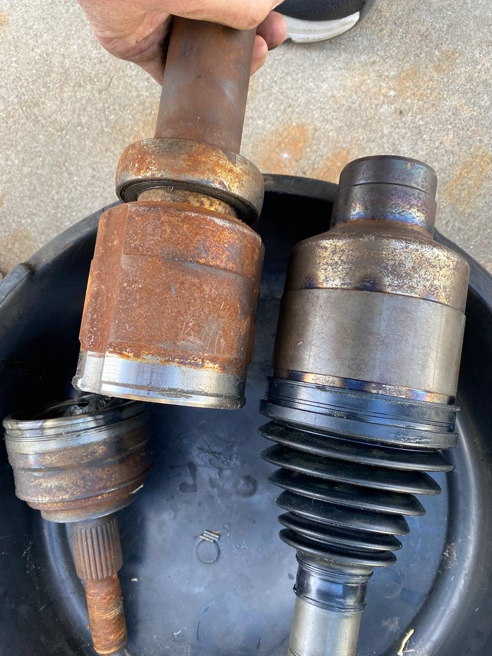

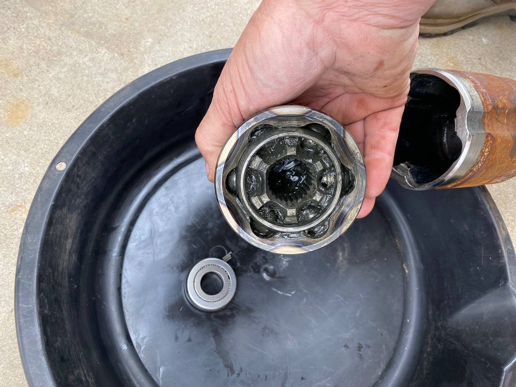

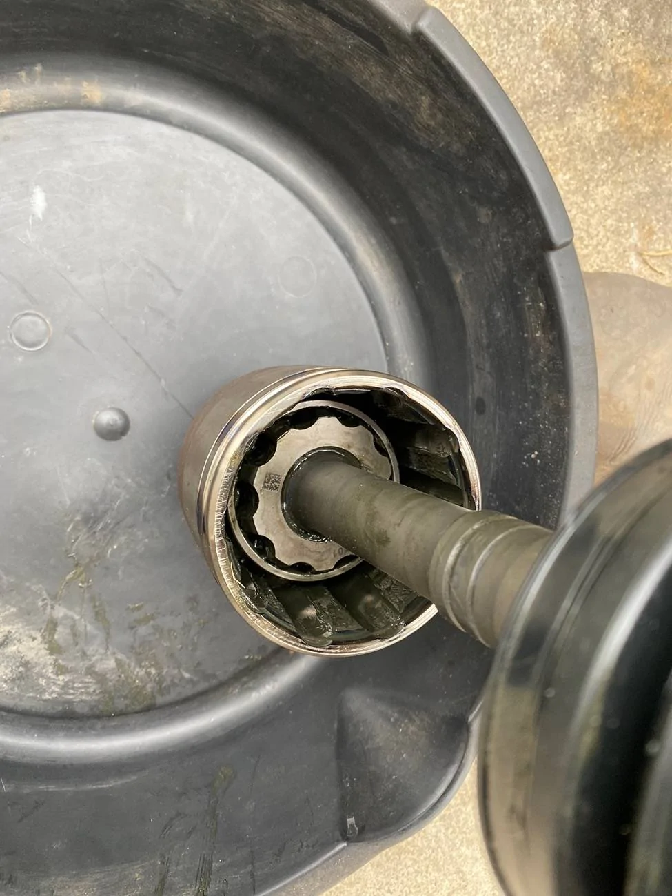

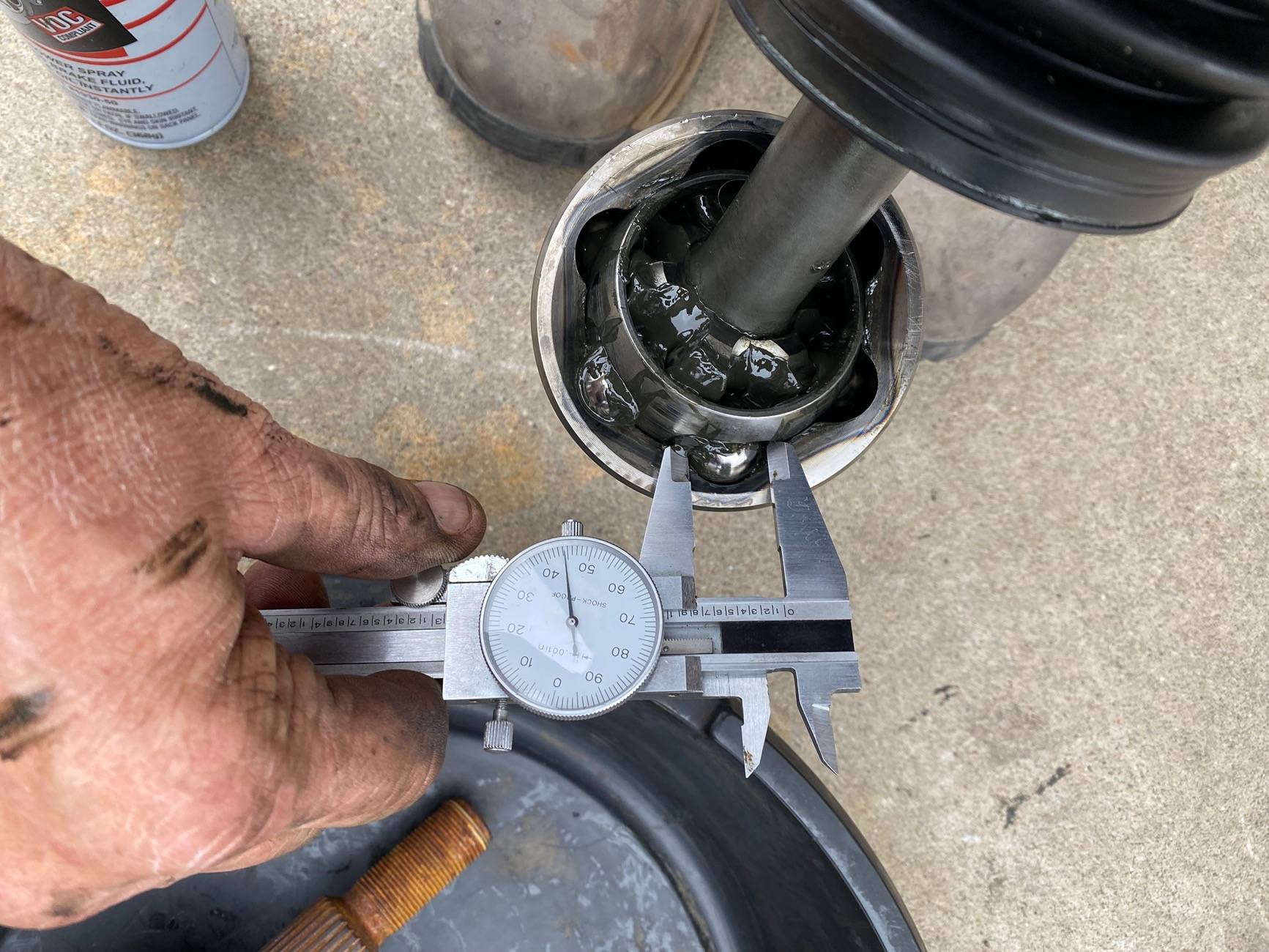

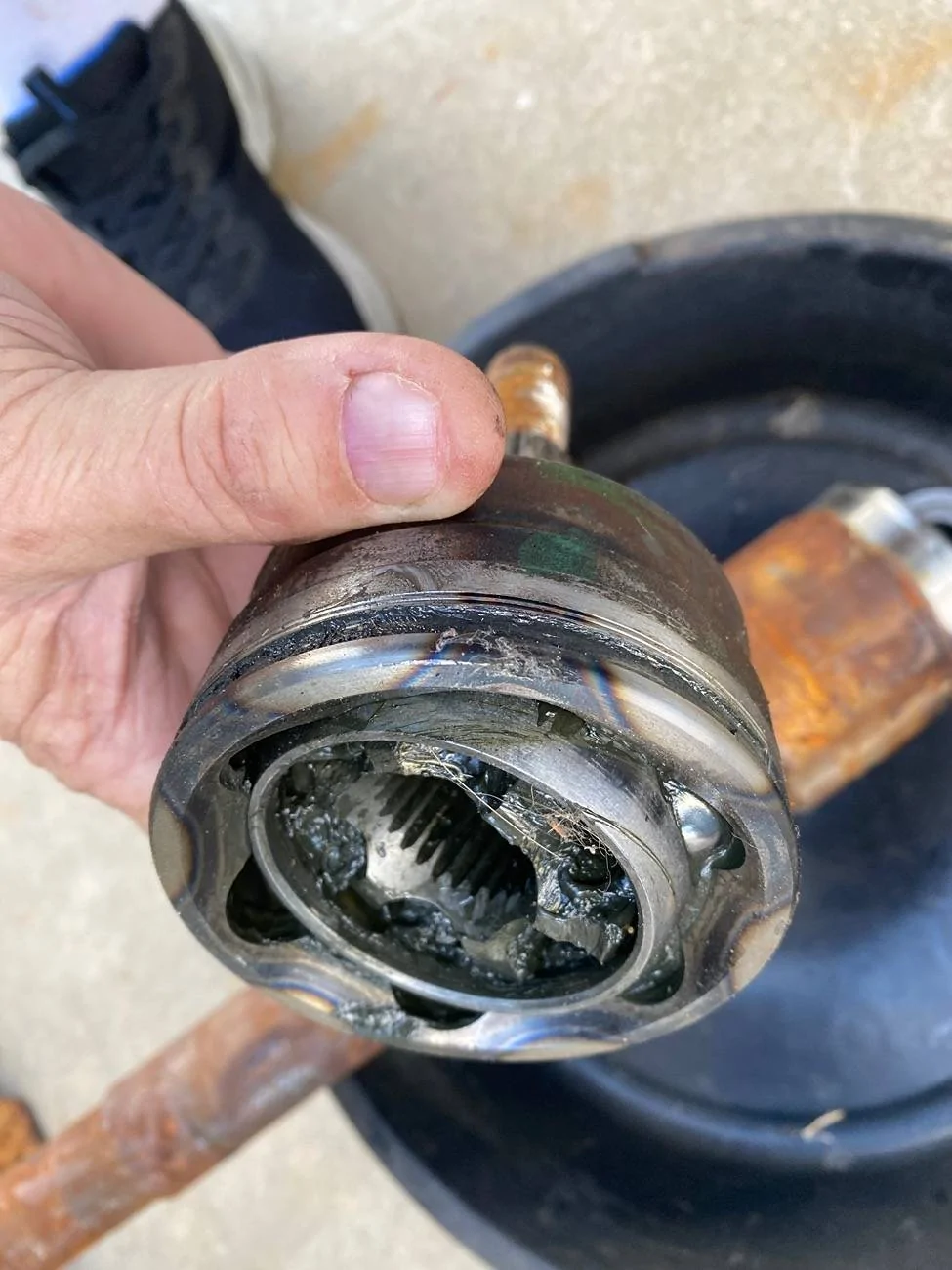

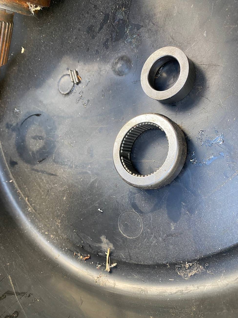

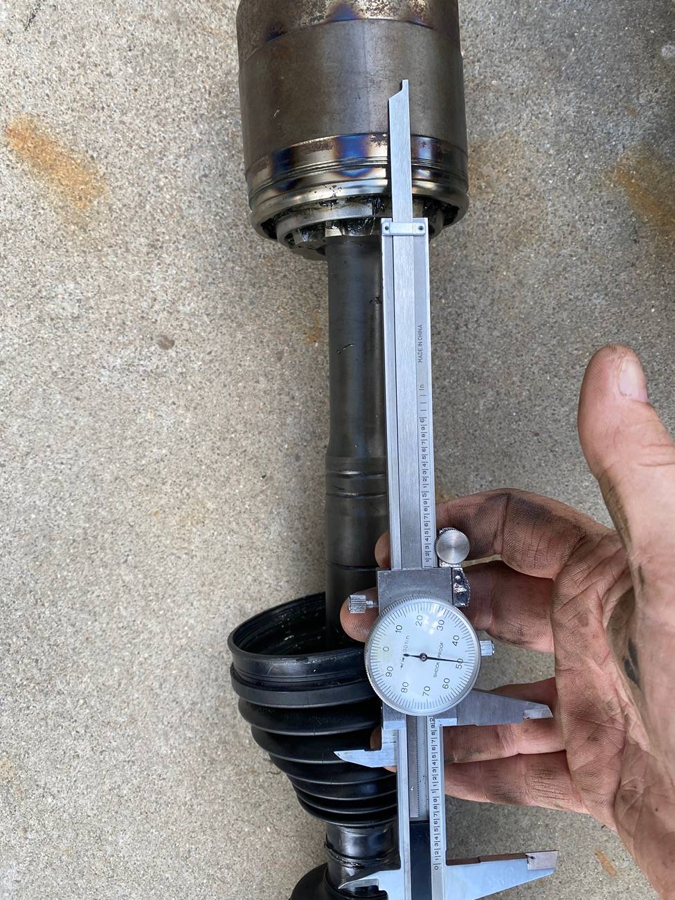

Thanks for sharing this. Now we have verification that our Tremors do in fact have different and stronger CV joints on the axles. Tremor axles are also a larger diameter between the inboard and outboard joints.
However, if I'm correct the actual splines on the ends of the shaft are the same. If that's the case then non Tremor owners worried about CV axle longevity can swap in the improved Tremor version.
More pics as I send off the tremor axles for modification and trash the broken hybrid one .

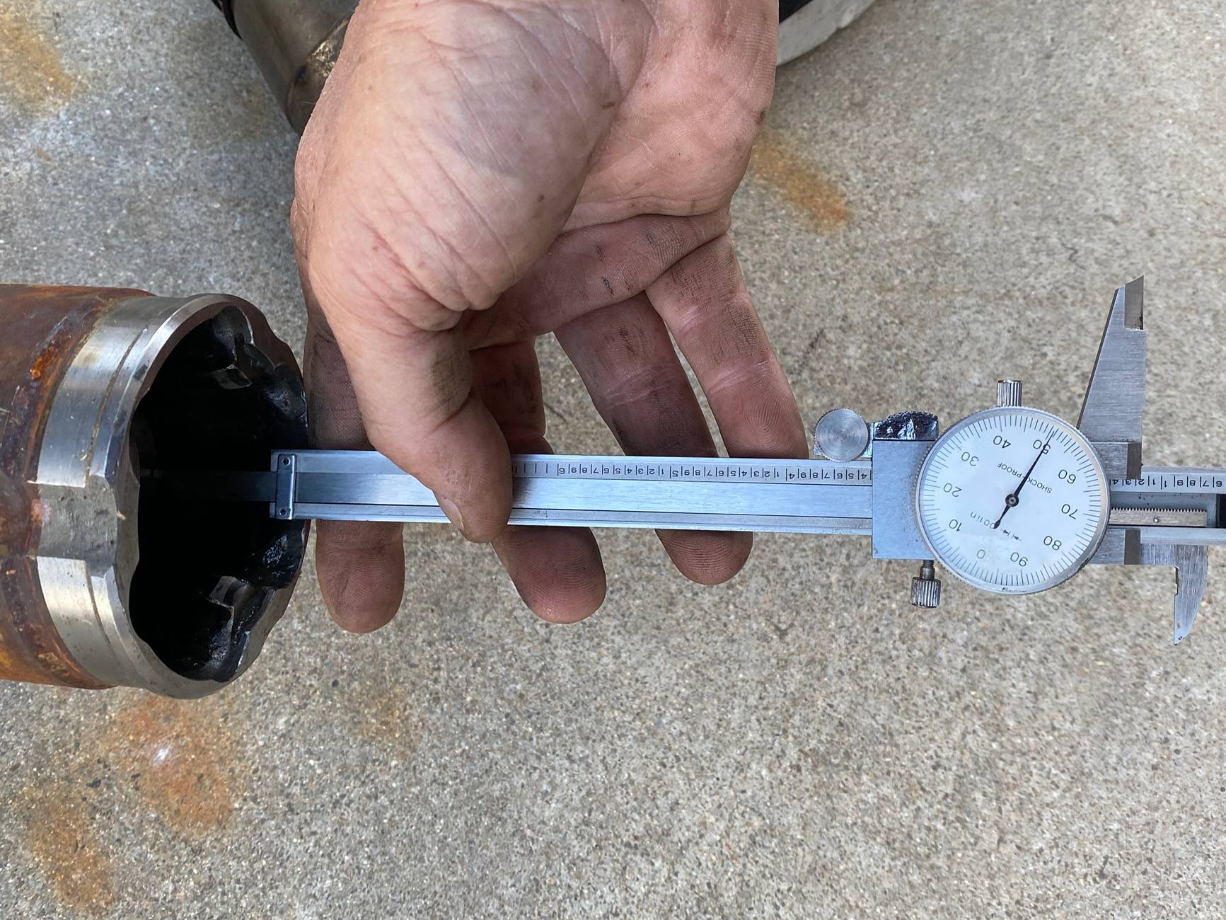

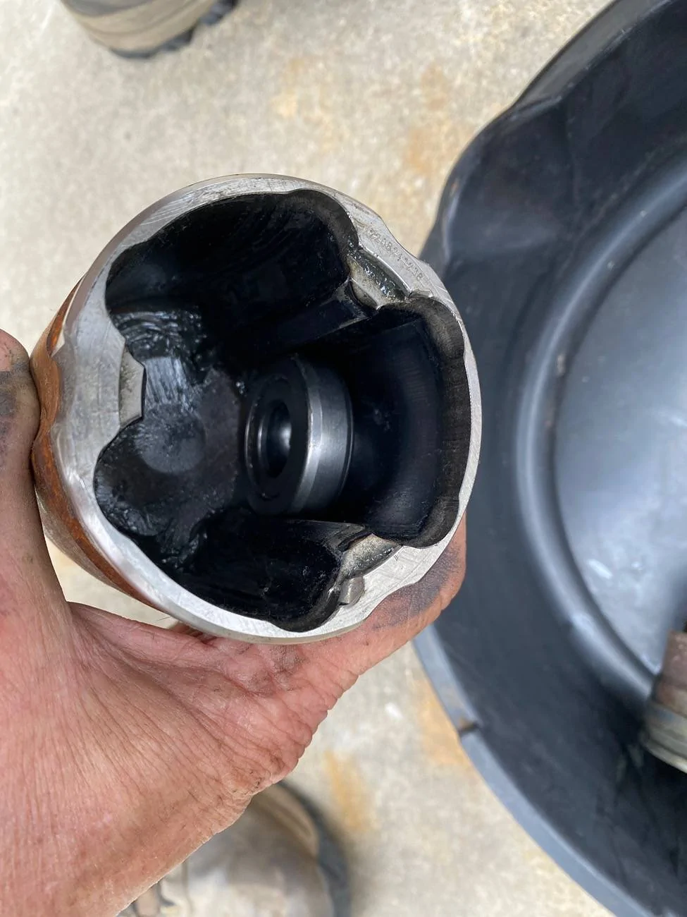

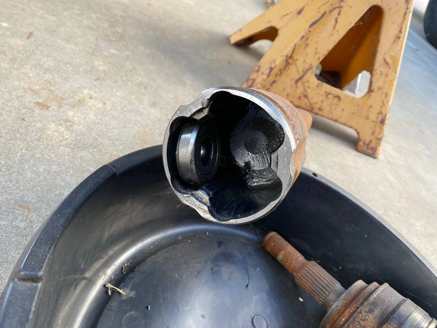

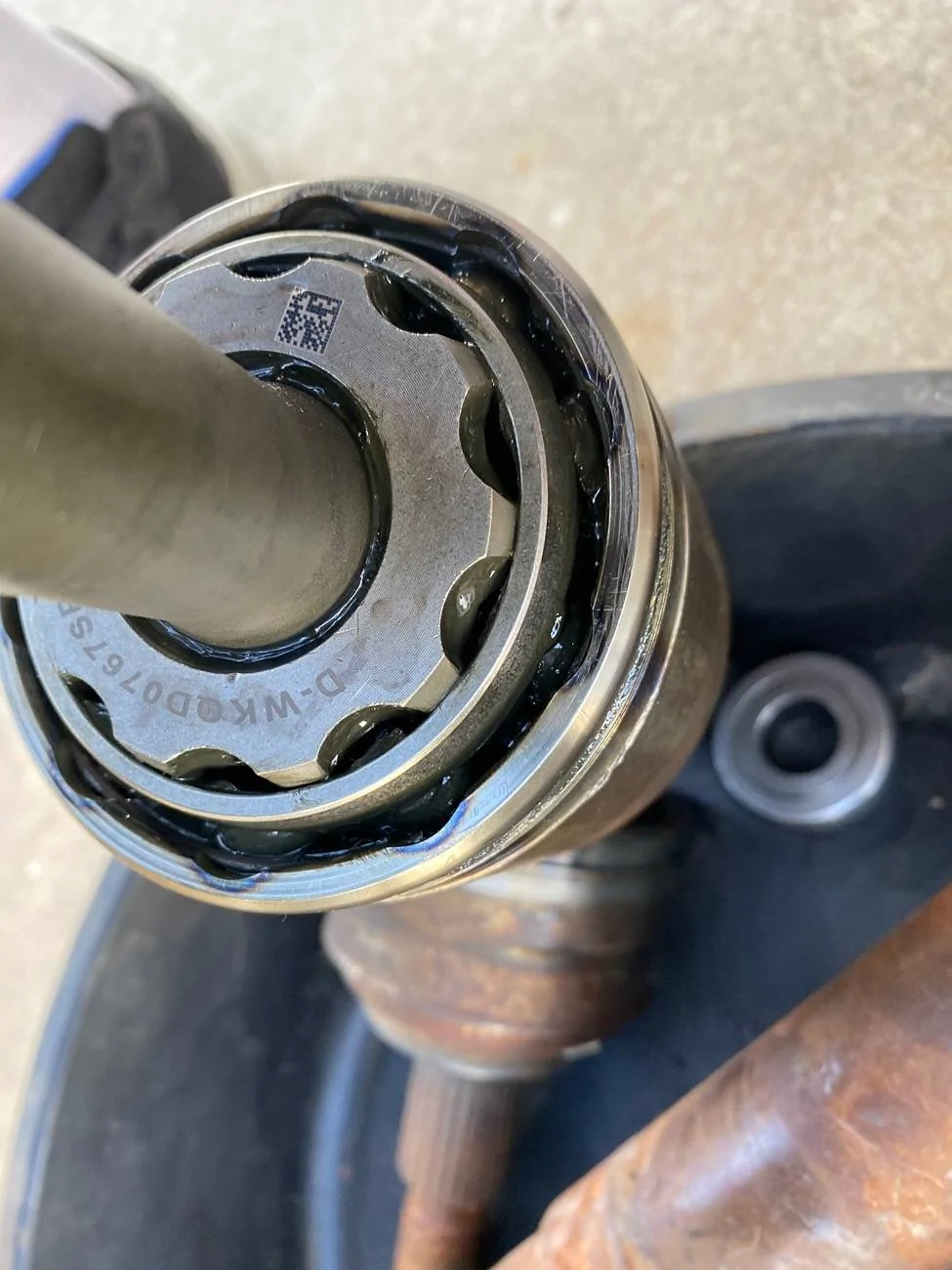

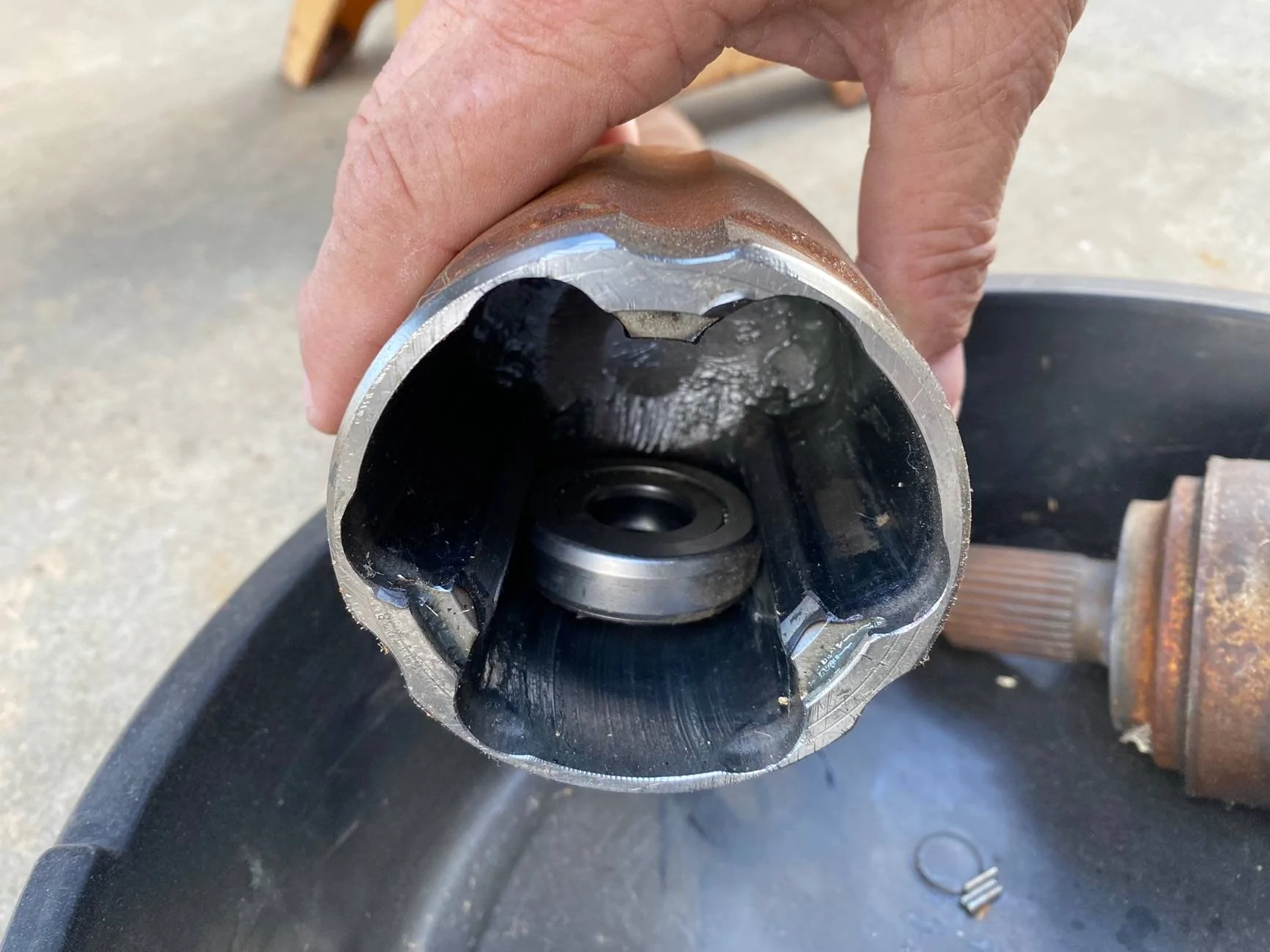

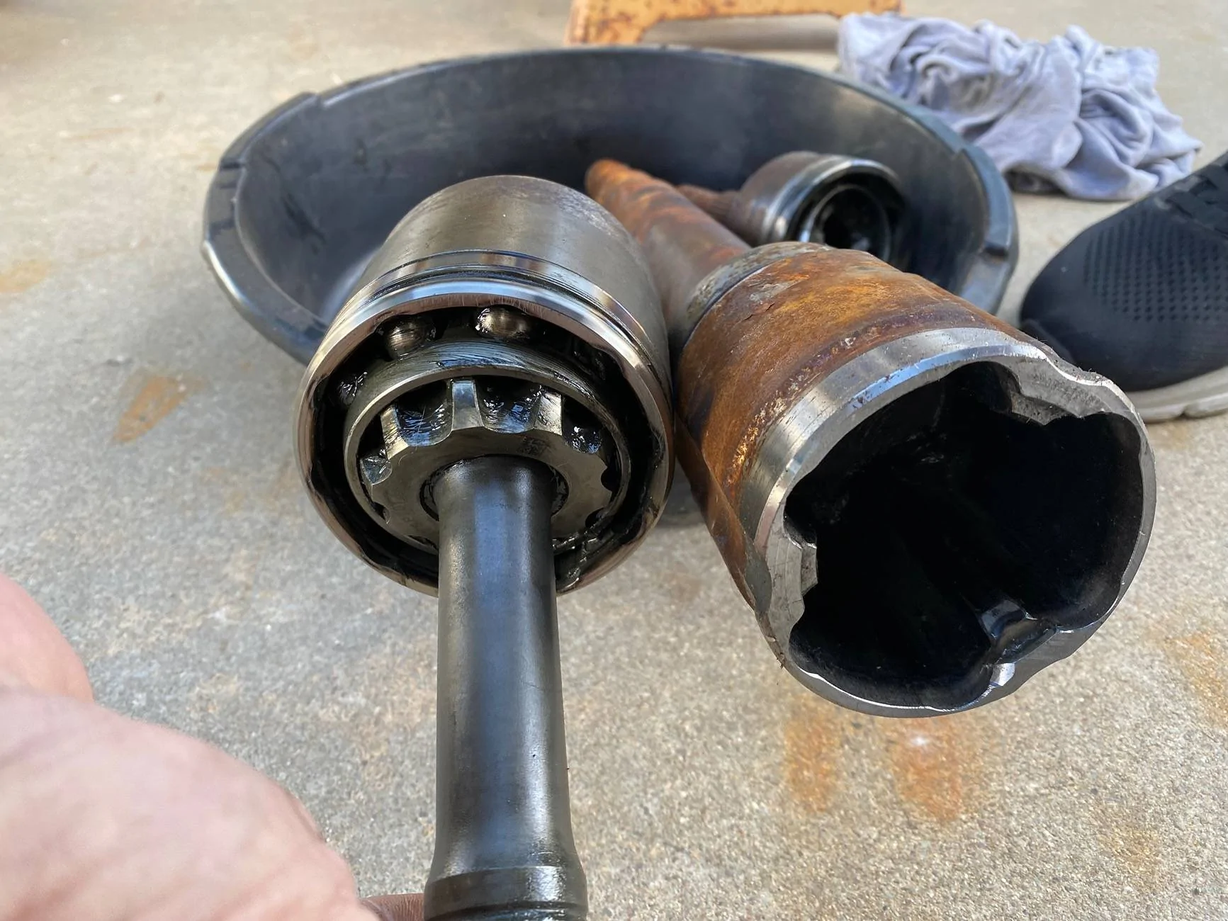

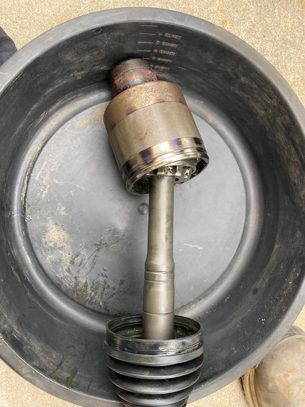

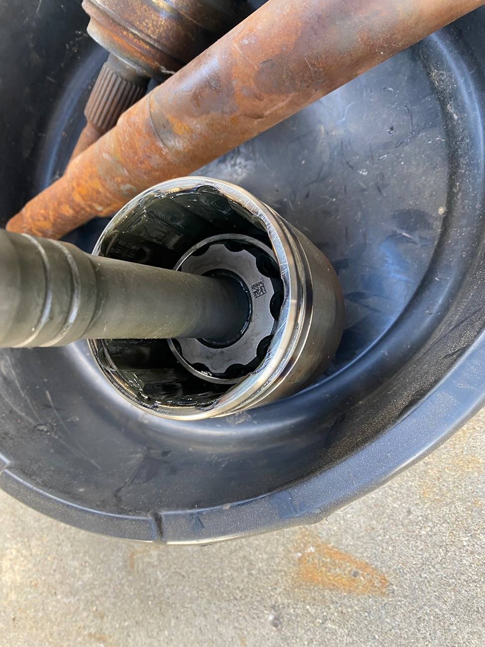

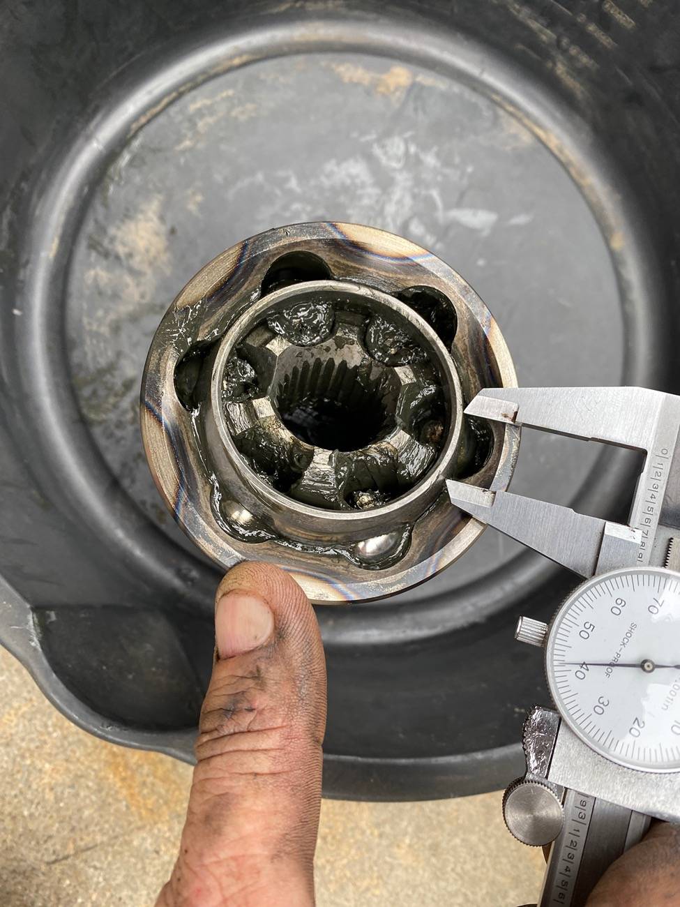

as you can see the 3 ring slider with needle bearing plunger side just looks weaker than the 10 ball with cage slider section of the tremor . Also about 1/2” difference in plunge distance .
