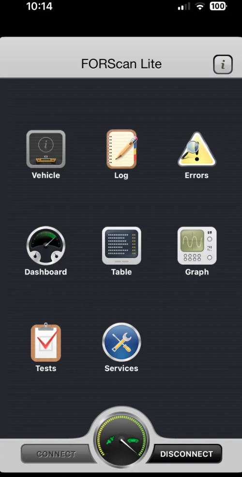

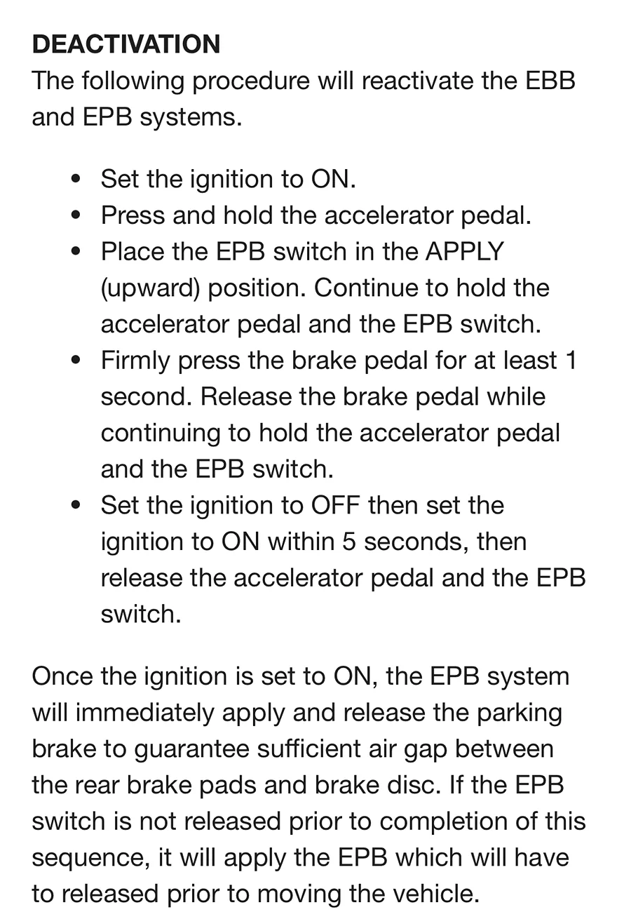

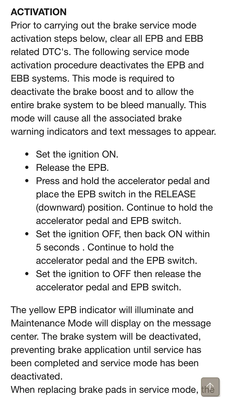

I ended up ordering the vLinker FS as posted on the Forscan sight. I'll get Forscan once that comes in. I'm hoping to find in Forscan the procedures to change the rear brakes (deactivate the EPB and to activate it once I change the rear rotors and pads). Hopefully it is similar to what was posted above.

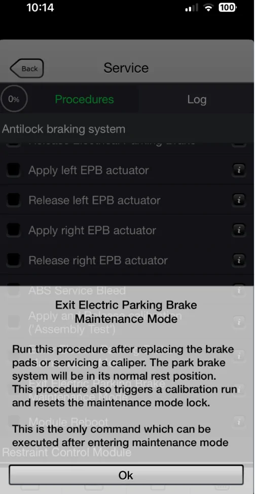

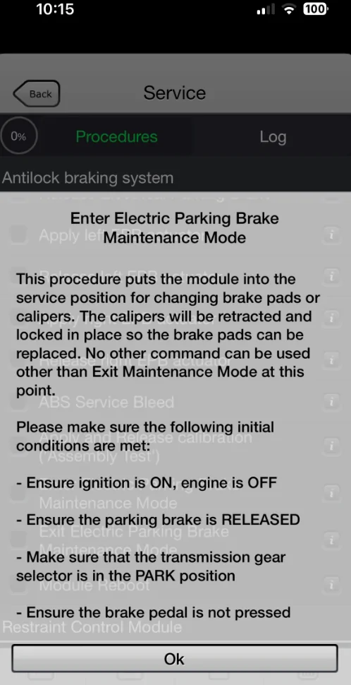

Hey all, I was able to enter the service mode on my 24 XLT Hybrid without issues but after completing the rear brake job and getting out of the service mode, I now have a string of warning messages and the red BRAKE illuminated and yellow icon bellow it showing on my speedometer(out of view in the video) that no combo of “press this and hold that, then stick your tongue out” is clearing.
Will Forscan for Windows and reader clear these hopefully?? Pic of reader I’m looking at and vid of the messages.

If the truck thinks brake maintenance mode is NOT enabled already - then a scanner is going to see the same thing because that's what it's asking.
