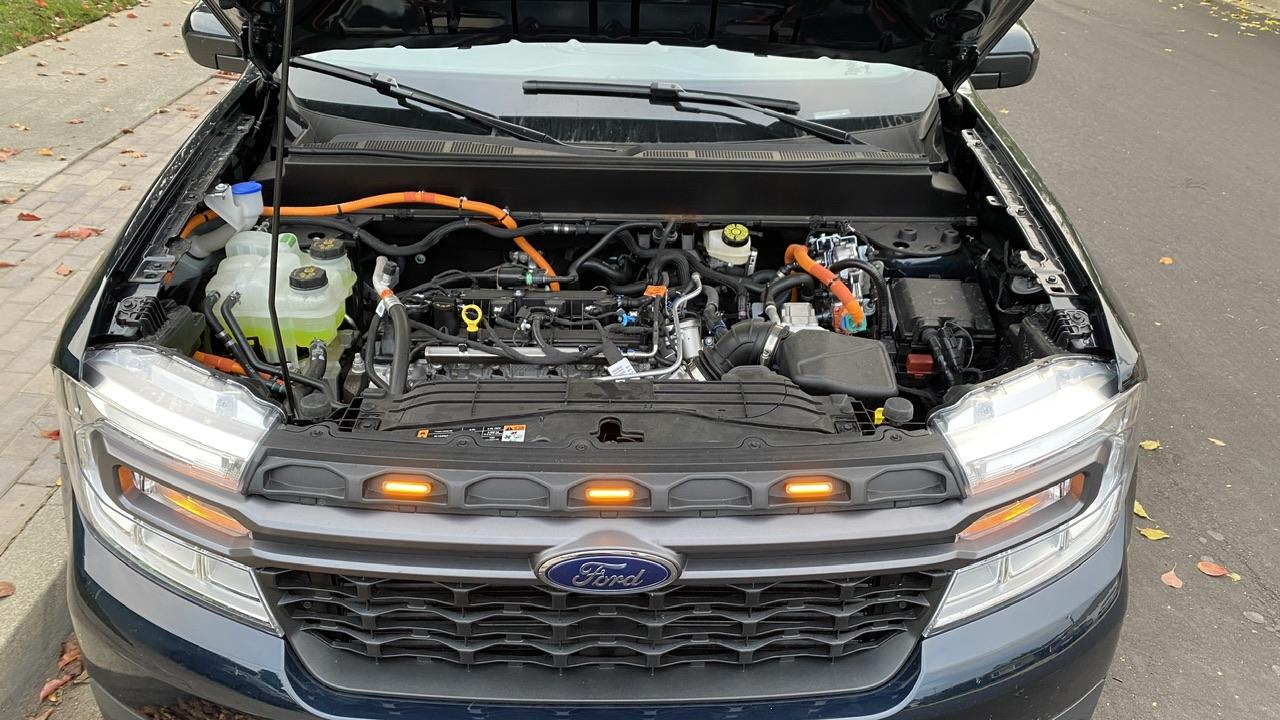

These amber LED are tapped directly to the side marker lights. No problems, ever. Been in service 1 year now.
Which ambers did you go with? That install looks very clean and I've been looking to do the same to my Tremor.
