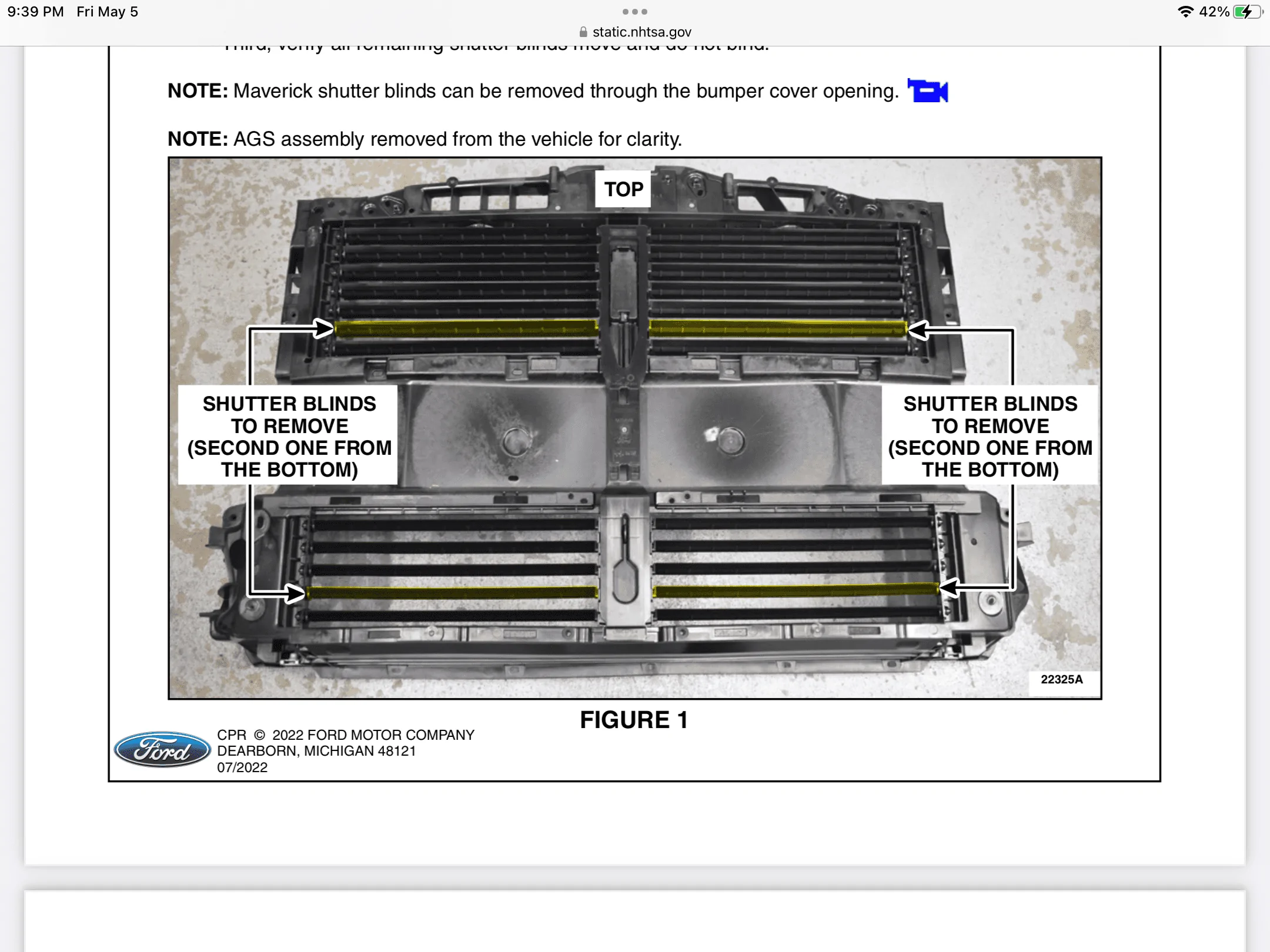

I asked one person about whether removal of the two bottom shutters, which a required step in the Roadmaster baseplate installations. His response was that Ford had ordered dealers to remove four "blinds" (movable shutters) to comply with the Recall 22S47, so how could it possibly be a big deal? (If you're interested in the recall info, I've given some of the info about it below.)
My particular '22 Maverick Hybrid came from the factory AFTER the specified "build date" range included in the recall, so it was not subject to the recall, thus it did not have the recall work done by the dealer. On inspection, there are no missing shutters... I have no idea how Ford addressed the shutter issue for vehicles built after the last date in the recall. Someone "told me" (no substantiation at all) that Ford had changed the programming for the shutter system and deemed that adequate instead of removing the shutters. I have no clue if that is accurate or not.
For me, the idea of making this type of modification (removing a couple of adjustable shutters from the cooling system) is worrisome enough that I will probably go with the Blue Ox system (ugly though it may be) until and unless I see something in writing from Ford stating that the Roadster mods (removing the two bottom shutters) does NOT invalidate the warranty. I'm just not willing to take that type of risk - but that's my decision and doesn't have to align with yours...
Safety Recall 22S47:
Here's the pertinent wording from Ford's notice to dealers (bold emphasis added by me):
REASON FOR THIS SAFETY RECALL
Isolated engine manufacturing issues have resulted in 2.5L HEV/PHEV engine failures involving engine block or oil pan breach. The fluid dynamics induced by the under engine shield and Active Grille Shutter (AGS) system could increase the likelihood of engine oil and/or fuel vapor expelled during an engine block or oil pan breach accumulating near sources of ignition, primarily expected to be the exhaust system. Engine oil and/or fuel vapor that accumulates near an ignition source, may ignite resulting in an under hood fire, and increasing the risk of injury.​
SERVICE ACTION
Before demonstrating or delivering any new in-stock vehicles involved in this recall, dealers are to modify the front under engine shield by creating additional drain holes and modify the AGS system by removing 4 blinds. This service must be performed on all affected vehicles at no charge to the vehicle owner.​
(Note - there were ZERO reported fires with Maverick Hybrids leading up to this recall. Ford did this in response to a class action suit that included a range of Ford Hybrid vehicles as potential class members. It was purely a preventative legal maneuver, and not something to actually concern potential Maverick Hybrid owners. Ford even stated that there was no reason to stop using the vehicles, nor to only park them outdoors.)
My 23 had the shutters removed from the dealer. Dealers can be fined up to $21,000 for selling without removing.
