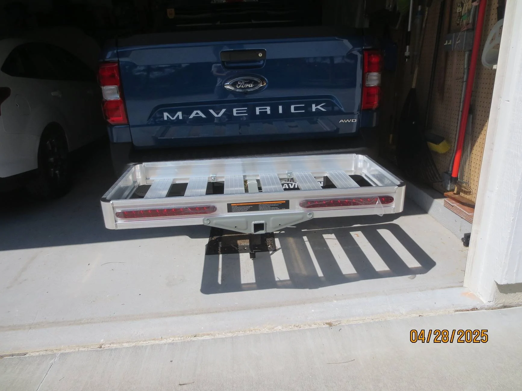

I bought a hitch cargo carrier and put lights on it, directional, brake and running lights. I just read on another post that Bliss, among other safety features will not work when the trailer light plug is used. Is there a work around to have the safety features work?

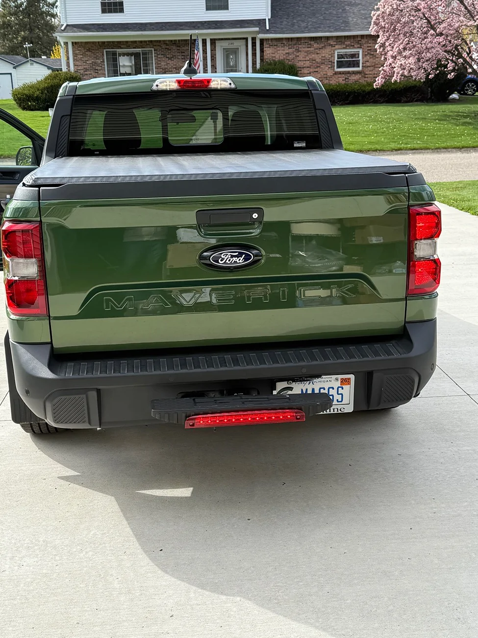

I added a lighted step bumper and wanted the brake light to work on it. To enable that and retain Bliss functionality, I bought a trailer harness online to add another four way connector to plug it into. Plug and play into the passenger side tailight and works great!

This is with my brake on. Step bumper is plugged into the aftermarket trailer harness made for the Maverick.
