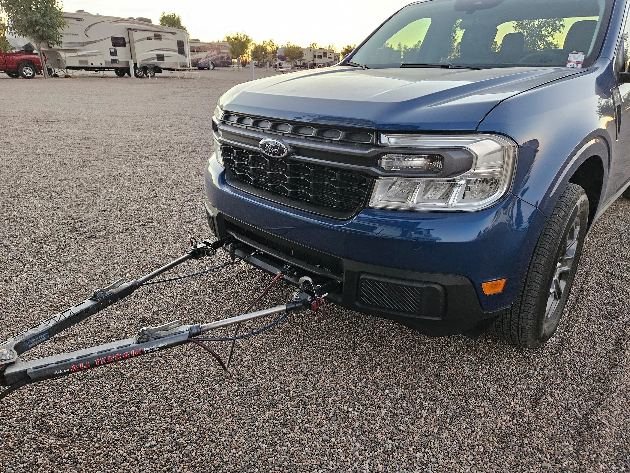

I use a RVI Brake II in my Mav. It fits the floor pan and works well. Originally I had it set to small SUV and medium sensitivity. Turned out to be way too sensitive and would enable Mav brakes on even minor MH braking. Now set to mid sized and low sensitivity and seems to work much better - still experimenting, I've only towed the Mav twice. The RVI Brake is portable and is best for me because I also tow a Jeep Liberty. I self installed the Roadmaster base plate, it does require removing the entire lower Active Shutter assembly. Not worried about warranty issues, there are laws that require the auto manufacture to prove modifications result in auto failures resulting in warranty claims. Having the lower active shutter system removed seems to me like it would provide better air flow to engine area making it difficult to understand how it could cause a problem. I installed the Roadmaster before the Demco base plate was available, if I were to do it again I would go with the Demco and get Demco ends for my Roadmaster tow bar.
