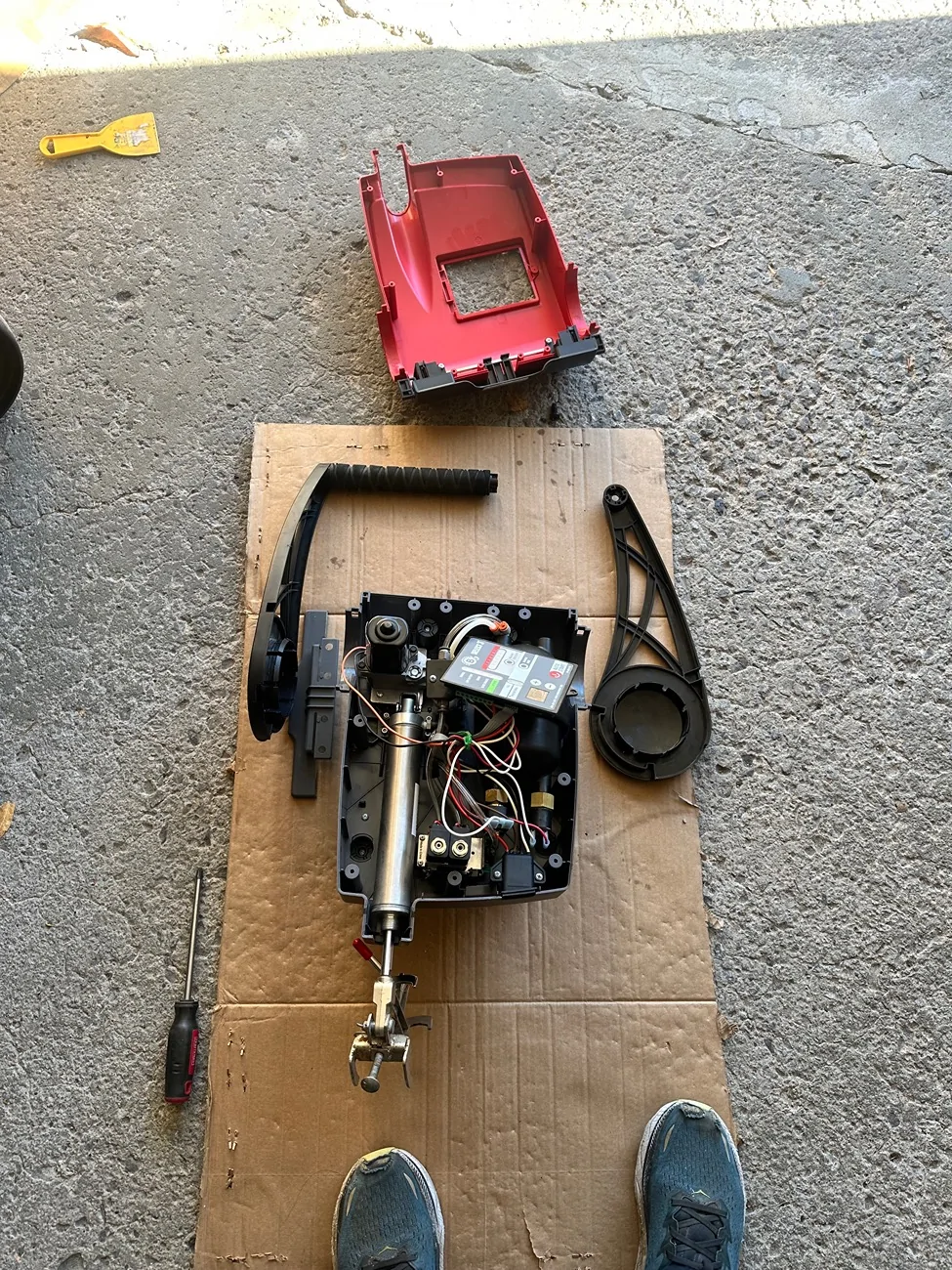

I have a Brake Buddy Select 3 which I use in my 2025 Maverick Lariat Hybrid. My problem is the when the brake buddy activates it slams on the brakes and locks up all 4 wheels on the Maverick. Even when it’s on lowest PSI setting (10 lbs) and on Hybrid selection. I spoke to Hopkins (the manufacturer) and they said they couldn’t assure the select 3 would work with any hybrid Maverick due to the electric brakes. But it worked fine with my 2023 Maverick Lariat!
I’d like to take it apart to put a psi limiter in the air line from the actuator to reduce the pedal pressure. But I’ve taken out all the screws and still can’t pry the top off.

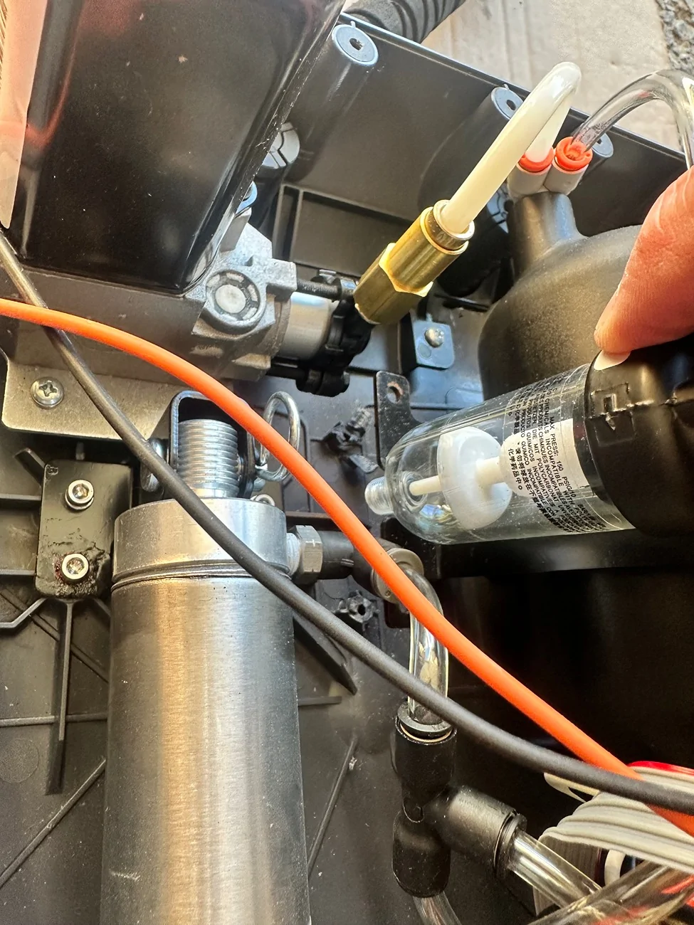

I finally did get the brake buddy apart. It requires taking the handle apart in order to split the upper and lower sections. Once I did that I found one of the pieces of the system had broken from its base of support. I’m not sure if that is part of the problem, but I will secure it back into place and add a pressure limiter to the air circuit and see how that works. In the second photo you can see my fingers holding the part that has become unsecured.
