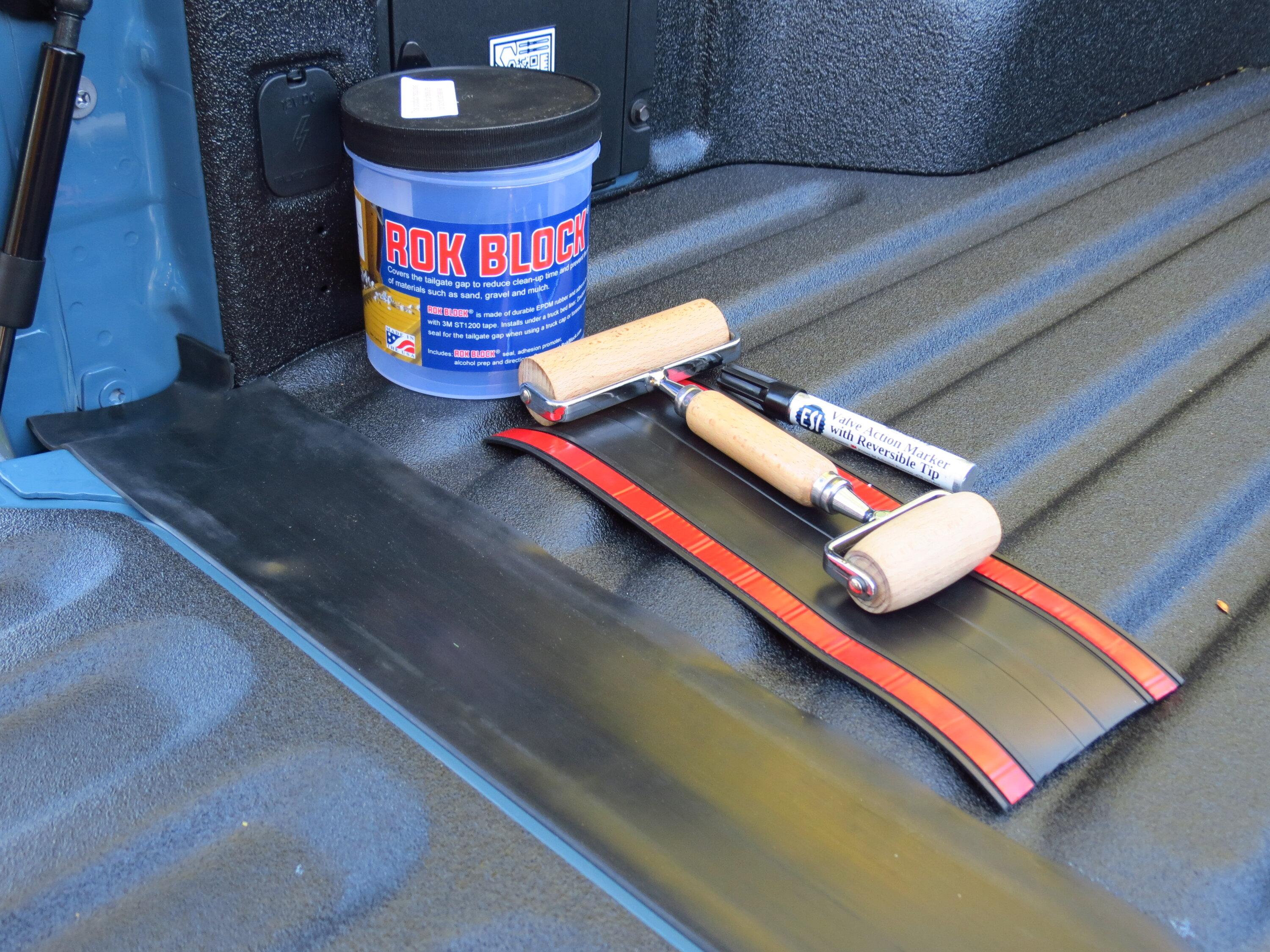

When I first got my Mav, I just siliconed a piece of screen over that hole because I've had serious rust problems with the gate on a prior truck due to stuff getting in there and retaining moisture.
Ford Maverick How do I take apart the tailgate? img_0834-
But adding a Rok Block works even better.
Ford Maverick How do I take apart the tailgate? img_1231-
This thing has been worth every penny. More details in my build thread here starting at post #7.
