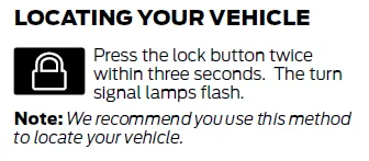

NOTE: The second lock button push arms the perimeter alarm. It Also turns off the courtesy lights and dash + radio within 1-2 seconds. AND VERIFIES THAT THE LOCK WAS SUCCESSFUL BY HONKING ONCE AND IF HOOD IS NOT LATCHED OR ANY OF DOORS WERE NOT COMPLETELY CLOSED IT WILL HONK TWICE! (I have not checked but possibly also verifies cabin is unoccupied). I have left a door open or hood unlatched to even the first/second release to verify double honk works.

The double horn on two lock presses is intentional to be used to locate your vehicle (instead of using the panic)
The single honk after the second lock button push is "lock is successful" and if one or more doors OR THE HOOD is not completely shut and truck is NOT successfully locked it will hink twice. Also if you want to exit your truck and leave it running with key inside put it in park AND set the emergency brake then the double honk will not occur as long as the driver door is left open. Allowing you to go to mail box or gate or whatever. Shut the door and the double honk will happen to let you know that fob is still in truck.
