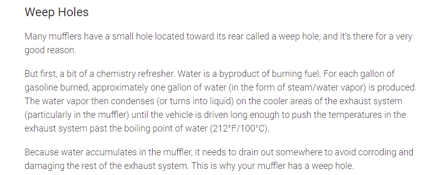

1. Water draining from muffler weep holes is normal. Almost all modern vehicles have intentional muffler weep holes. Google 'muffler weep hole' and you'll see references for almost every car manufacturer. A typical result - from What are the Effects of Having a Hole In Your Muffler? - In The Garage with CarParts.com

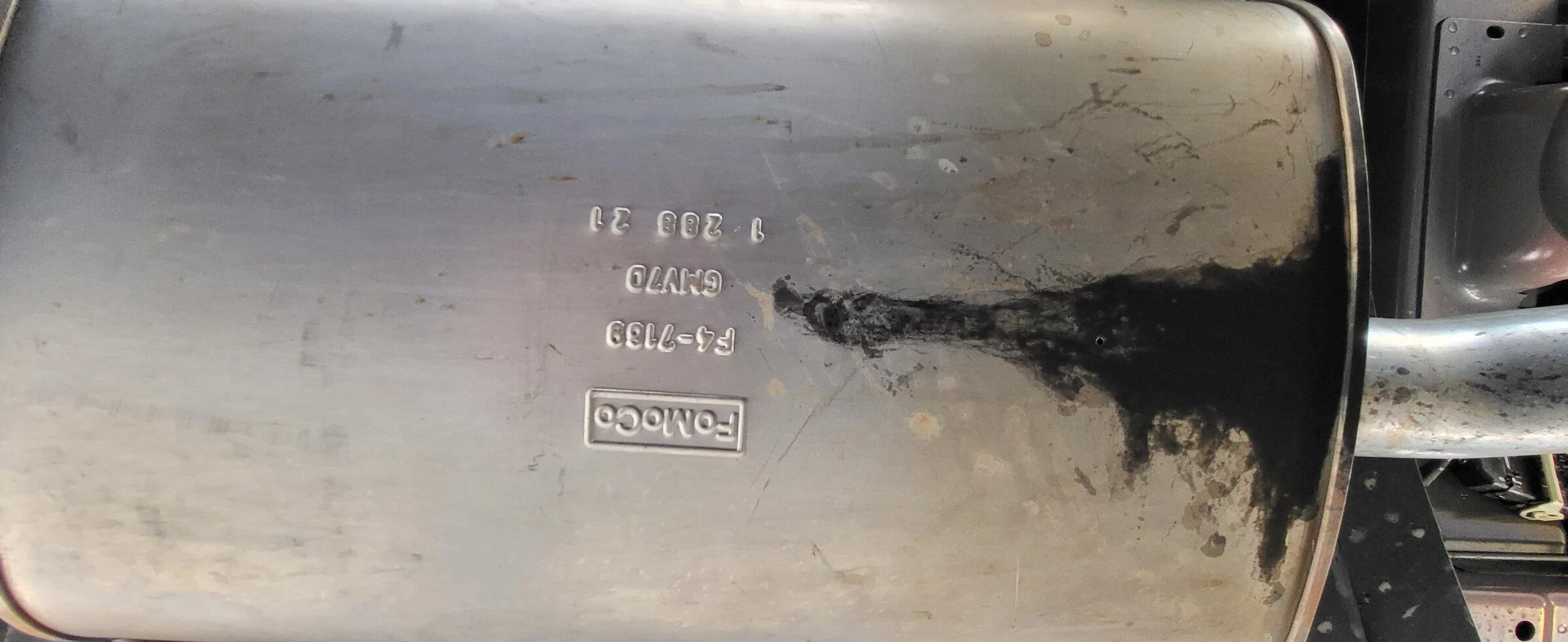

2) Carbon (i.e. 'soot, or ultra-fine particulate matter - PM) on exhaust - again, normal to see on tailpipes for direct injection (DI) engines like the 2.0EB. With the Hybrid 2.5L Atkinson engine (port fuel injection, PFI) you should not really see much 'soot' at the tailpipe. The black stuff around the muffler weep hole obviously a product of combustion that the water condensation captures. Not that unusual in my view.

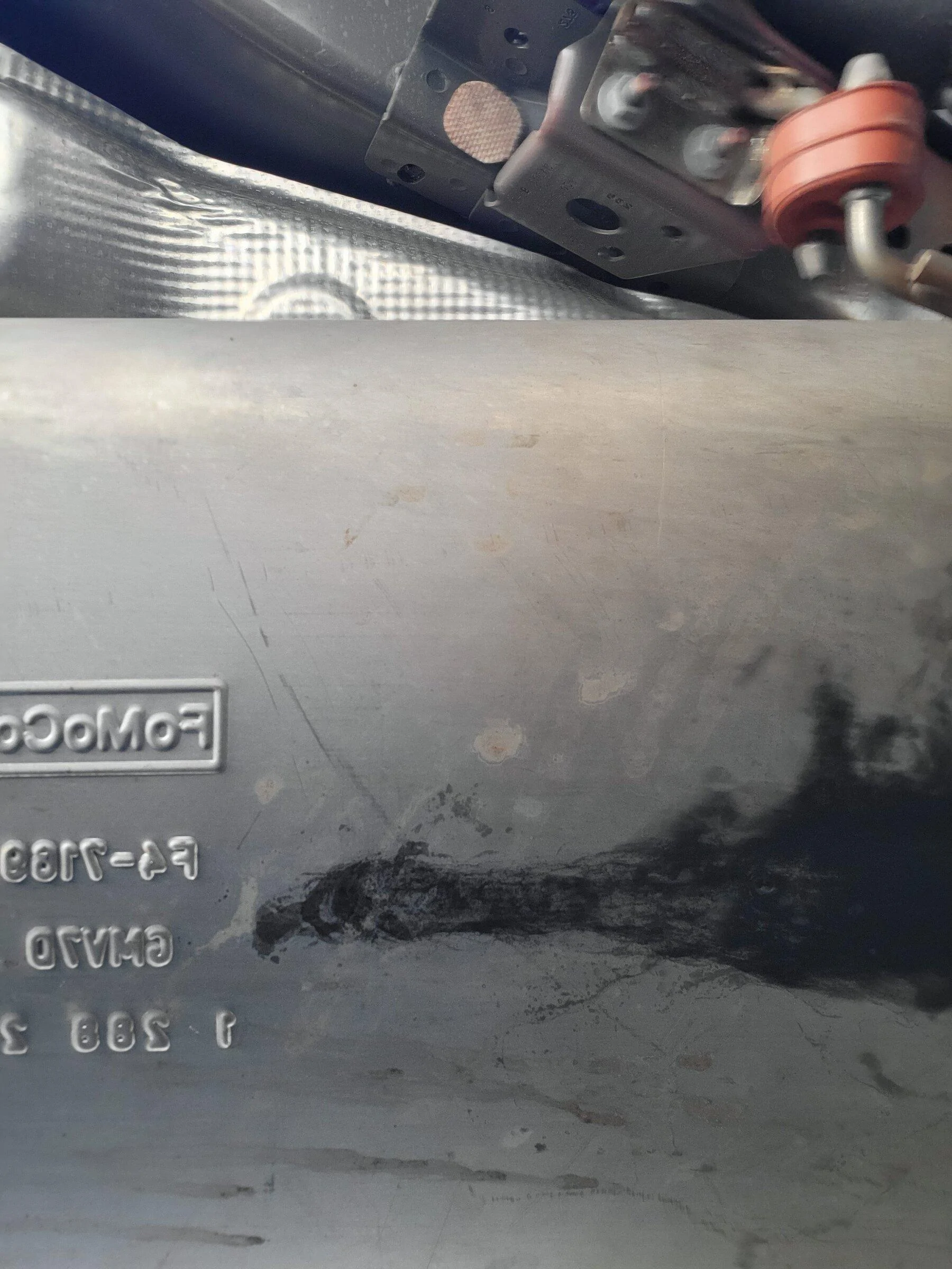

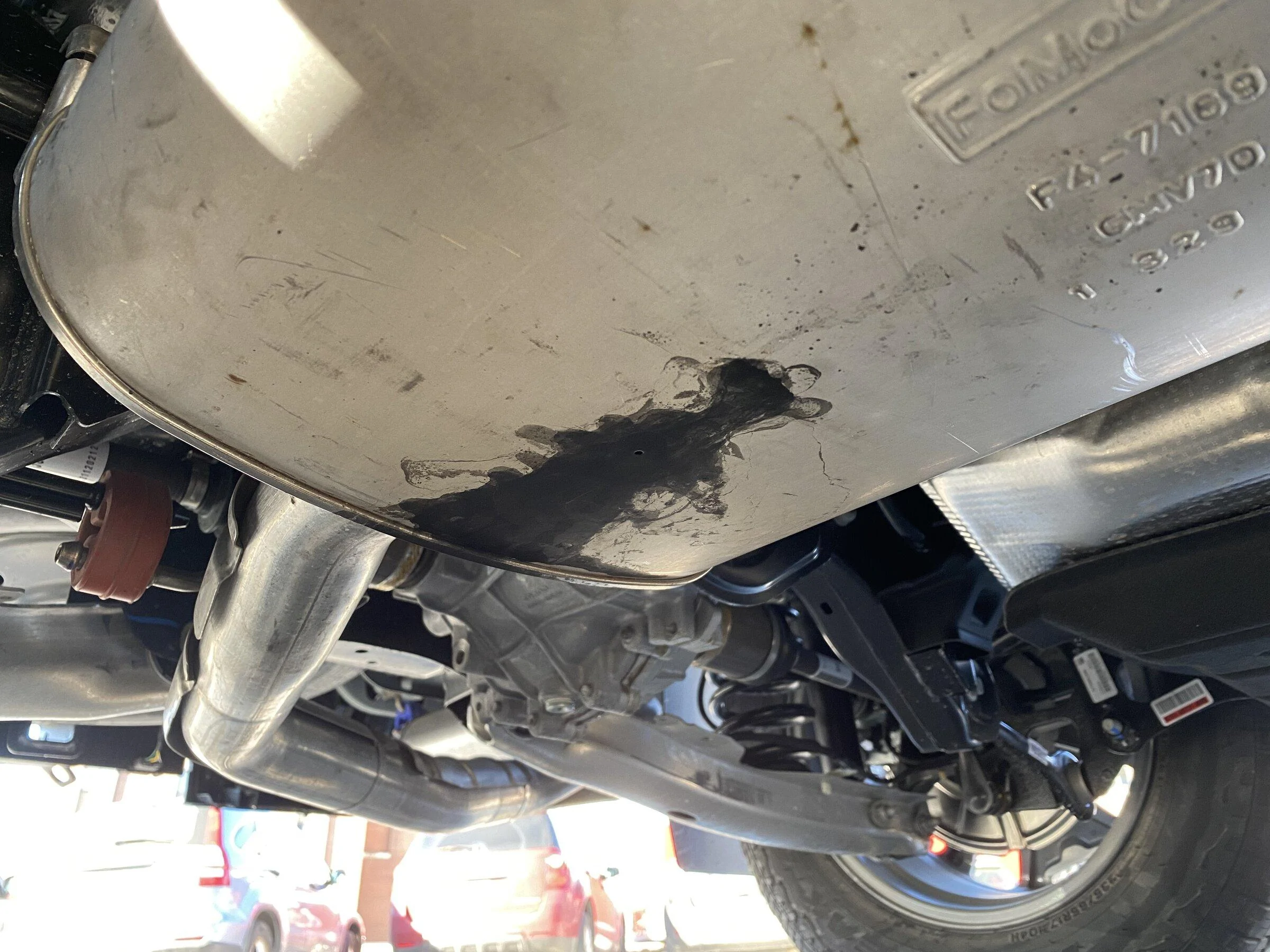

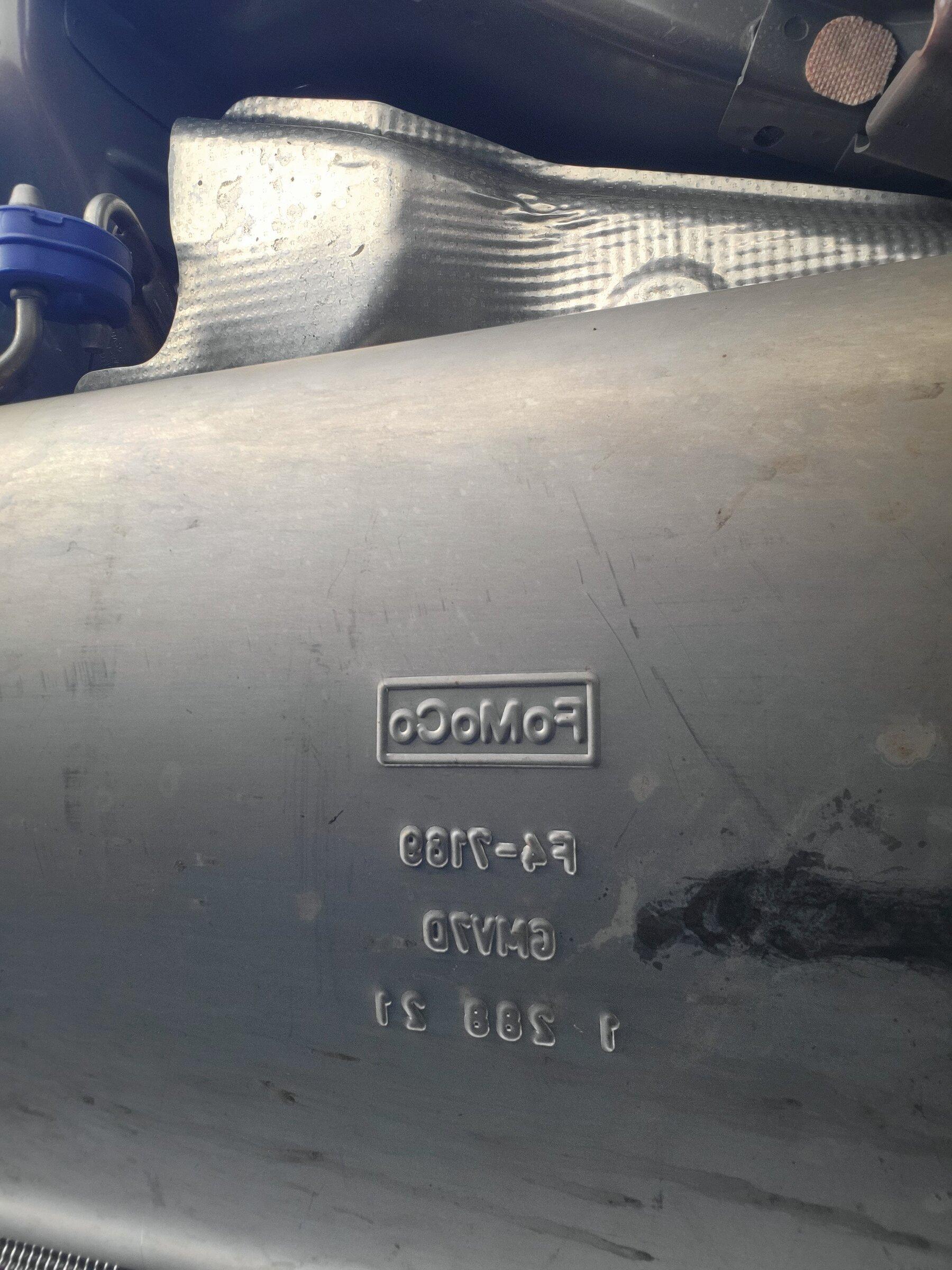

Hi! I picked up my truck last Saturday and so far its been a blast. We just did an 870 mile road trip from Maine to Philadelphia this past weekend. This morning starting my Maverick I noticed exhaust coming from the muffler with what looks like a punch through hole. I think it might of been done at the factory with how clean it looks, like a precision cut. I have an appointment friday to get it looked at and probably replaced with the warranty. So far I have no exhaust smell in the cabin, smell of something time to time I think is break in Has anyone else had this issue? I’ve attached some photos and a video. My Maverick has 1100 miles.
Completely Normal
All exhaust systems have little weep holes strategically place through out the exhaust, I'll make a video on it tomorrow and explain - depending on climate and how.long the vehicle is in open loop will determine how the Internals look but that little black fueling is what's coming out and it's normal.
Hotter climates won't see it as much but still possible

Thank you for responding, and I look forward to your video! I have not noticed any issues with it and I currently have 2500 miles on my Maverick. I used to own a 2012 CRV and I never noticed smoke like this out of the muffler, either because I wasn't paying attention or because it wasn't as smokey during cold starts as a DI engine.
