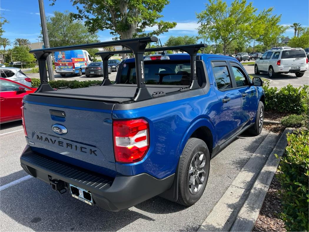

There may be other adjustable racks, but I can recommend the Elevate Rack System. It works great for my Maverick. The posts are adjustable (up/down 3 settings) and you can slide them (front/back) on their tracks; then tighten them in place. Also, they are easily removed. The crossbars have t-slot rails on both top and bottom, so you can mount/attach various items securely in any position across the width of the crossbar. I have my rack set at the lowest of the settings - and my fishing rods still clear the cab with no problem - and I can still drive it in-out of my garage with room to clear.

I can’t speak to the clearance for the Tri-Fold cover. I have the Pro X15 roll-up cover. Since the racks can slide, I’d bet you could slide them out of the way to fold it up. Although that seems a bit inconvenient. In any event, the pros at RealTruck can probably help answer your questions, with greater accuracy. Their phone number is: 877-875-4376.

I have the elevate rack and absolutely love it. Like others have said Its technically adjustable with 2 bolts in each vertical section being moved so not a quick thing to do. Removing them is definitely quick though I can take them off by myself in only a couple of minutes. I keep a plastic ammo container under the back seat with a small socket and hex key set so I can take it off anywhere I need too. I definitely wanted an easy to remove option so I can go through a car wash and its quick and easy. I was thinking about trying a tri-fold with it at some point. I feel like it has enough room even with the front rack all the way forward but I haven't measured it to know for certain. If there isn't I feel like it would be easy enough to unbolt and slide it forward for enough space and only take a minute or two.
