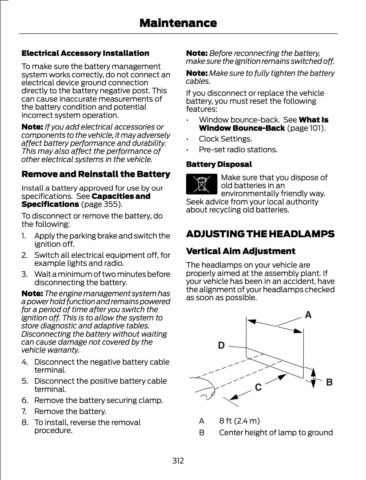

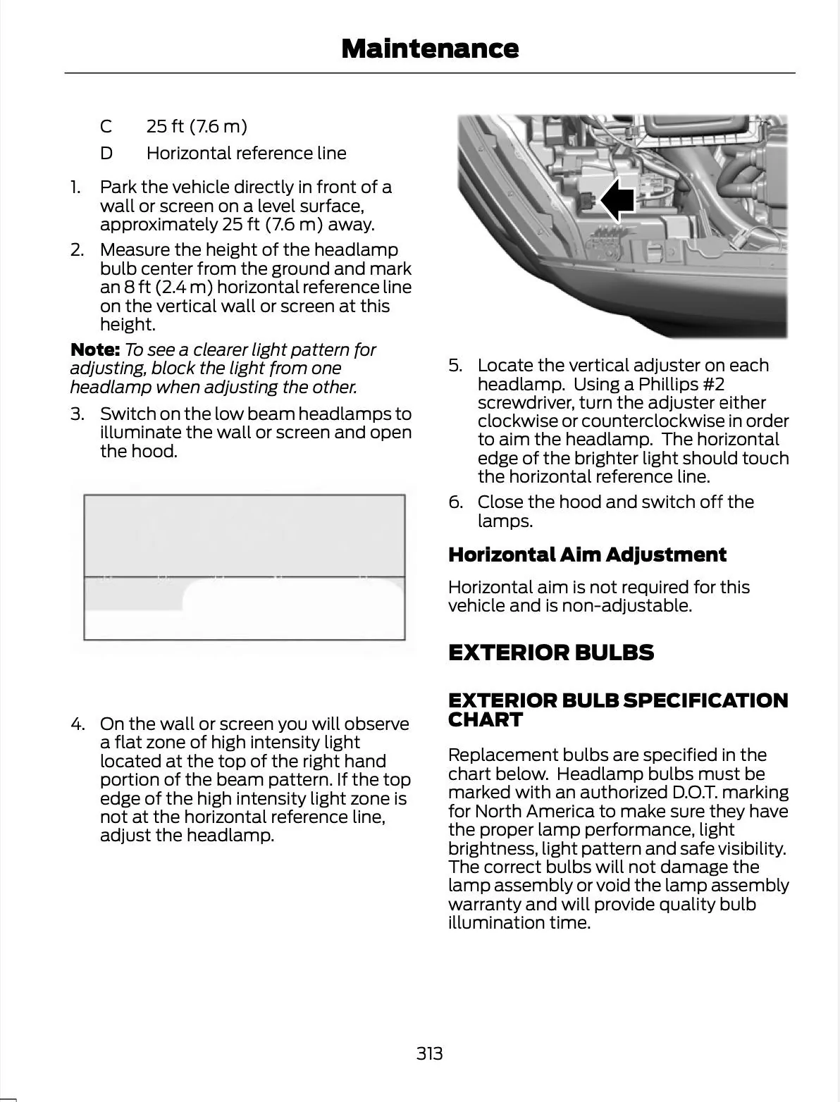

I leveled mine with the H&R adventure lift springs which brought up the front quite a bit from stock so I had to adjust the headlamps.
From the owners manual on adjusting headlamps:
Ford Maverick Headlight adjustment after being lowered? Screenshot 2023-03-20 at 5.56.57 AM
Ford Maverick Headlight adjustment after being lowered? Screenshot 2023-03-20 at 5.57.15 AM

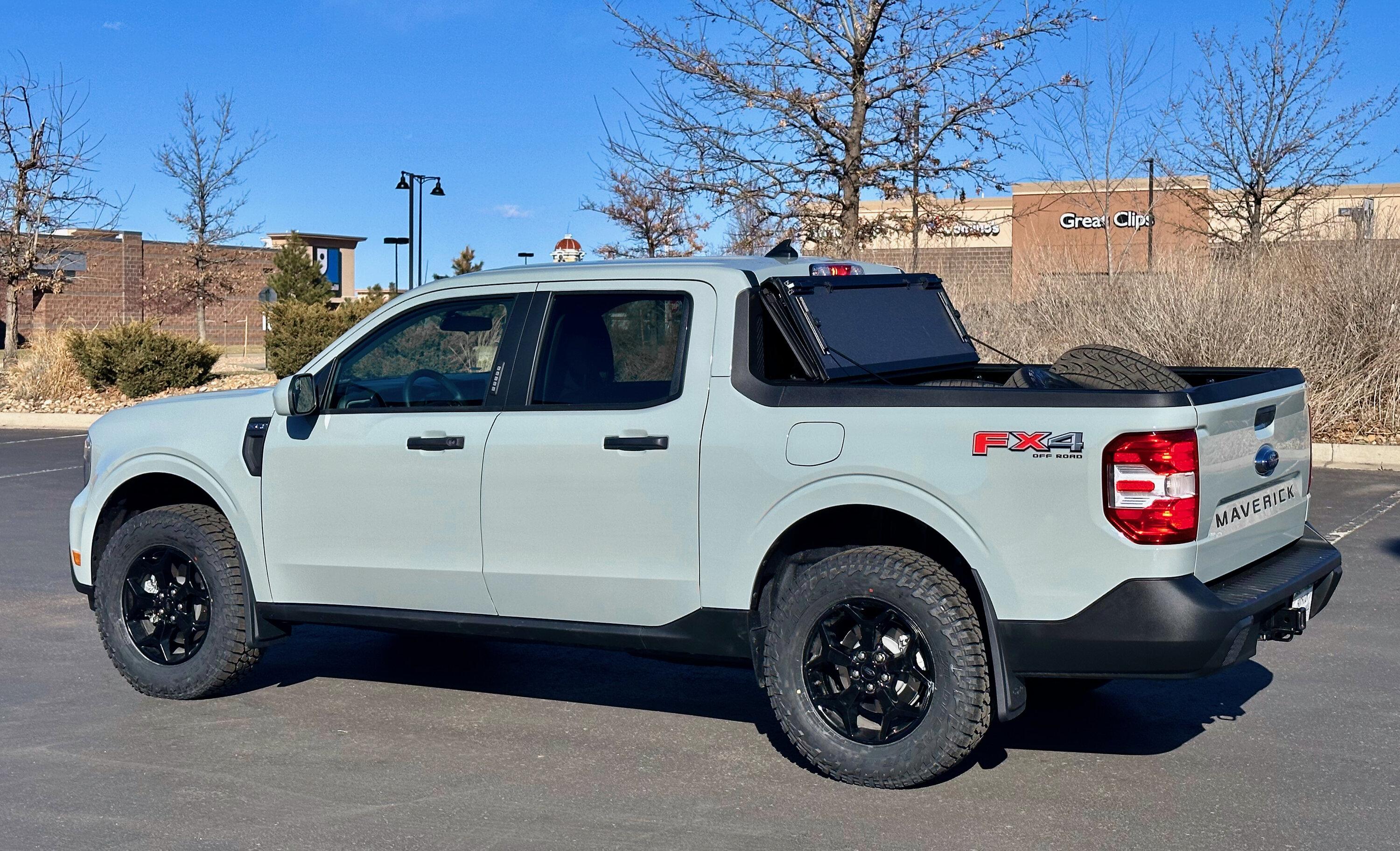

After installing the H&R springs and Falkin Wildpeak 245/70/17's
