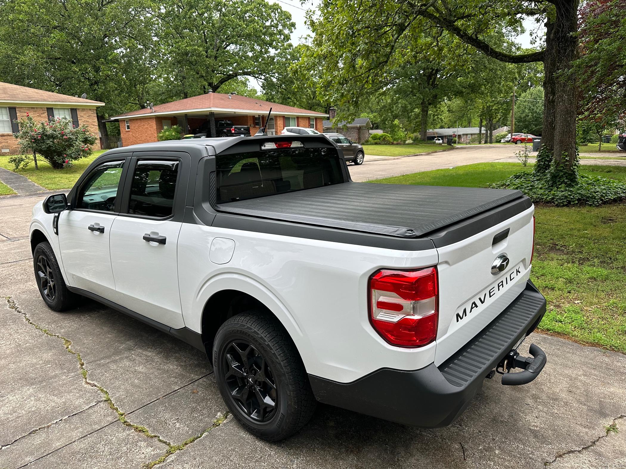

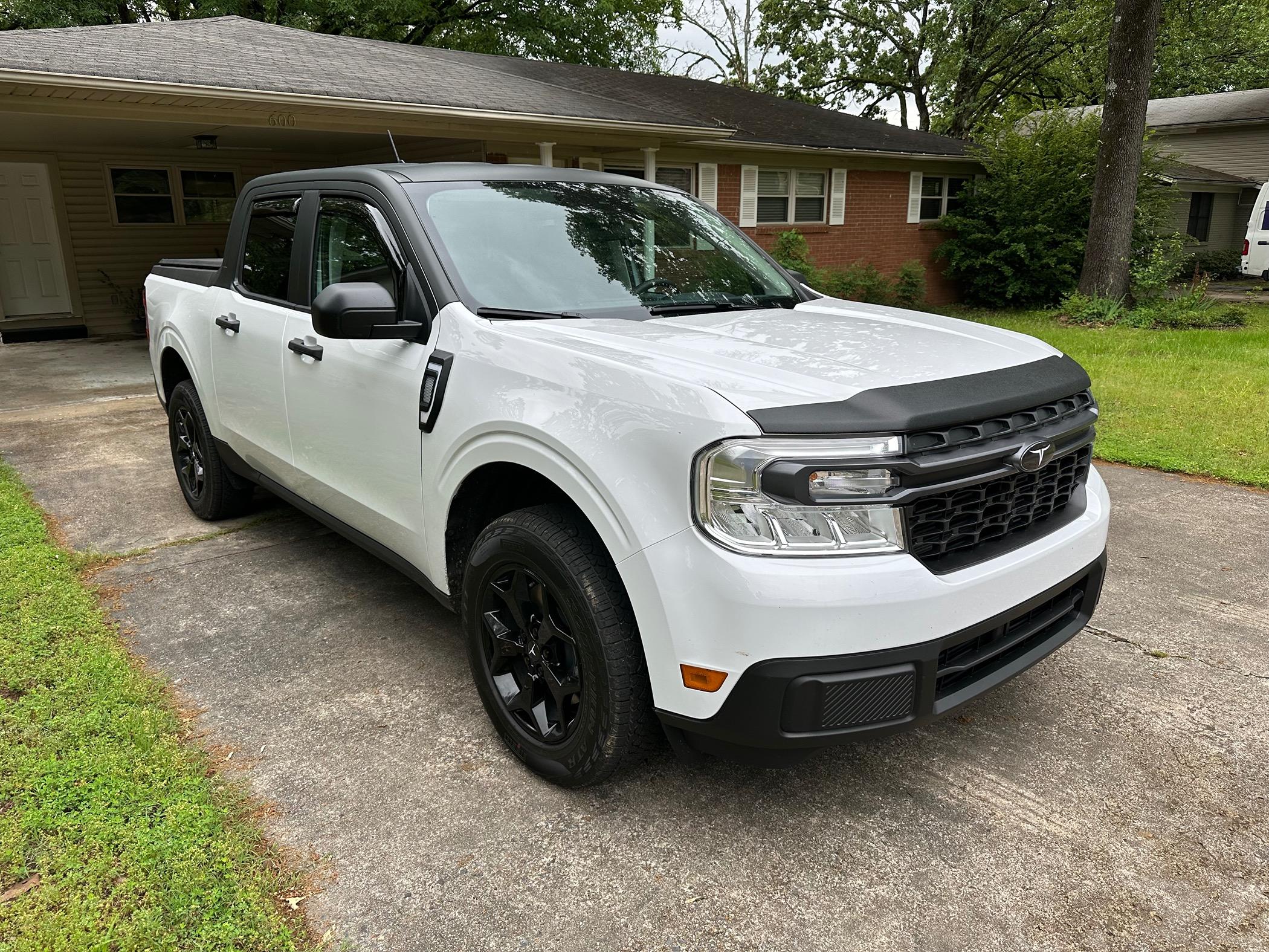

Hi @Baloo Great idea. Yes, I'm planning on the knifeless tape for the antenna.
How about the center high mount brake light?
I'm planning to waterfall the wrap down to the rear window. The space between the antenna and brake light is so close, I'm worried about ripping the wrap once I have it cut around the antenna and I'm stretching the wrap to the brake light.
Knifeless taped the 3rd brake light. They do make adhesive promoter too. Heat gun is also a plus.
https://a.co/d/dybnBLa
