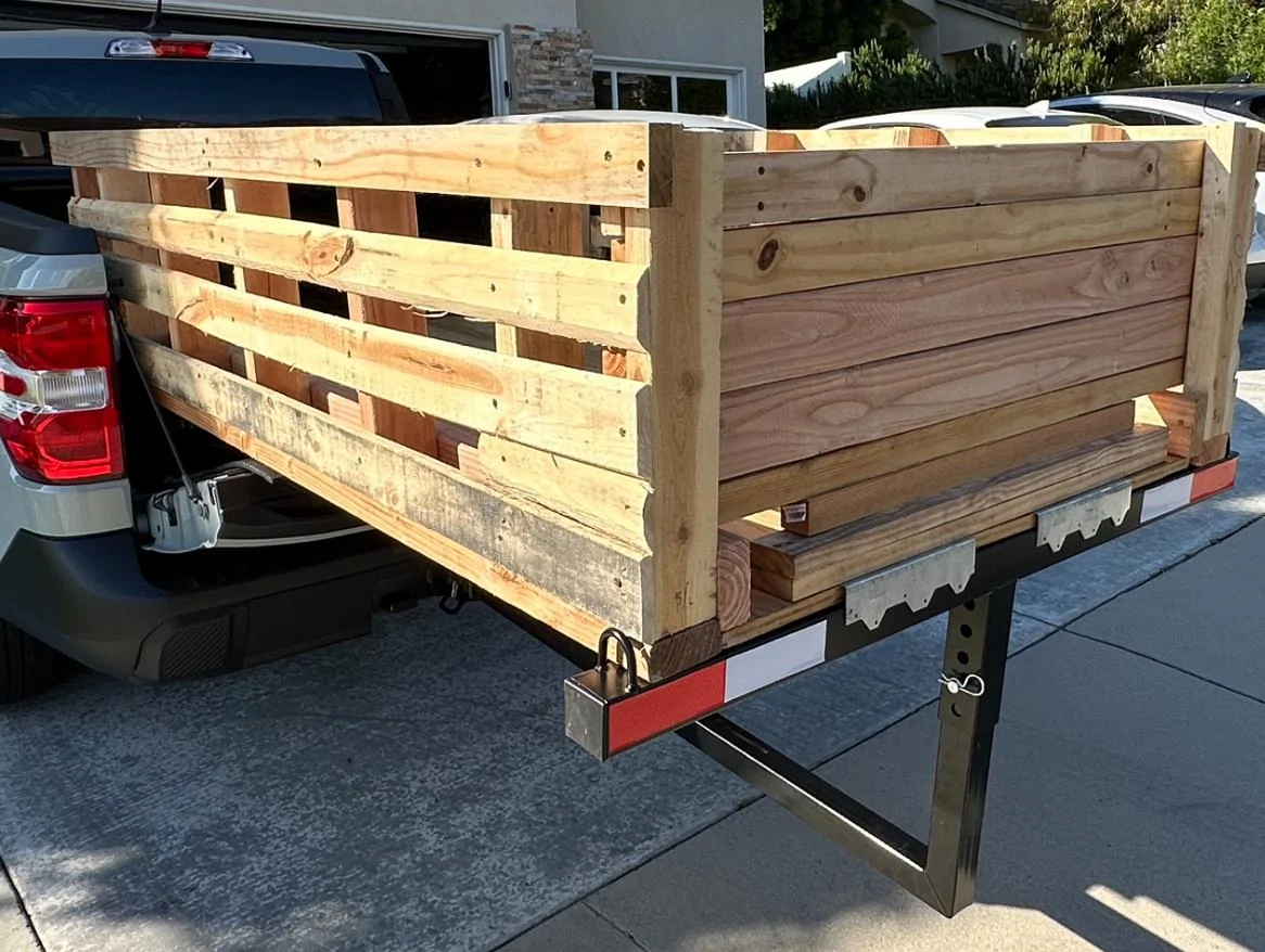

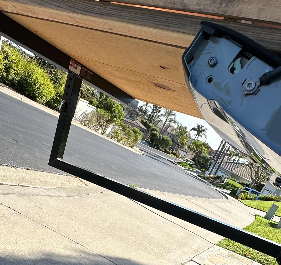

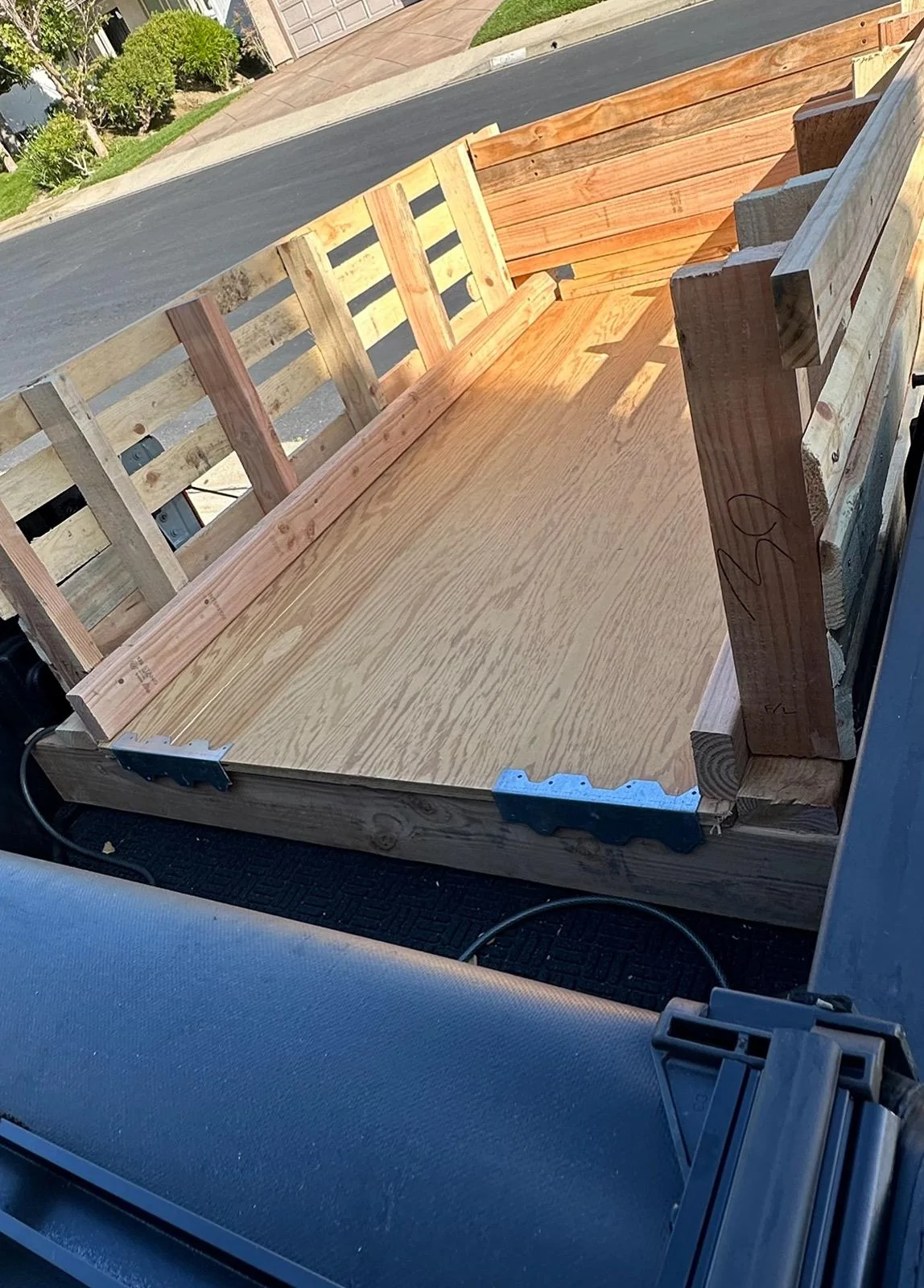

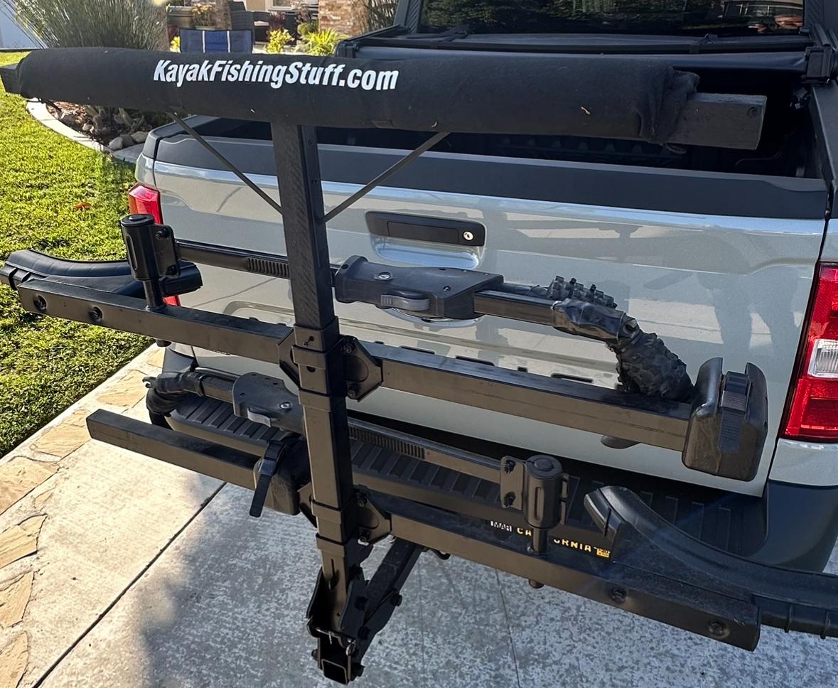

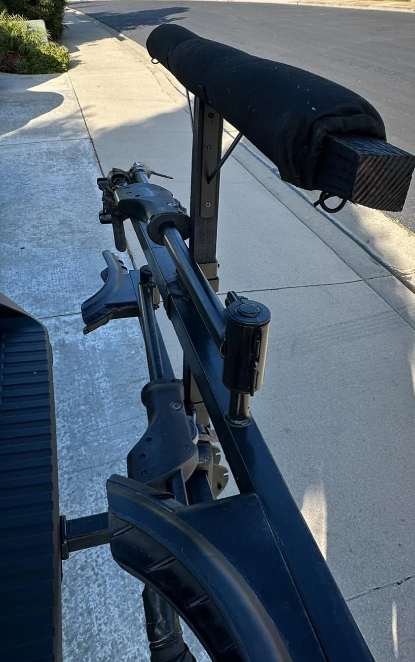

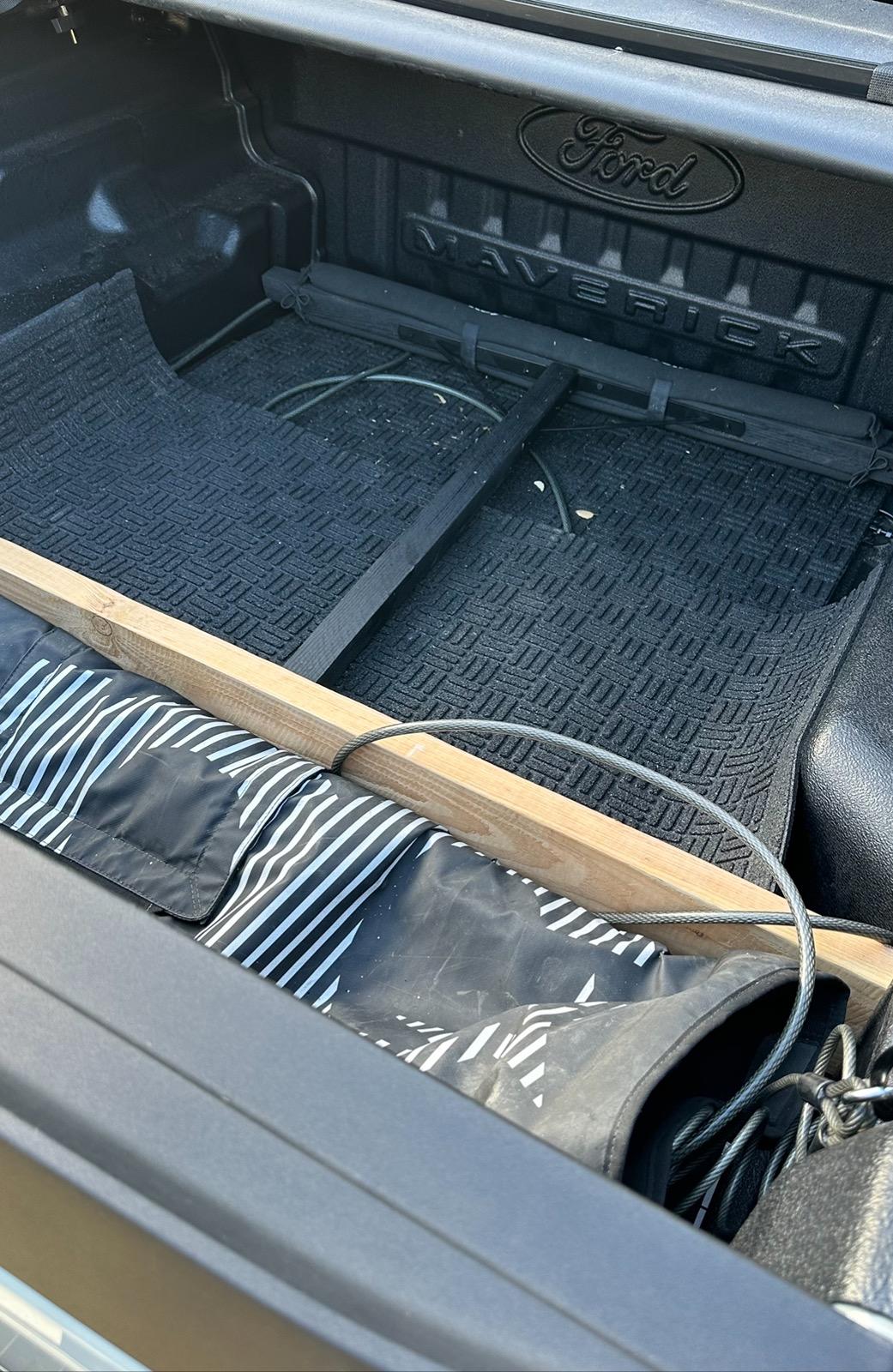

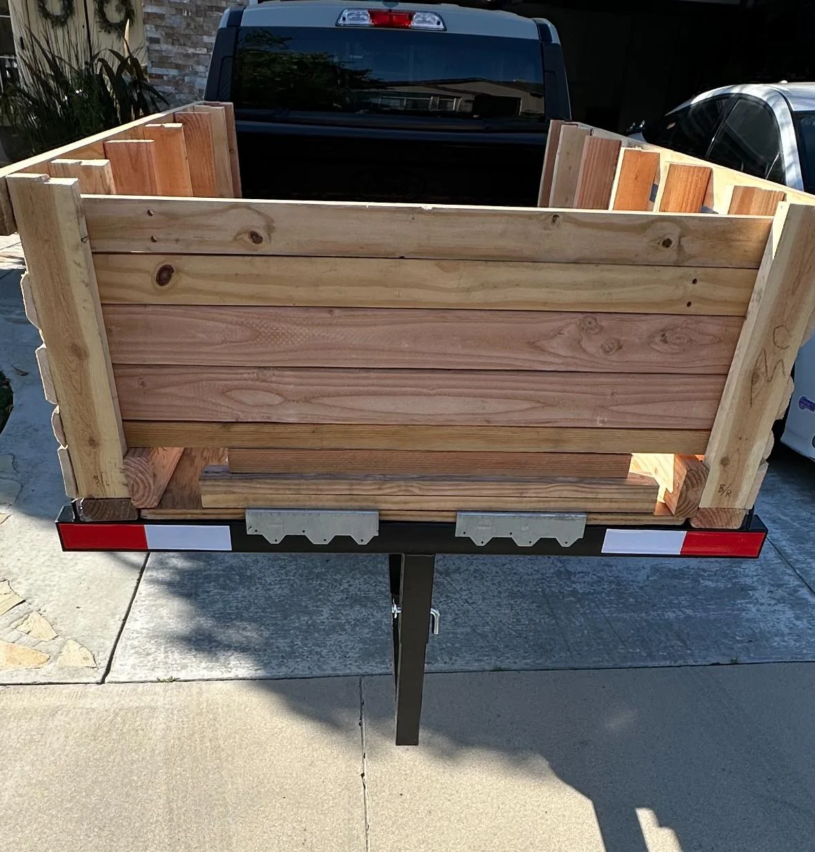

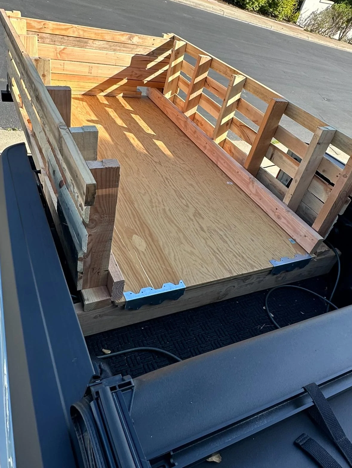

I needed to haul stuff to the dump and move my daughter out of her college dorm. I did not want to rent a UHaul trailer. So I spent $50 with a coupon at Harbor Freight to buy the hitch extension and about $20 in wood at Lowe’s for my 2024 Maverick Hybrid. It took me about 1 day to build with stuff I already had in my garage like the plywood and wood screws, but it works great! My bed is 9 feet long with the extender. It’s very secure, easy to take apart and store.

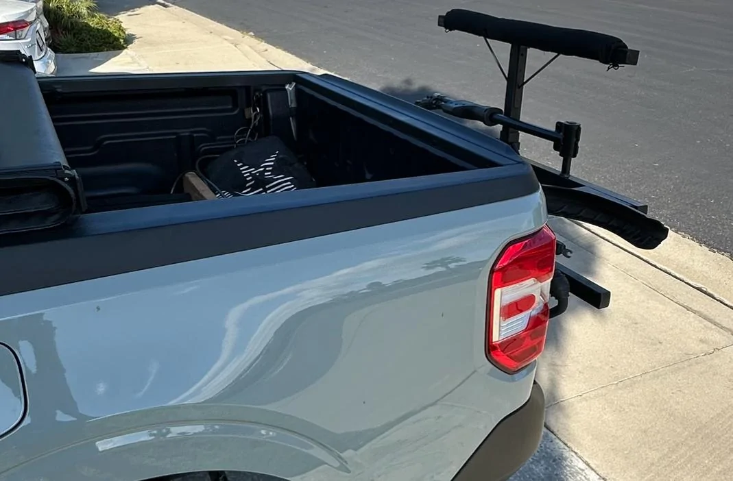

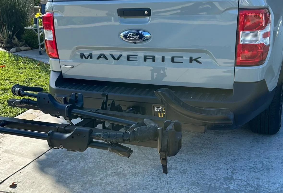

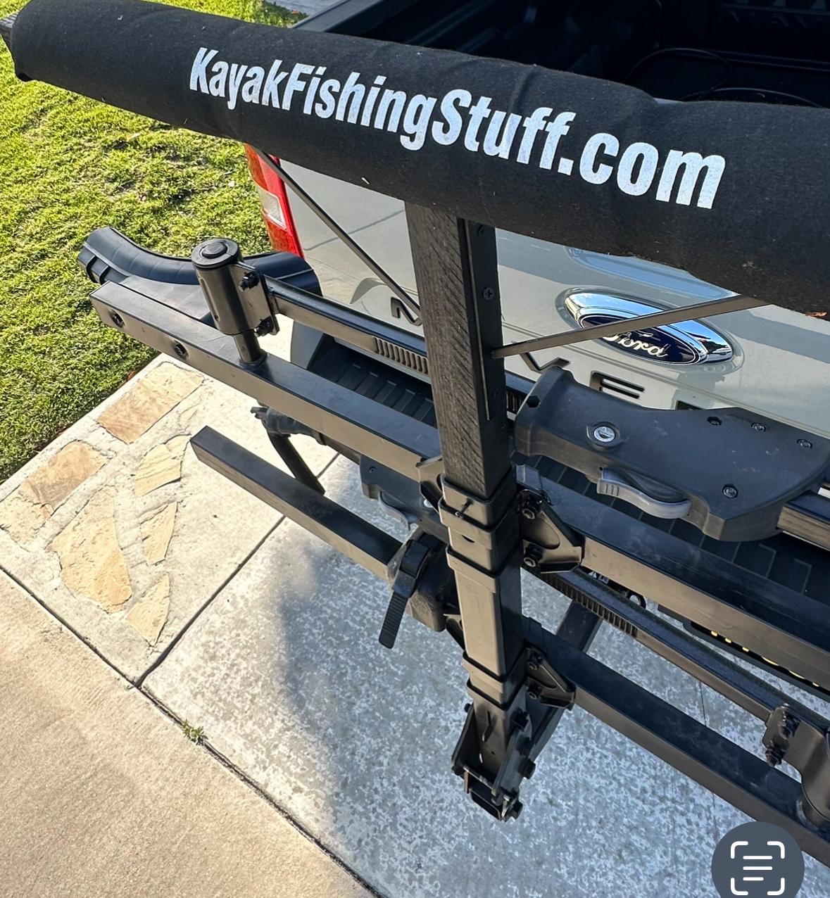

I also spend a little time to make this custom paddleboard, kayak or longboards extender on my Thule bike hitch rack.
Chreers.

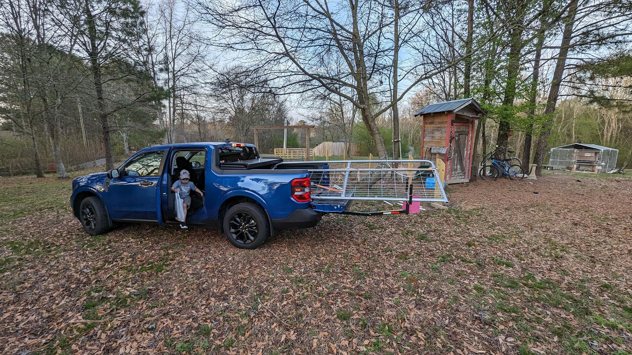

I built a deck using 12 foot boards, and with the tailgate hooked in the half way position and the extender at its highest setting, the wood had 3 points of contact with about 2 feet of overhang.
Worked out really well, and managed to get 60mpg the 8 miles back from Home Depot.
