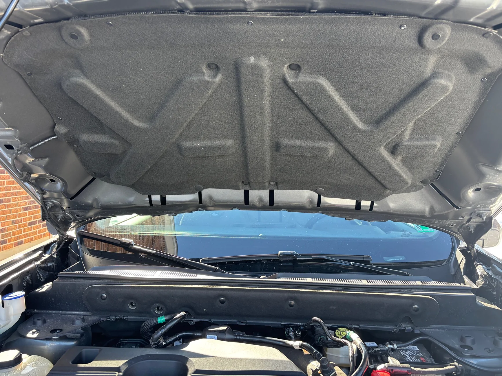

My sound deadening journey was a long process.

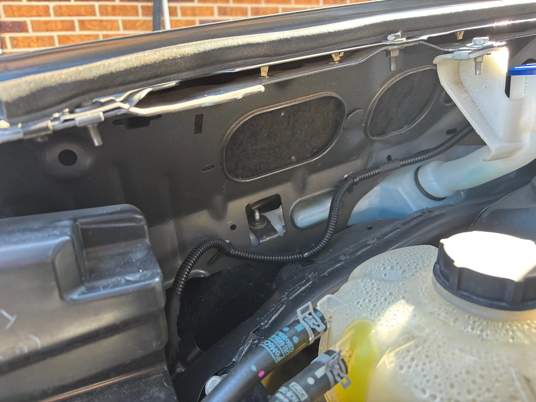

After adding an engine cover, hood liner backed with dynamat, and Bronco Sport cowl insulator it seemed most of the direct injection racket was emanating from the wheel wells and front grill area. I added the fender insulators, an intake manifold insulator from the Ford Edge and additional weather stripping on the sides of the engine bay. Now I would consider the engine noise outside the vehicle to be acceptable.
I also added OEM Thinsulate insulation throughout the interior. Mostly between the dash and firewall. I would say interior sound levels are more than acceptable.
Every step helped but no one addition was a magic bullet.

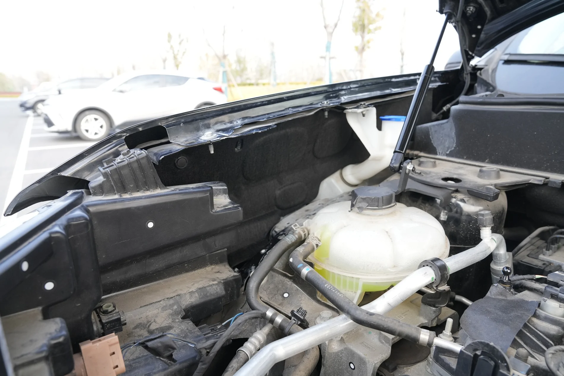

First thing i thought of was it could keep the leaves from falling in the abyss in those parts. It's a pain cleaning those out. I'm assuming you don't have that problem.
Yeah.This is also one of the benefits.

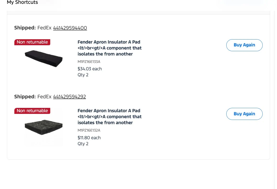

At present, the inventory has been received and the products previously ordered have been shipped and delivered by Amazon.You can check the relevant logistics.

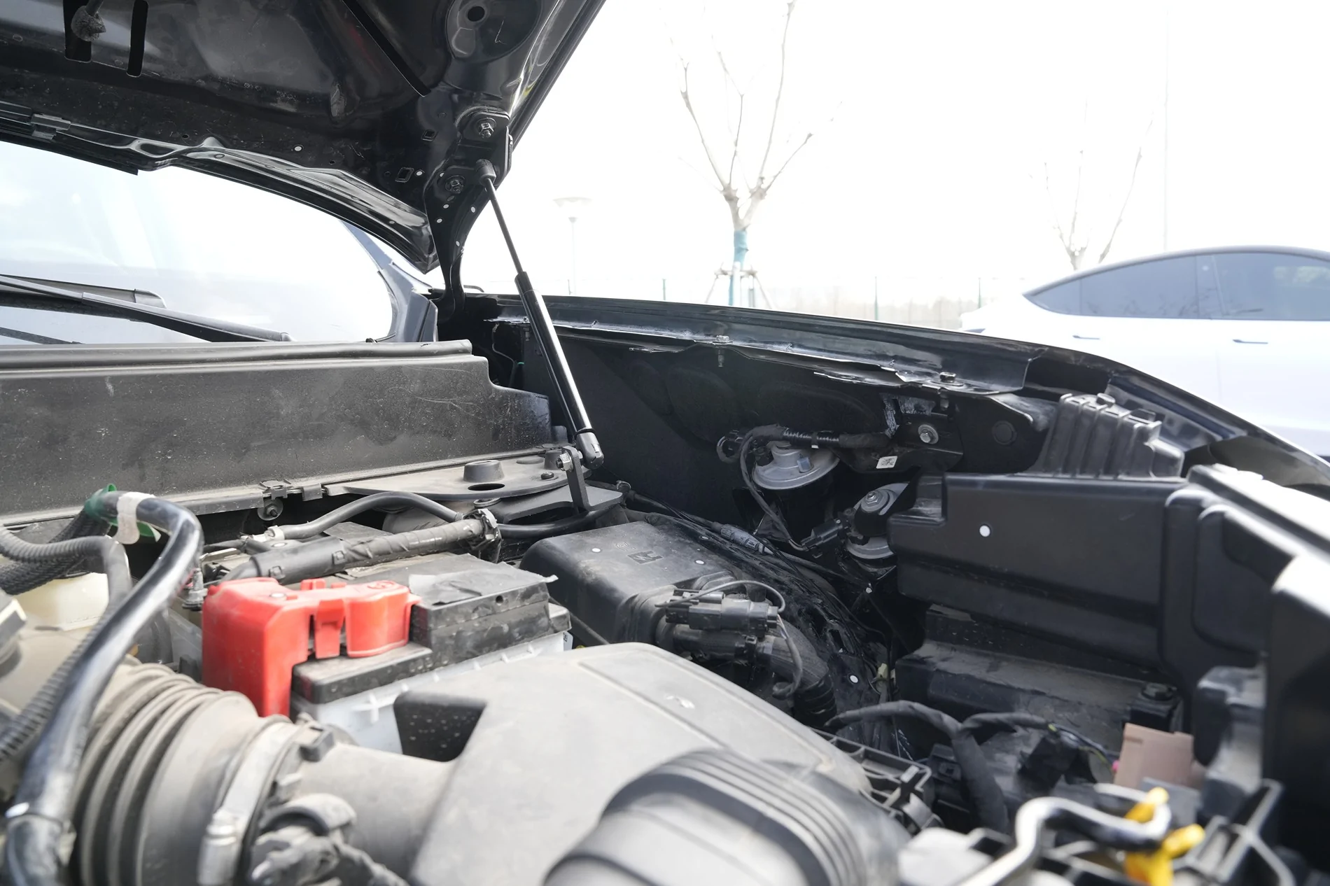

My Ecoboost does not have and will never have a cool looking engine bay like the V-8’s of old.
My days of opening my hood to impress my buddies with a sexy engine is long gone.
So are the days pulling up my wife’s shirt to titty flash my buddies. Back in the day she’d think it funny but now She’d slap the shit outta me !
Still I think the side fenders exposed like they are would look better covered up. As the engine cover that Ford stopped Installing made the whole engine bay look better.
As for heat issues, so what if your thermostat opens 5% more. That is a non issue.
