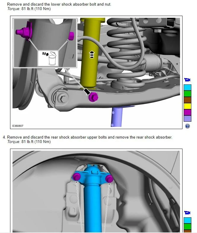

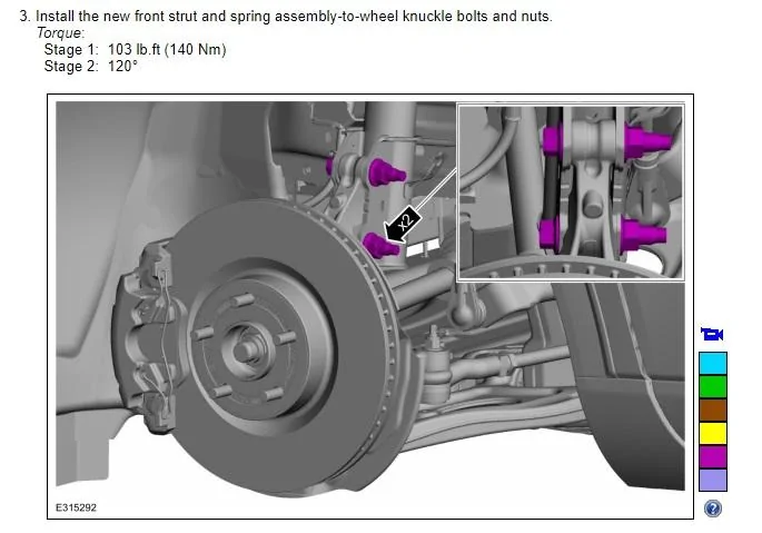

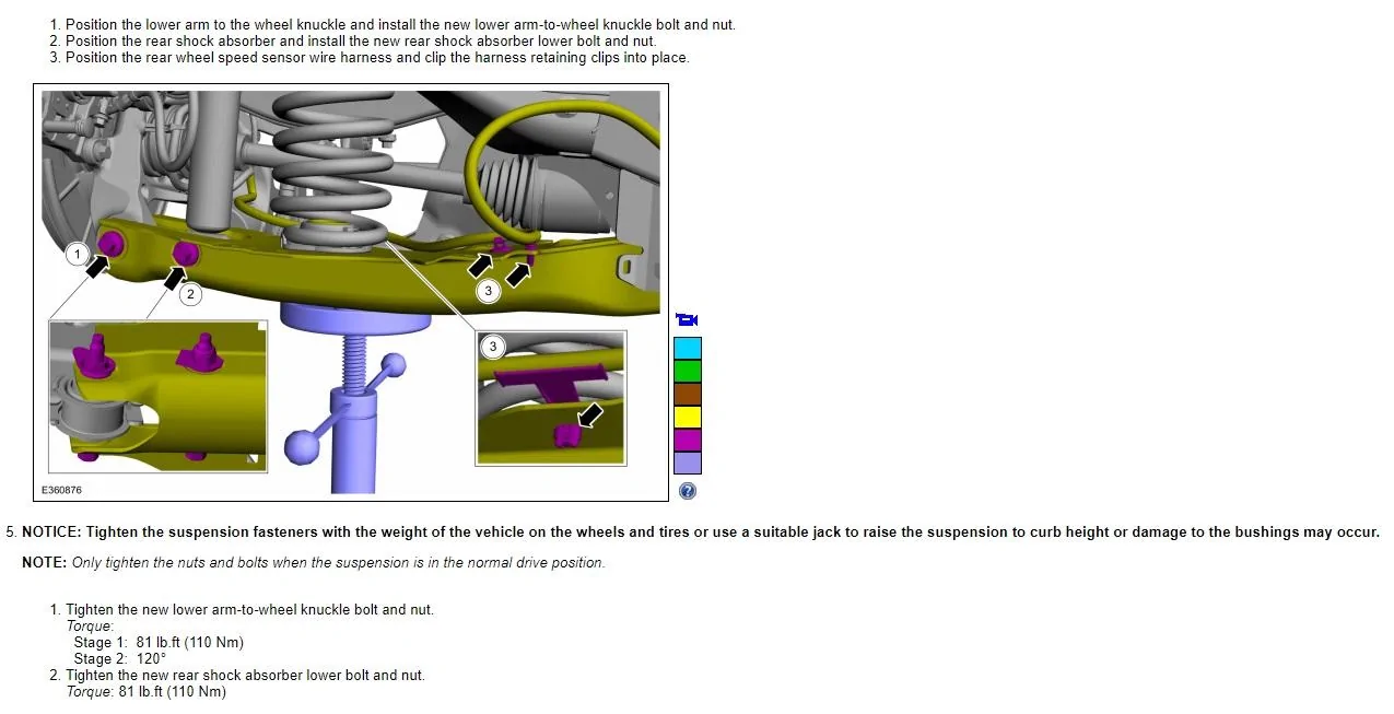

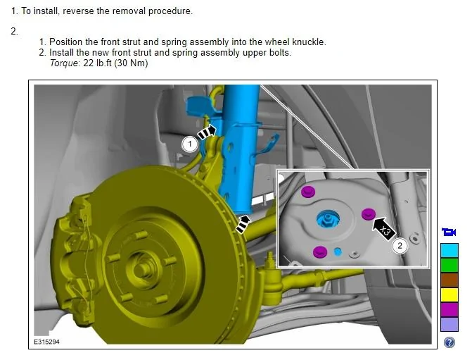

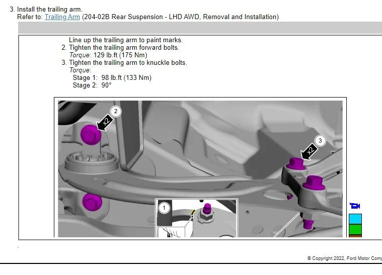

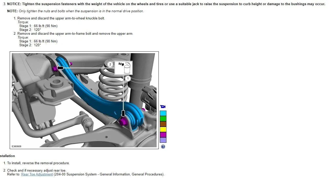

Lift install complete. Absolutely happy with the results.
