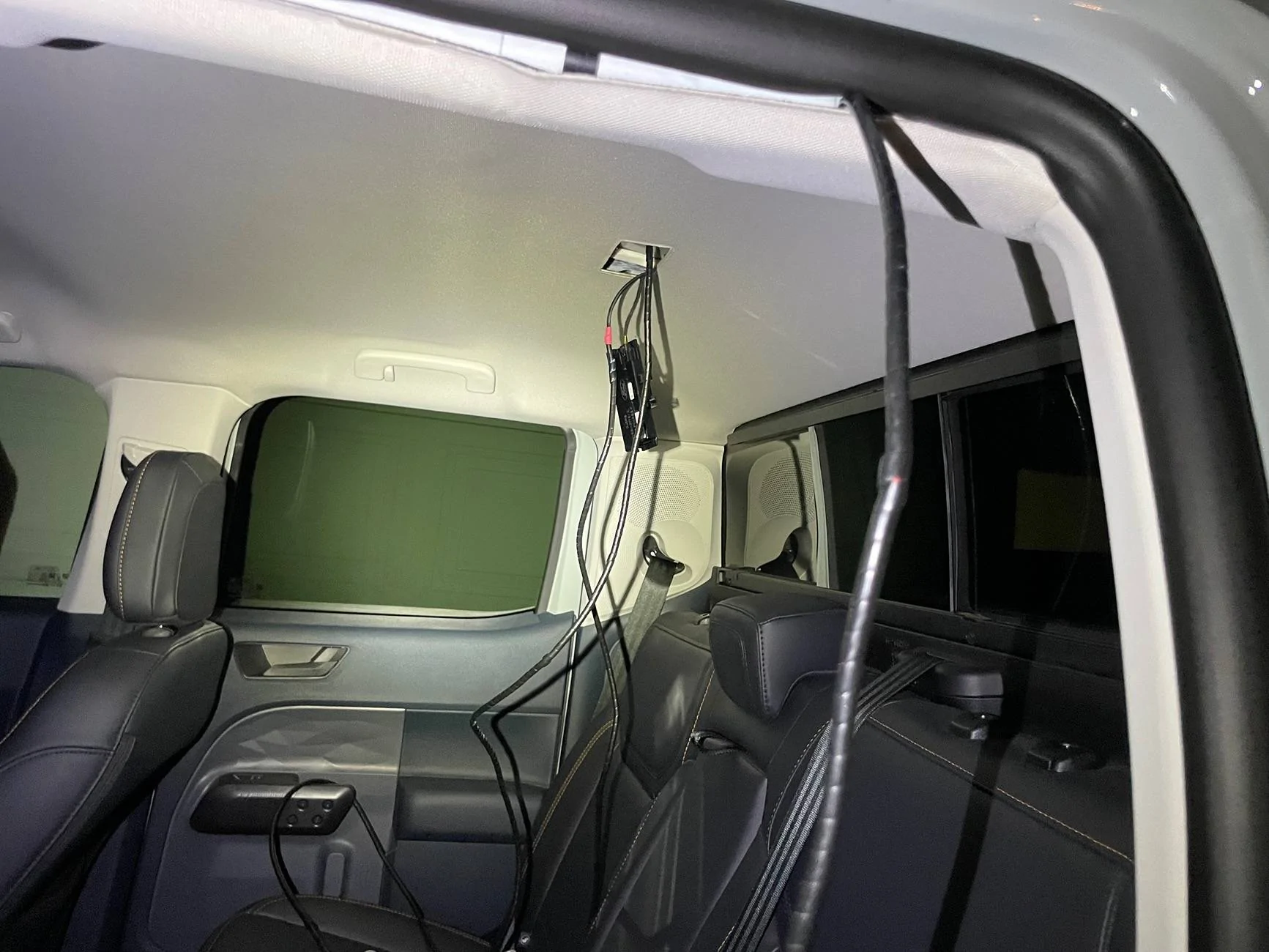

Done. Not fun. But doable. Unplugged the trucks 3rd brake light, plugged in the extension I made through the dome light. Not easy at all, very constricted, have skin rubbed off my rt wrist from the antenna. But it’s done, now since this pic it is across the headliner to the back drivers side piller and down to the back / bottom of the seat. Will rout it to the back once I’m up and going today.
