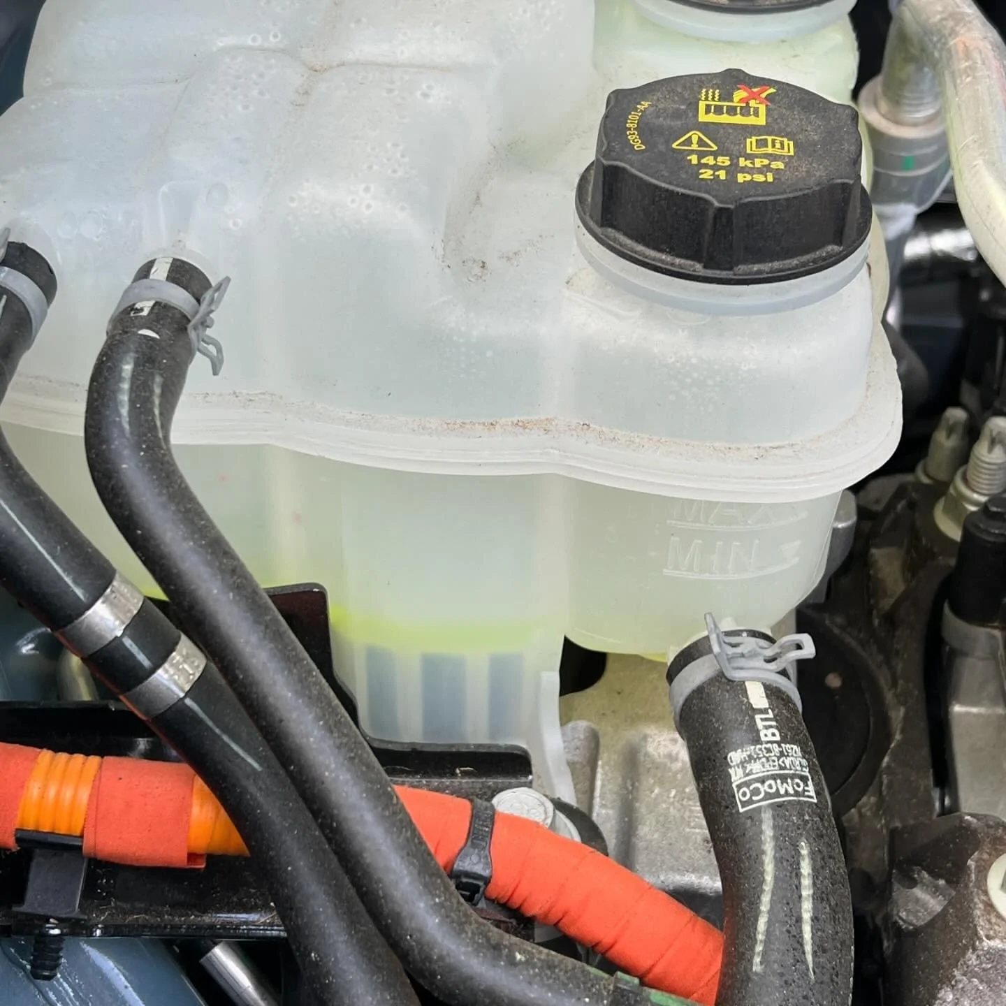

I went to start the car other day and found the check engine light on. I popped the hood and found all the coolant is gone (found some dripping at the front end, guessing a few hoses or something got loose but unsure). I have an appointment in for next week and waiting to tow it into dealer then to give me a rental. For now I'm driving a family members car for a bit.

notice any pooling under truck about where the back of the front seat would be?

Is the Hybrid coolant reservoir (behind the ICE coolant res.) also empty or is it OK? It's not visible in your photo.
There was a slight wet spot at the front end (in 2-3 spots). Front end being the engine. I didn't see anything on the back end.
The rear reservoir has coolant in it with no issues it looks like.
