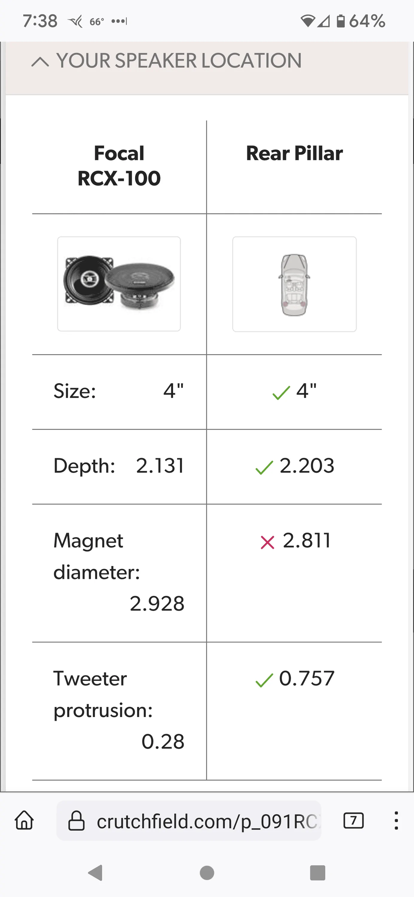

I've seen a few people mention using them but it looks like Crutchfield thinks the magnet is too large, if I'm reading their info correctly.
I'm using the Focal rse165 up front and I believe these are the voice match. And they're in sale so I'm thinking why the heck not. I think people have used 4x6 so surely these really do fit without any real issues ...?

no problems with the depth of the magnet? Crutchfield says it won’t fit. I’d prefer going focals though..
I didn't have any problems with them. I used the standard adapters like this for the rear pillar speakers and the tweeters. They are available from other brands. These fit, you just have to line up the contacts and pay attention to the polarity.
