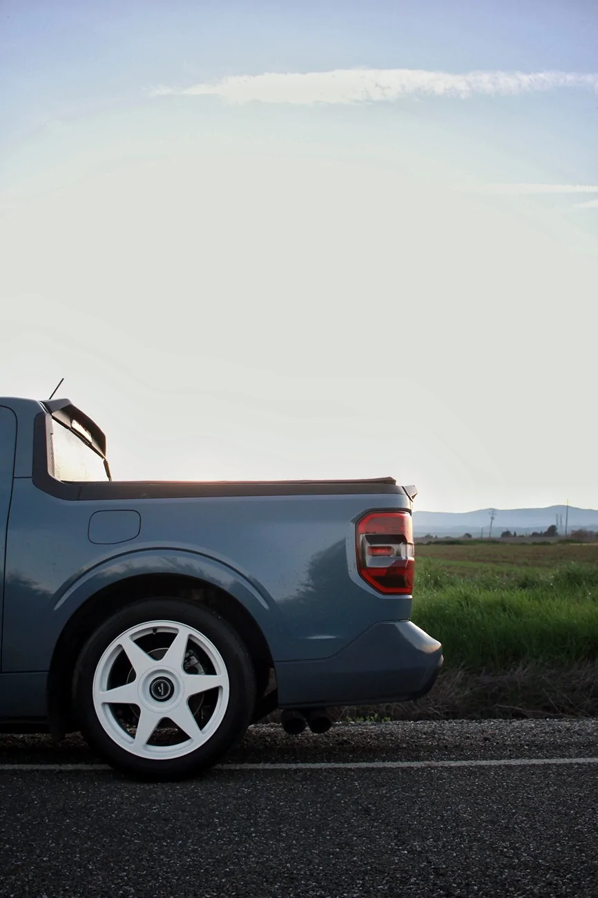

Another install! This time, for what I believe is my first-ever full bolt-on exhaust system that I purchased. All my other exhausts on any other vehicle I've owned have been fully custom lol. So I was intrigued as to how this would go, and I'm happy to say that it went well. It came with the options of either a side-exit or rear-exit tailpipe. I went with the side because it flowed better with the truck IMO.
Ford Maverick Flowmaster American Thunder Exhaust Install Video IMG_7717
This sytem came with really good instructions. So good in fact, that I finished the install alone in just a little over an hour on jack stands! The video is to help visualize the instructions a little more. It sounds great too! Reminds me of my Focus STedan exhaust that I had which was a nice deep tone on the low end with a nice rasp on the top end!
For the price VS other exhausts on the market, I'm very happy with how easy the install was and how the final product came out! Cheers!
