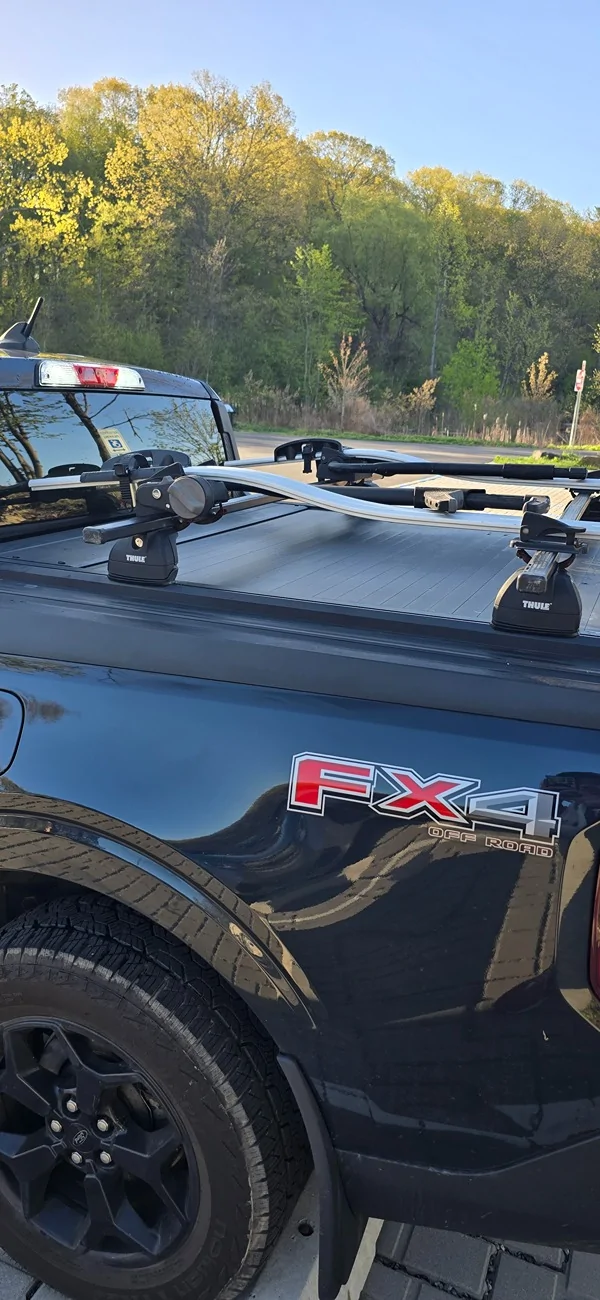

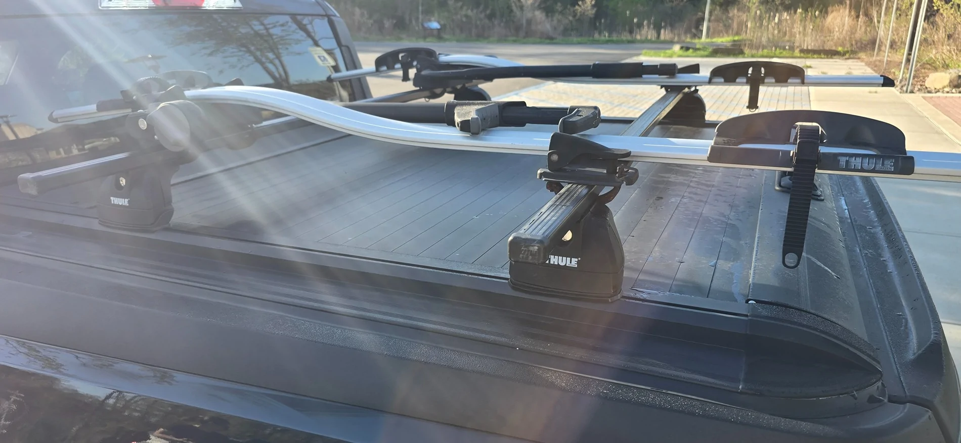

I went with the thule rapid podium towers with square bars but you can go with whatever style bar you want. You need the older style landing pads for T tracks kit#3101 for the rapid podiums. They have a new style tower that just came out earlier this year ( can't recall the model), that uses different landing pads kit#7201, but they looked to fit funky on the flowtoku when I checked them out. So if you can snag the older ones on eBay that's my recommendation.
This is obviously for a low profile install, I use it for my pro ride bike mounts or a cargo box. If you want roof height cross bars there's a few other options.

Thanks...do you you by chance have any pics of your install...low profile is what I want

Sure rhing. I've been happy with them. Rock solid, I just would use some anti seize on the hardware or get some stainless replacements if you are in a rust prone area like me.
Ford Maverick Flowkottu tonneau cover..best cross racks? 20260427_073323
Ford Maverick Flowkottu tonneau cover..best cross racks? 20260427_073319

Looks great..I may go this way. I have a Thule cartop carrier I hope to attach to haul stuff for a month in FLA
