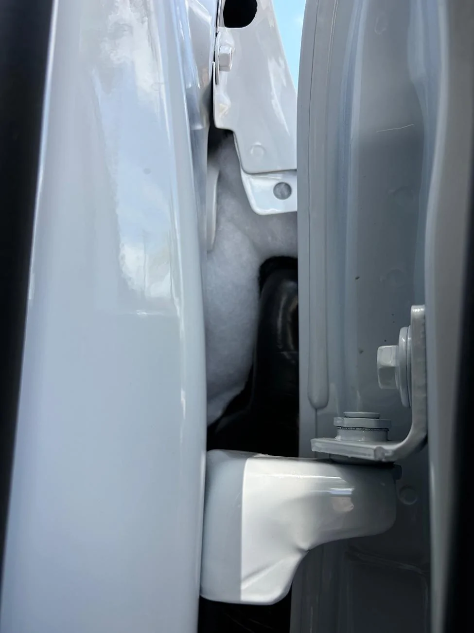

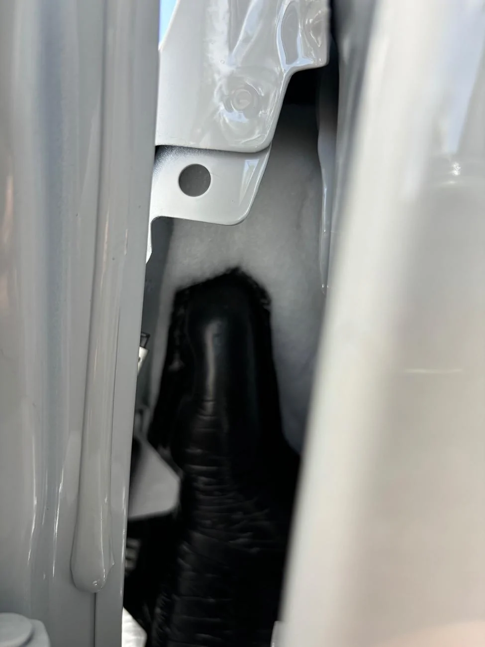

I believe the post below shows the area between the outer fender and the inner fender where the insulation is. I hope this helps.

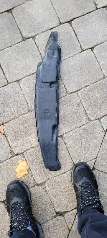

These pics show the foam block, the empty cavity between the driver's door and the A pillar and the passenger side with the foam block in place
Ford Maverick Flapping noise at high speed 20241113_155831
The foam block that came loose and was laying on top of the inner fender beside the battery

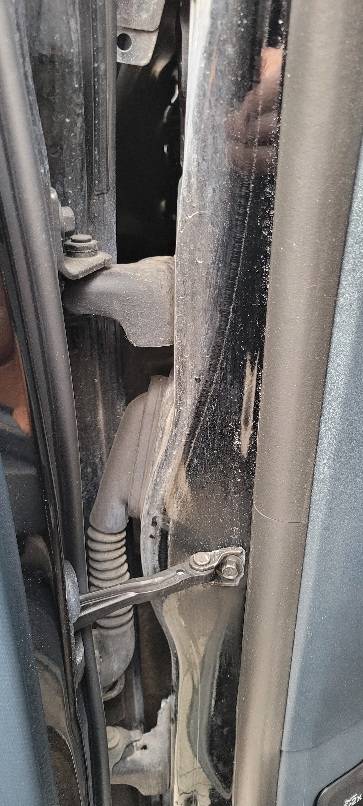

This is the driver's door side where the foam block sits
Ford Maverick Flapping noise at high speed 20241113_155912
