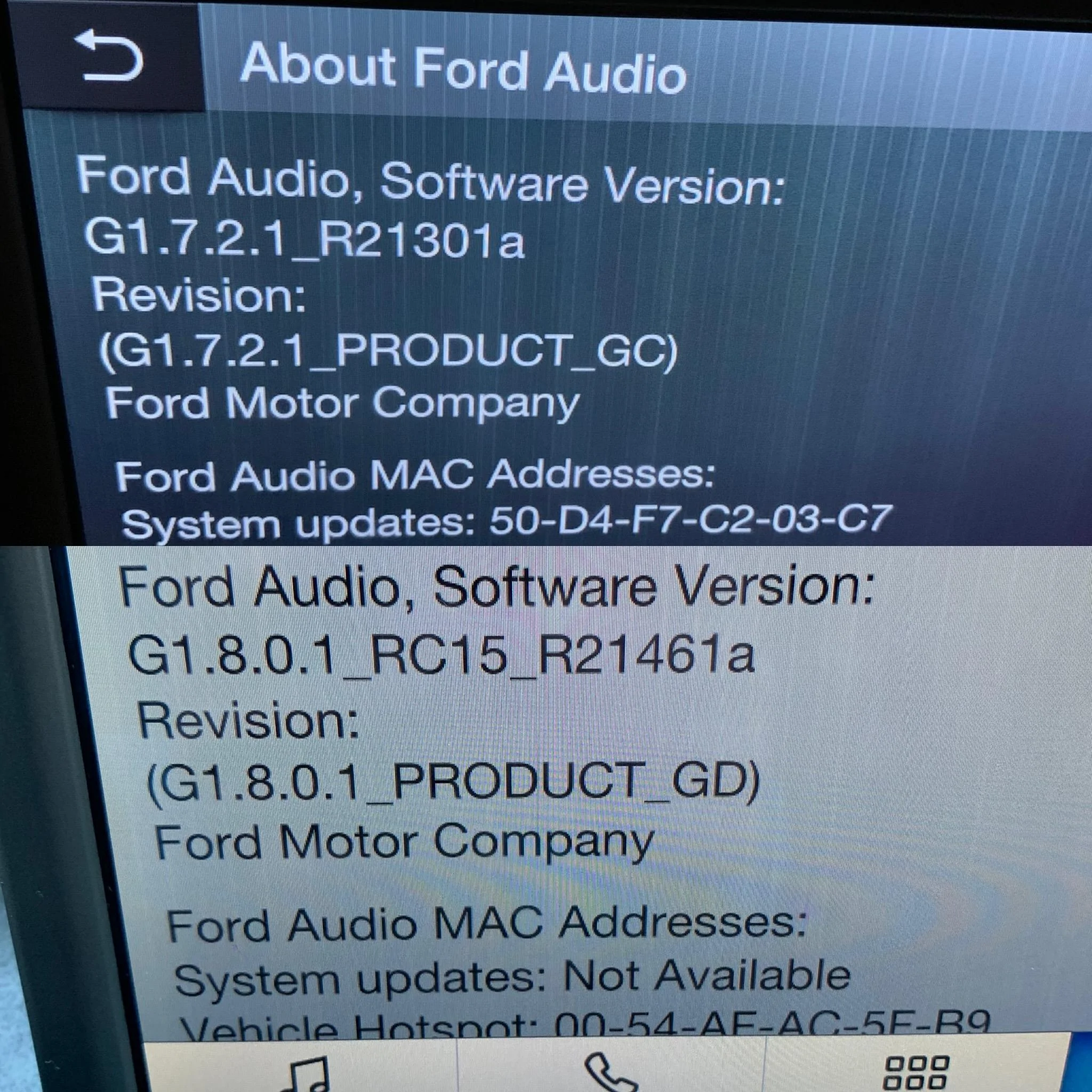

The glitchy radio can be fixed by your dealer with SSM 50411. This will update the ACM, updating the radio firmware.
