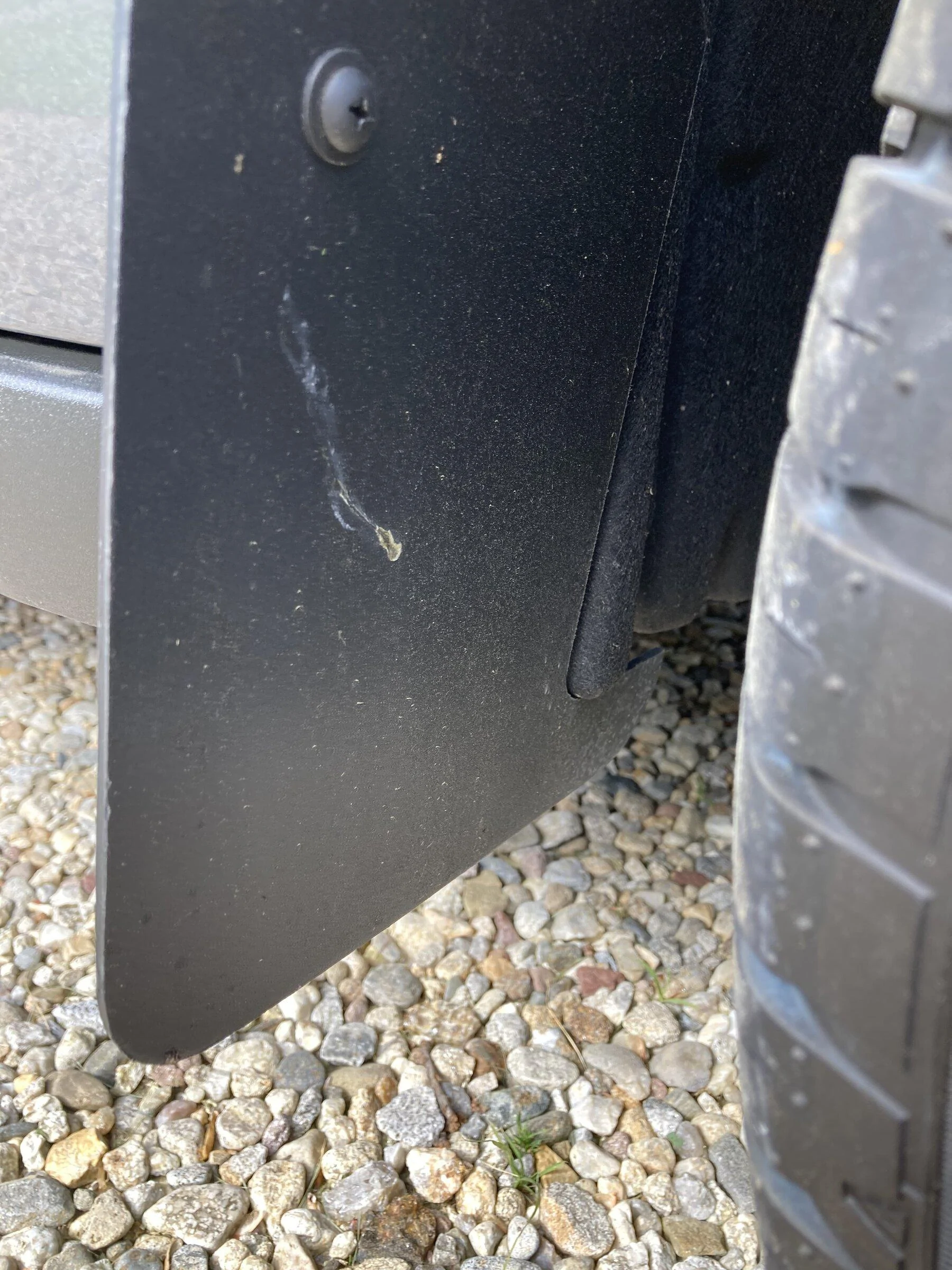

I work at a body shop so I have a endless supply of stuff but I used nylon nuts like these so they do not rust
Amazon.com: OAUTOO 20PCS Fender Liner Splash Shield Nylon U-Nut for 90179-05060 Toyota & Lexus,Screw Size #10, : Automotive
and screws like this, you need to get the right length which is the tricky part the rear lower one was a little longer than expected, I tried to reuse the screw I took out of the bottom hole in the rear but is just a little too short. The other positions I took out the plastic retainers and used the nylon u nuts and screws

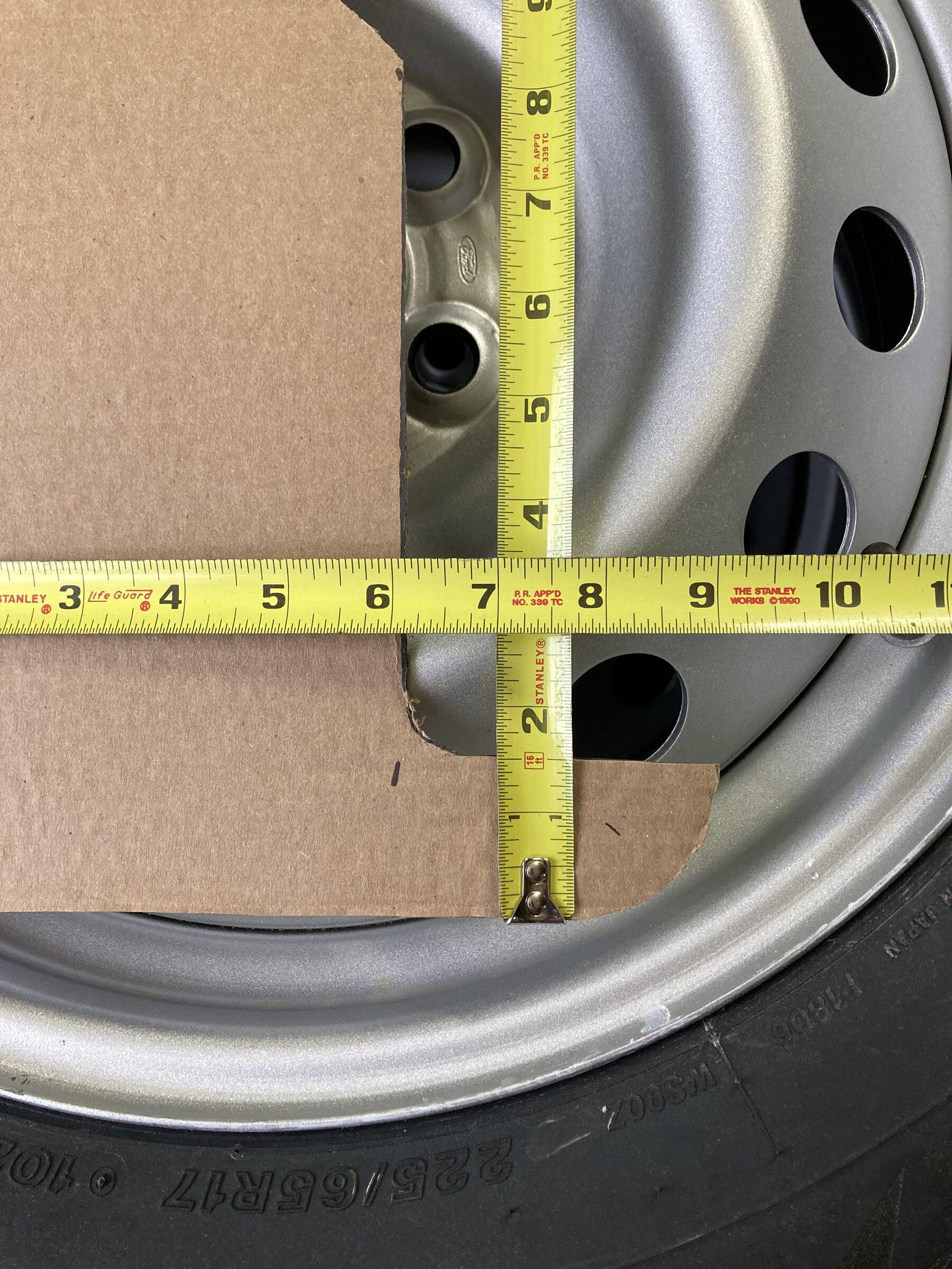

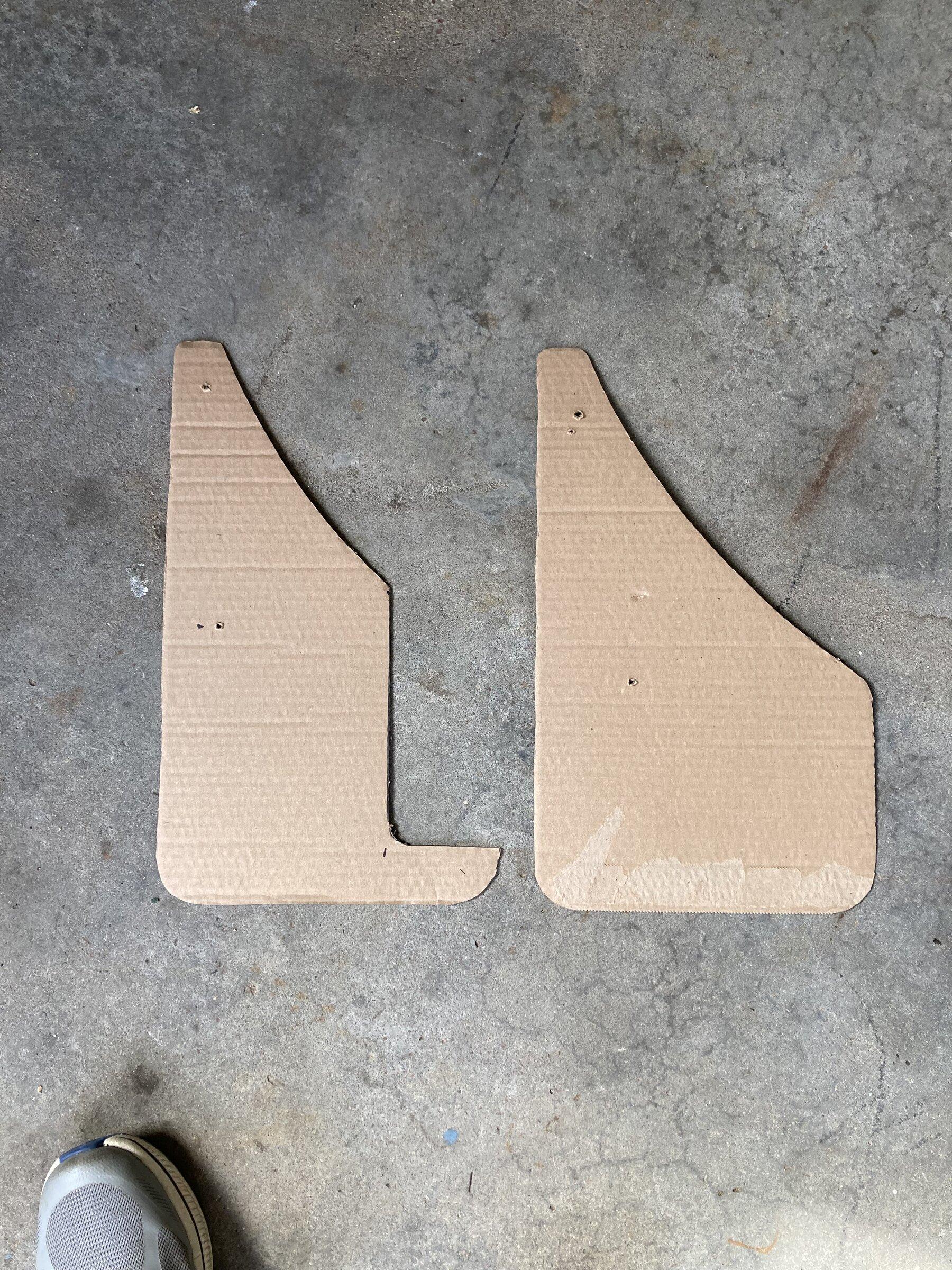

Can you share some of the dimensions of the cardboard one on the left. The width of the main vertical cut.

I made cardboard templates the cut the plastic guards. The hardest part was hardware. I did tuck the felt front skirts behind the metal fender so the front flaps fit more flush. It did take an afternoon to get them just right but for $30 it was worth it. They don't actually have the etrailer logo either

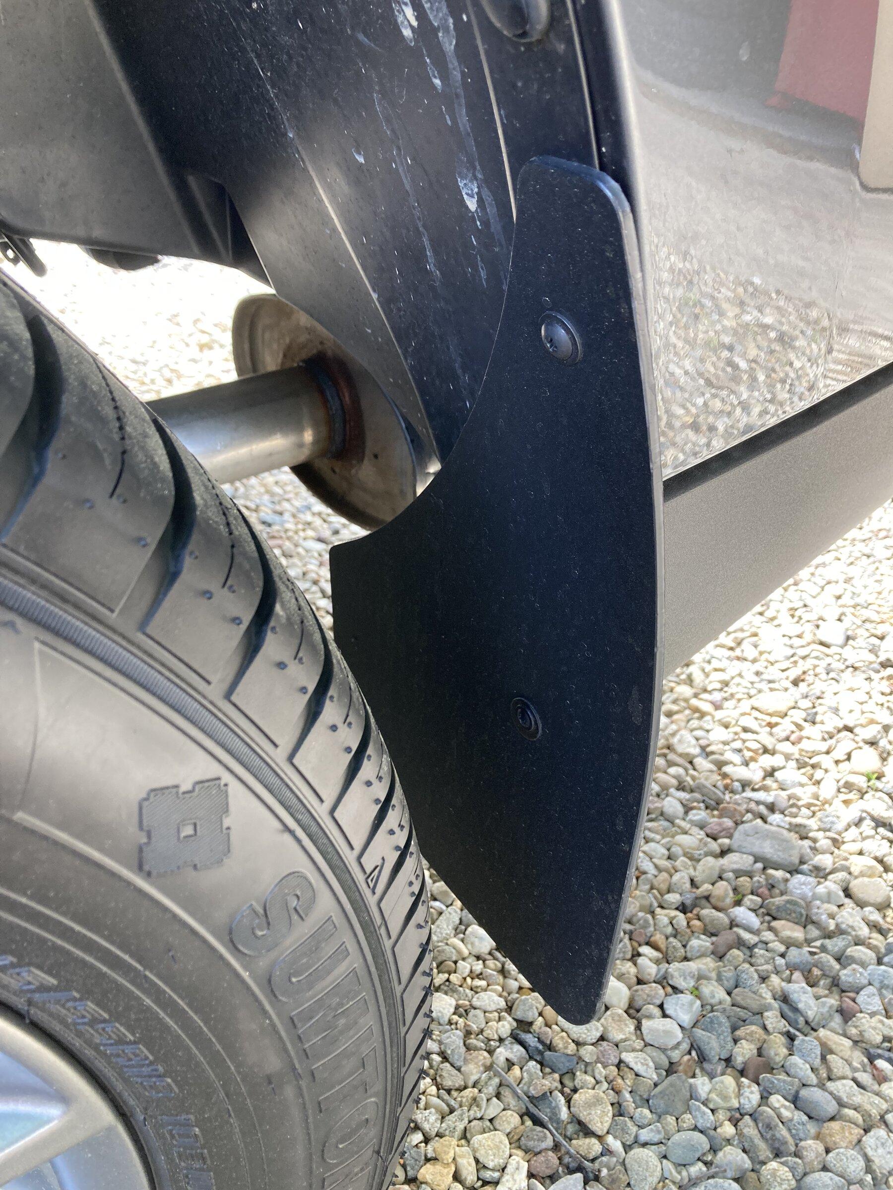

I cant assure you those are the correct sizes of u nuts and screw in the links but that is the idea of what you can use. You might need to put a piece of tape on u nut to keep it from falling into fender while you attach the mud flap.

I appreciate the measurements. Thanks!
