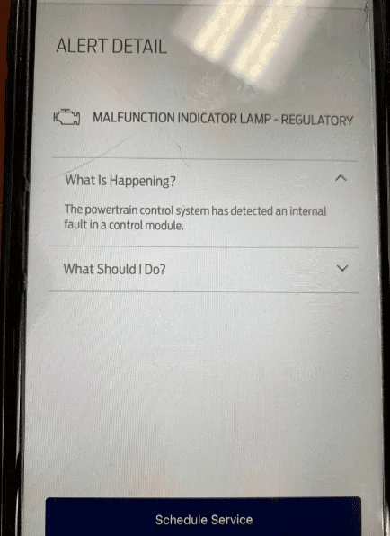

Has anyone received this alert for their Hybrid?
I went to start it for work this AM and it was completely dead. I was able to jump start per the manual but immediately got this alert.
Ford Maverick Error Message on FordPass: Malfunction Indicator Lamp - Regulatory Alert
Error
Hi there! Would you send us a private message with your VIN and dealership name and location? I’d like to look into this concern on my end.

That's what happened to my Maverick when it died. Yours must be affected by the wire harness issue or the software glitch issue causing it to die.

When was your Maverick built? Sounds like they need to replace the battery wire. https://www.oemfordpartscheap.com/p...ery-Cable-Positive/119664100/LX6Z14290PA.html
It’s a Nov build, turns out it was the Ford Pass app, they replaced the battery and downloaded new software and still dead. Guy called me and said remove truck from the app. They kept it over the weekend and it was fine. The app was over communicating with the truck draining the battery. All is good so far. I also turned off the trucks Wi-Fi
