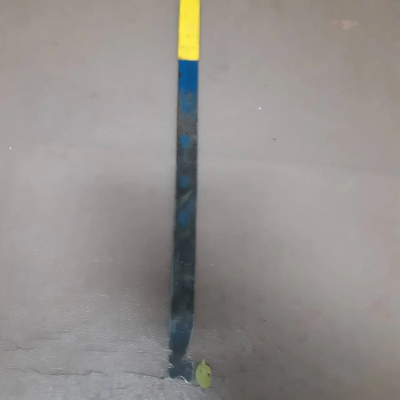

What made us hop on the 'electronic' path when it could be a mechanical, "slim-jim" path? Maybe there's a 'known-amongst-thieves' vulnerability in the passenger door that allows a slim-jim to be used without damage?

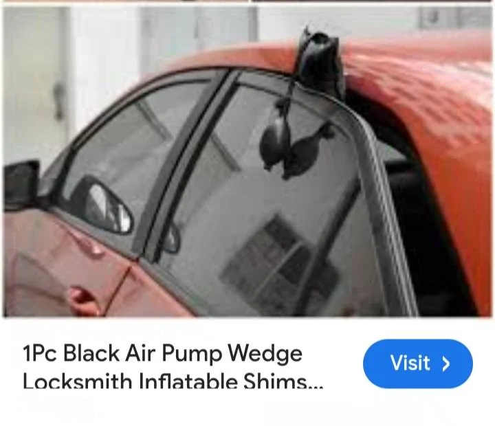

You can buy the airbag at Harbor Freight for $17
Or less than $40 online for the set.
