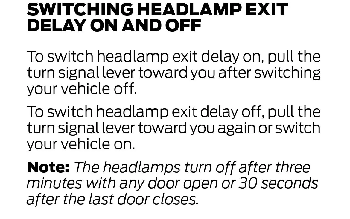

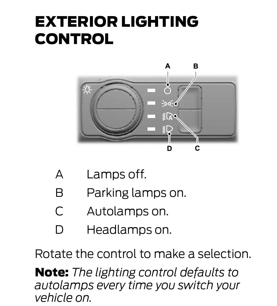

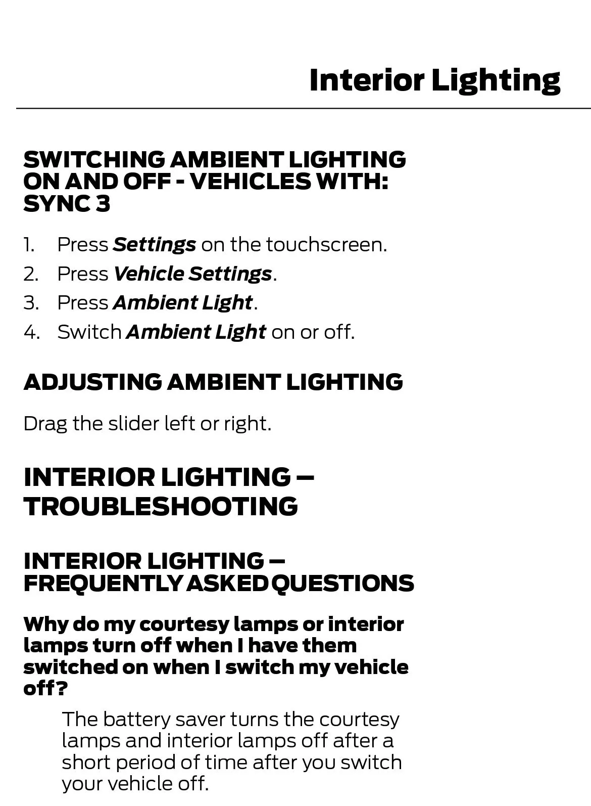

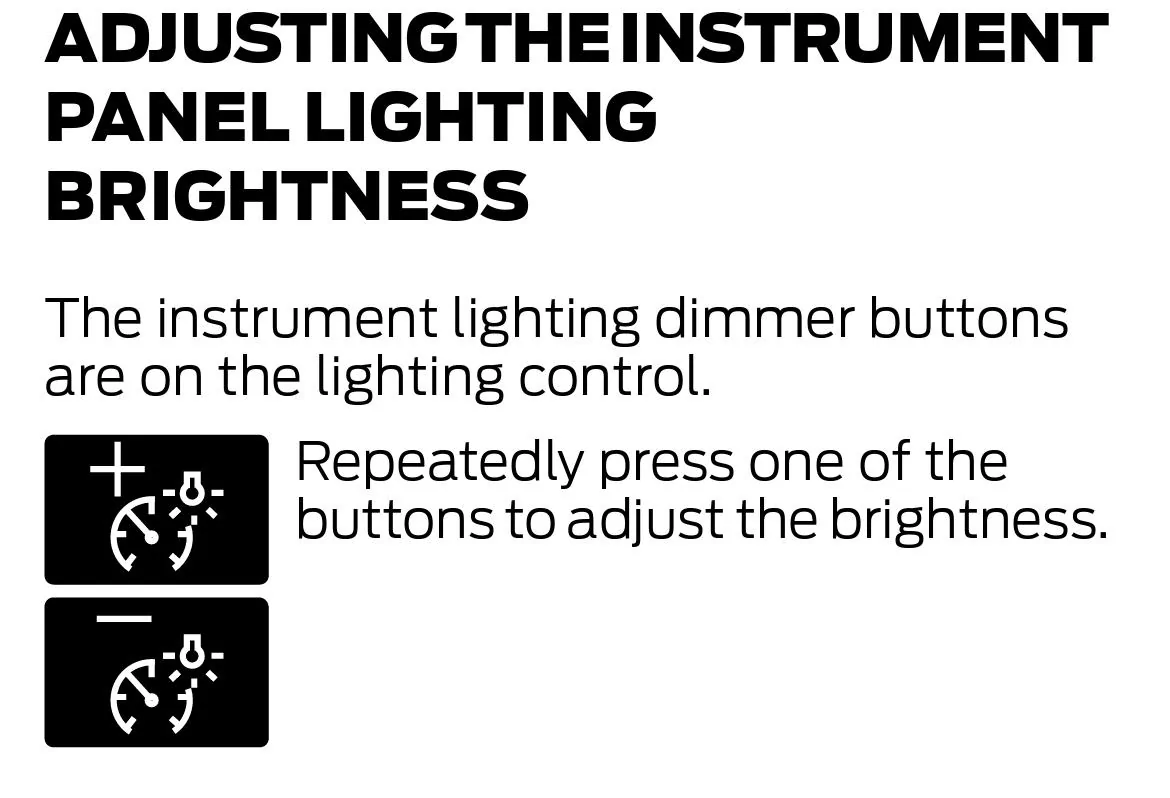

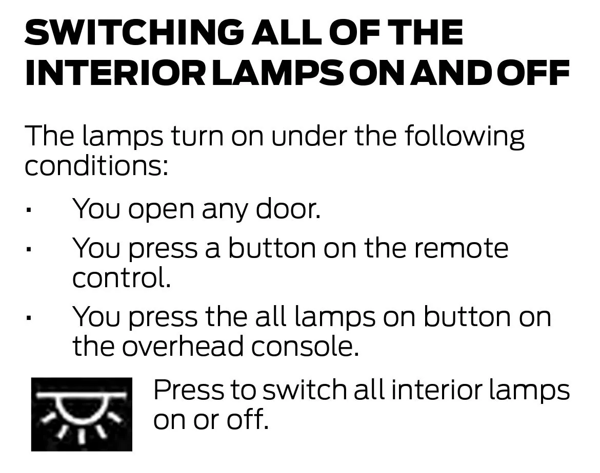

Since I don’t have my Hybrid I can’t recreate the issue but here are some snippets from the manual. They may provide some assistance. Since you could recreate it and you said it was by design, I’m wondering if given proper time they will all shut off. I didn’t see an explanation in the manual of what your explained.

I had a similar issue yesterday. After turning off my 2022 Lariat Hybrid and opening the Driver door, the door chimes continued and the exterior lights stayed on for an extended time. The radio would turn off, but if I pushed the on button without restarting the engine it would start playing. The truck eventually shut down. After reading the above post I checked the headlight switch and noticed I did not have any LED indicators lights on. Turned the knob to automatic lights and LED indicator turn on and my issues were corrected

Turning the headlights to on and back to auto fixed it for some reason.
