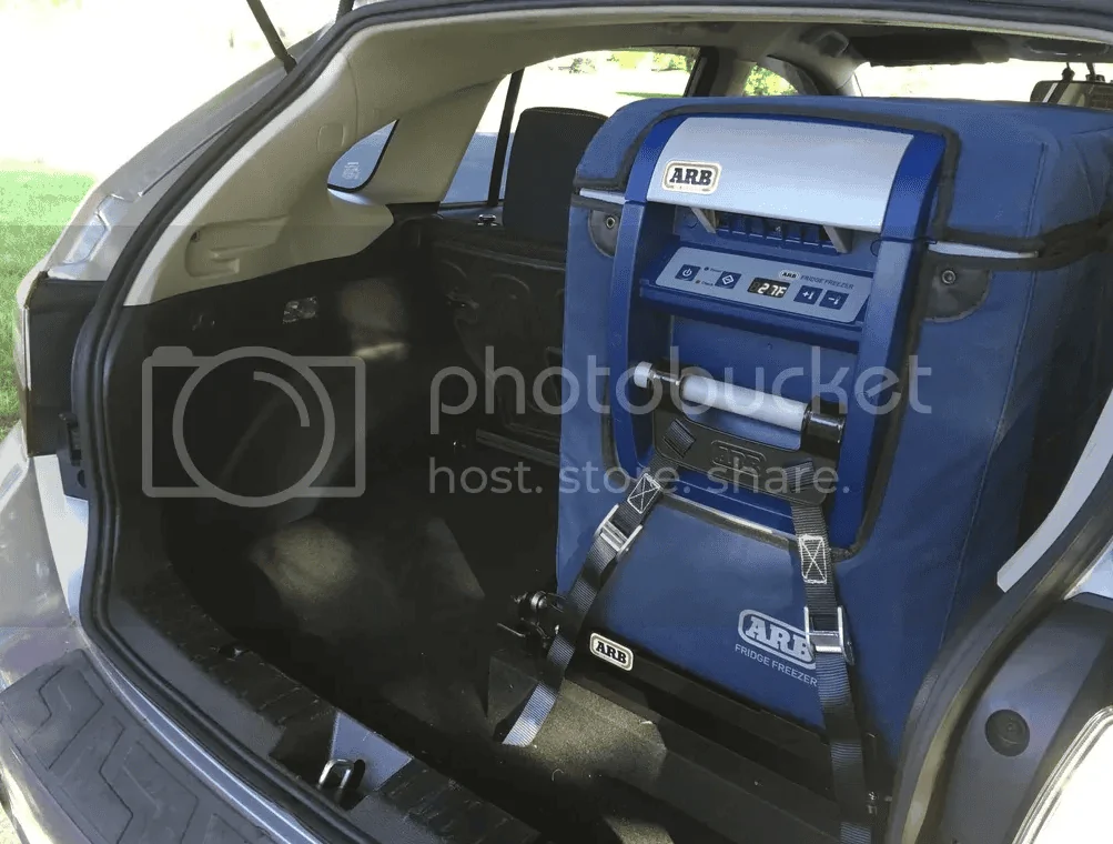

If you want something of quality, stick with the offerings from ARB, Dometic, or Engel. I had an ARB 50QT in the back of my Subaru Crosstrek.
Ford Maverick Electric Cooler for Maverick Screenshot 2021-08-03 095351
