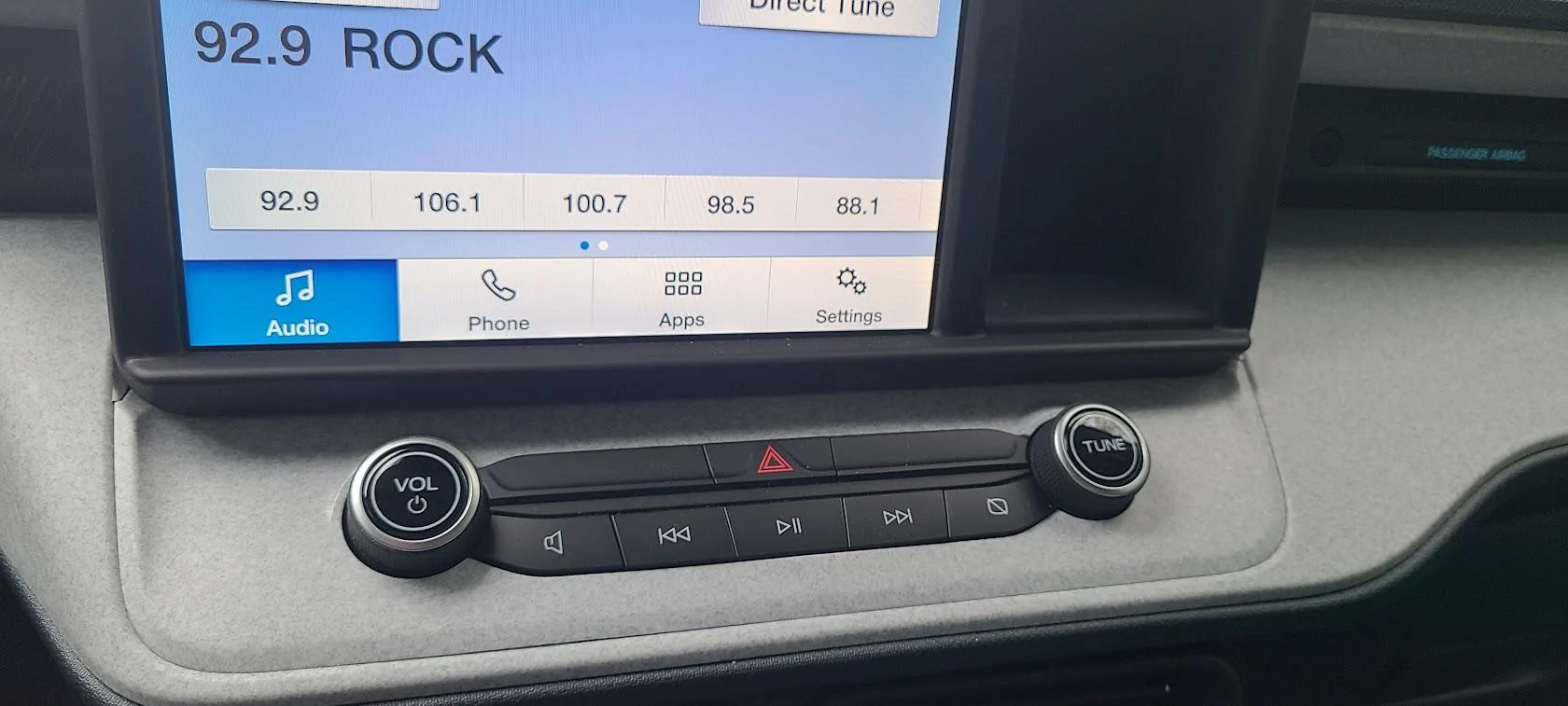

SavvyMavi Member First Name Ann Joined Nov 2, 2023 Threads 2 Messages 15 Reaction score 23 Location Palmetto, FL Vehicle(s) Ford Maverick Lariat Engine 2.5L Hybrid Clubs Apr 23, 2024 #17 Cyberwiz64 said: The other day I had to reboot the display console because it wouldn’t react. Hold the power button and next track for a few seconds. Also lost Bluetooth connection on many occasions. Click to expand... Thank you for this! Just did this and problem fixed!
mcgarveyjb Well-known member First Name Jim Joined Feb 15, 2022 Threads 2 Messages 160 Reaction score 215 Location Wisconsin Vehicle(s) 2022 Maverick Hybrid XLT W/Lux and spray in Engine 2.5L Hybrid Apr 23, 2024 #18 This usually happens to mine when automatic updates are being installed. Clears up after. Sponsored
