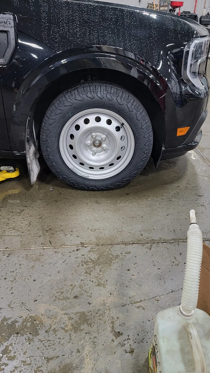

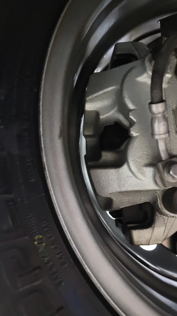

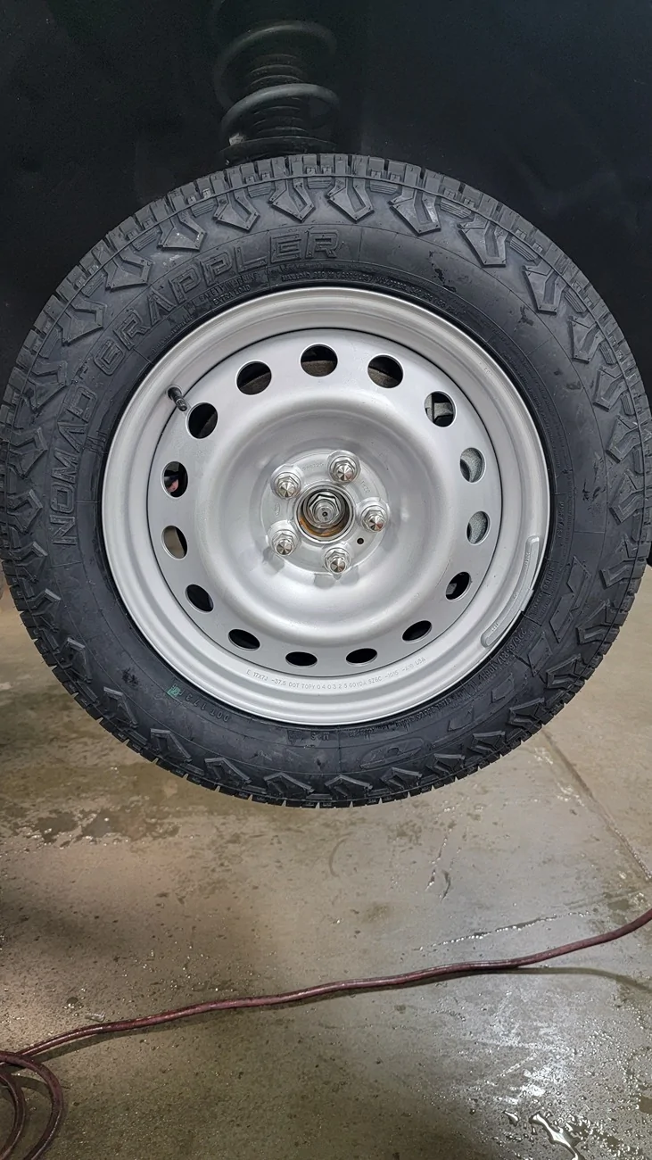

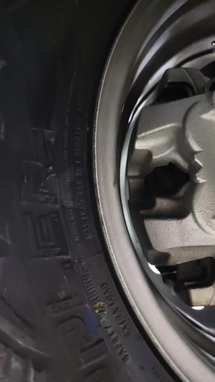

I have 17 steel rims that fit my LOBO.
The front calipers are close to the wheel but there is clearance.
if you are buying aluminum wheels be sure to test fit them before installing the tires.

I have 17's on my Lobo with similar clearance.
General rule is 3mm minimum clearance.
That's a little less than 1/8".
As one of the guys I work with said, "clearance is clearance" lmao

I missed out on the 17in set I was originally looking at, and ended up finding a great deal on some 19s with almost new Michelin Xice, for my winter set. By the looks of the pics above, the caliper is too close for my liking. I added Brembos to my mustang and they are very close to the wheels, like the pics above, and small stones get caught between the caliper and the wheel and have scarred up the wheels pretty good. Probably not an issue if your always on good roads, but my county has a lot of those chip seal roads.
