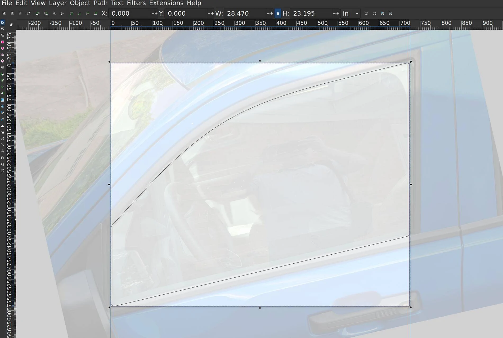

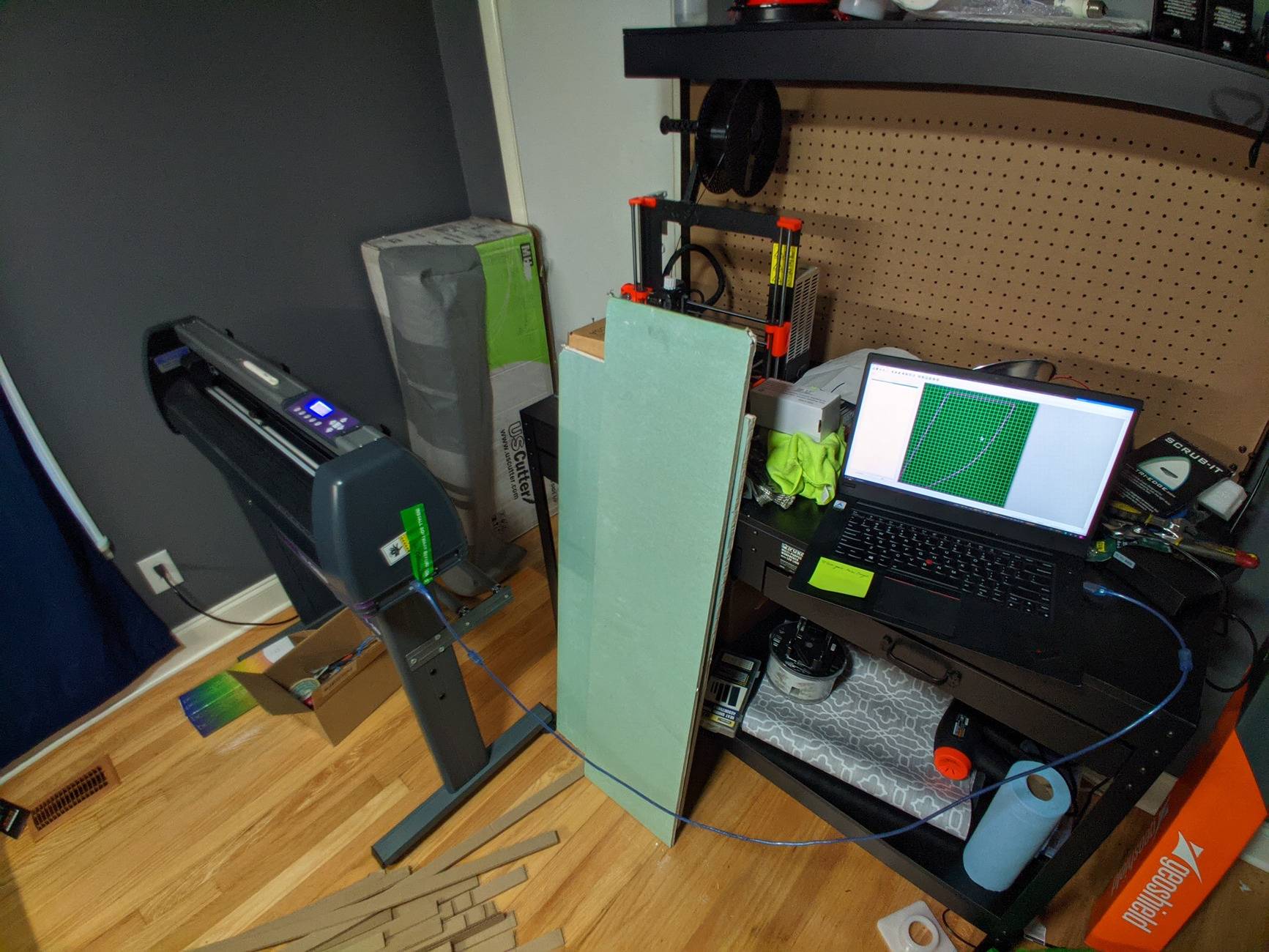

Started by taking a picture of the front window and tracing it out in Inkscape.
Ford Maverick DIY ceramic front window tint 2025-06-11_19-37
Then used a vinyl cutter to try and cut out the outline. Worked OK, but I didn't spend enough time tuning the blade to cut all the way through.

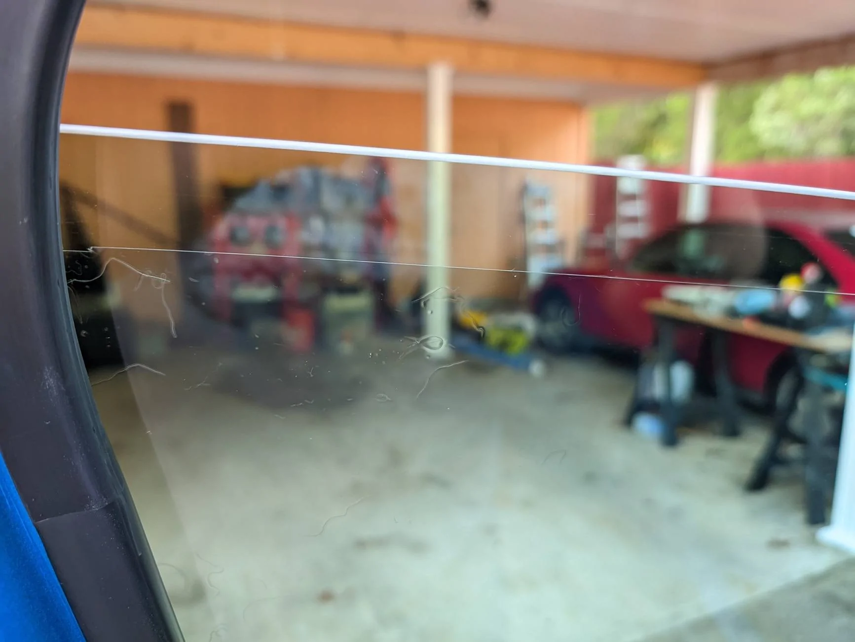

Finished product is OK. I think I'm going to rock it for a while and then re-do it to try and keep the #@$%$@ cat hair out...

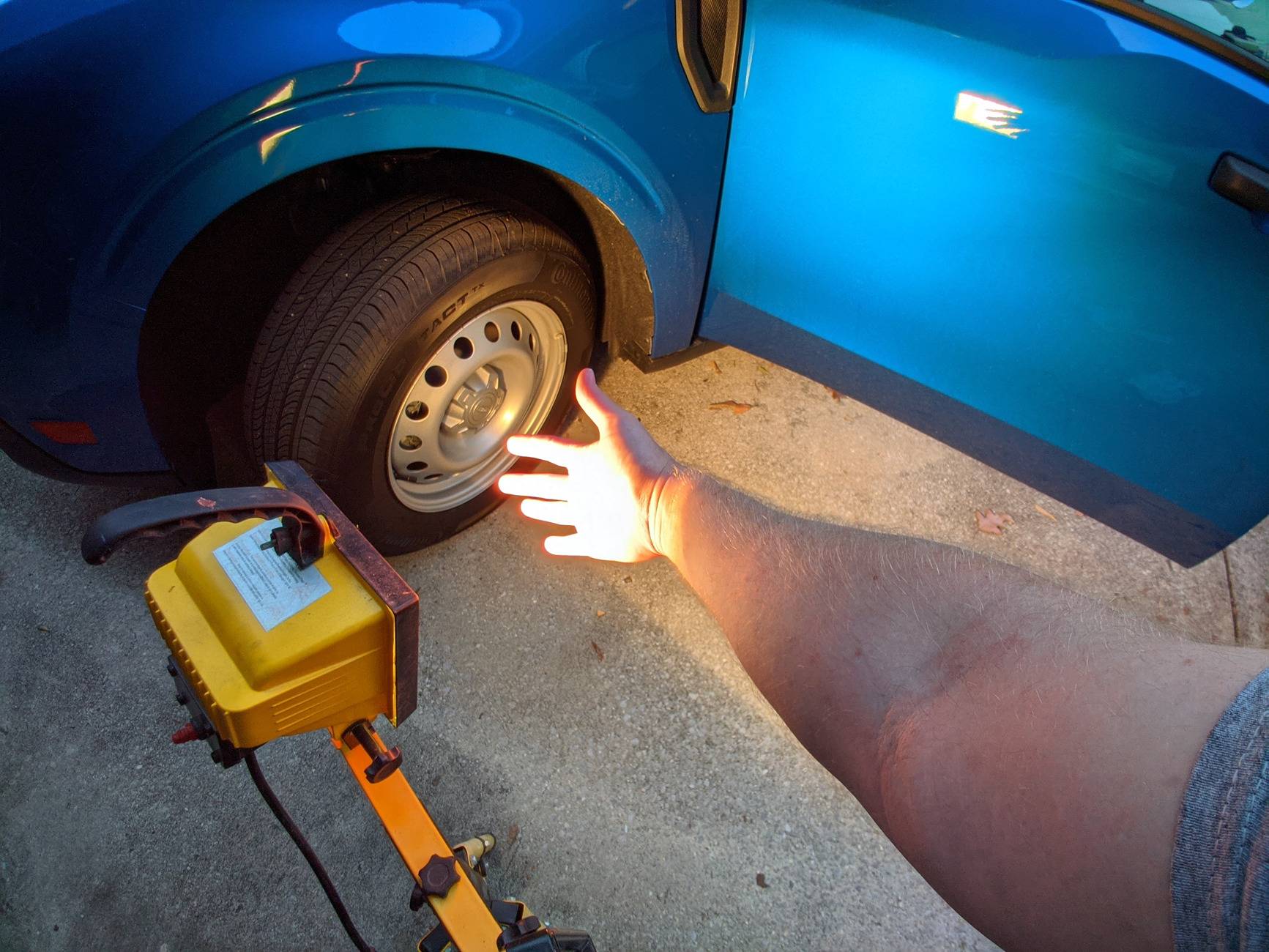

And just to see if this ceramic tint is all it's cracked up to be, I got a halogen light. Held the lamp up with my hand behind the newly tinted window, and then moved the lamp and hand over to the windscreen and could feel a pretty large increase in the amount of heat coming through. The tint works!

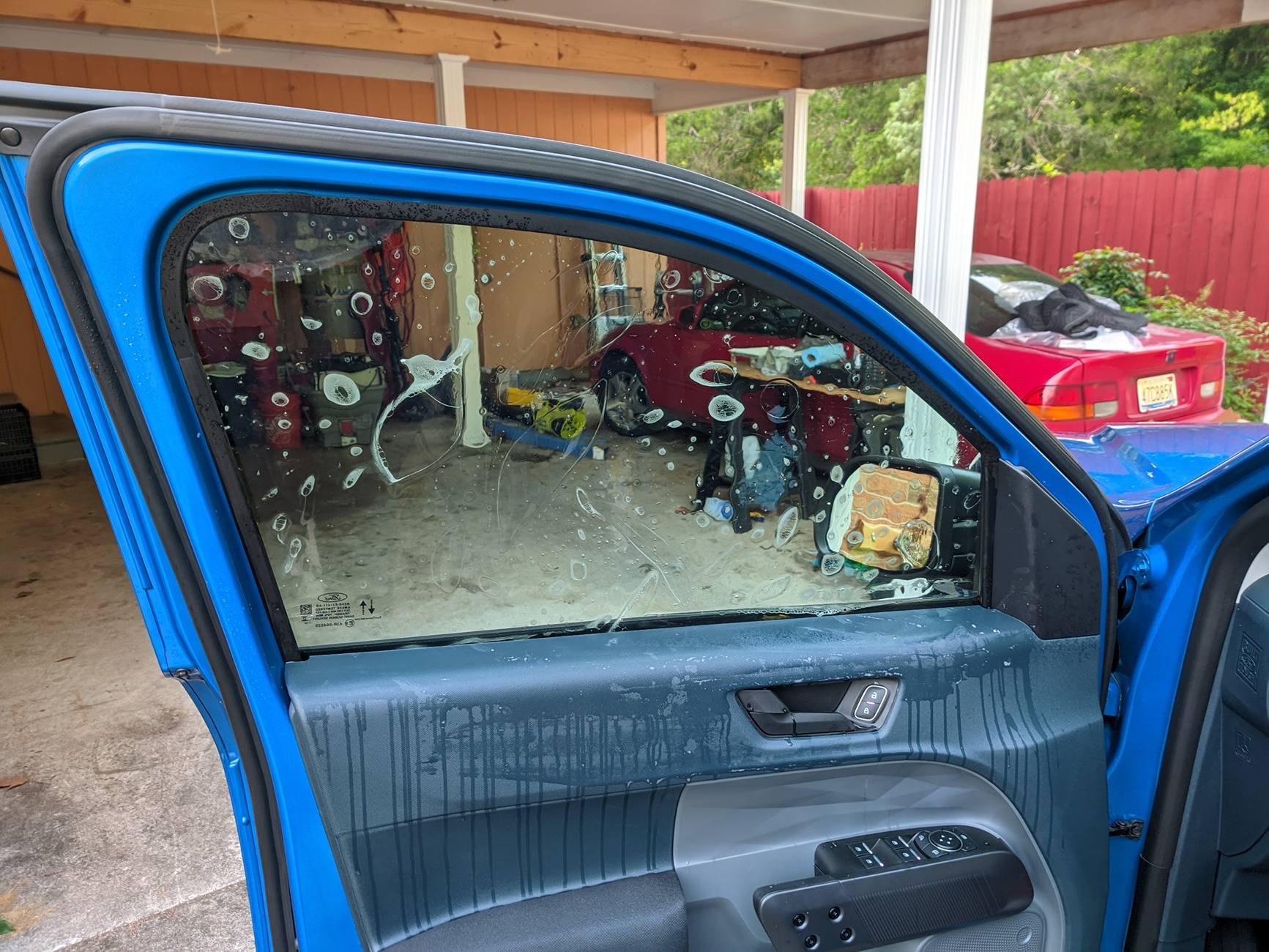

Did the passenger side front window yesterday. Came out much better.
I'm including the SVG here in case anyone else cares to use it.

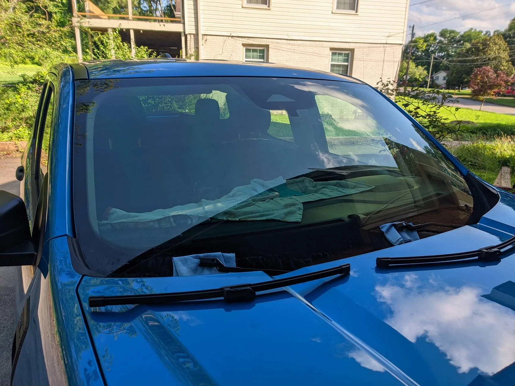

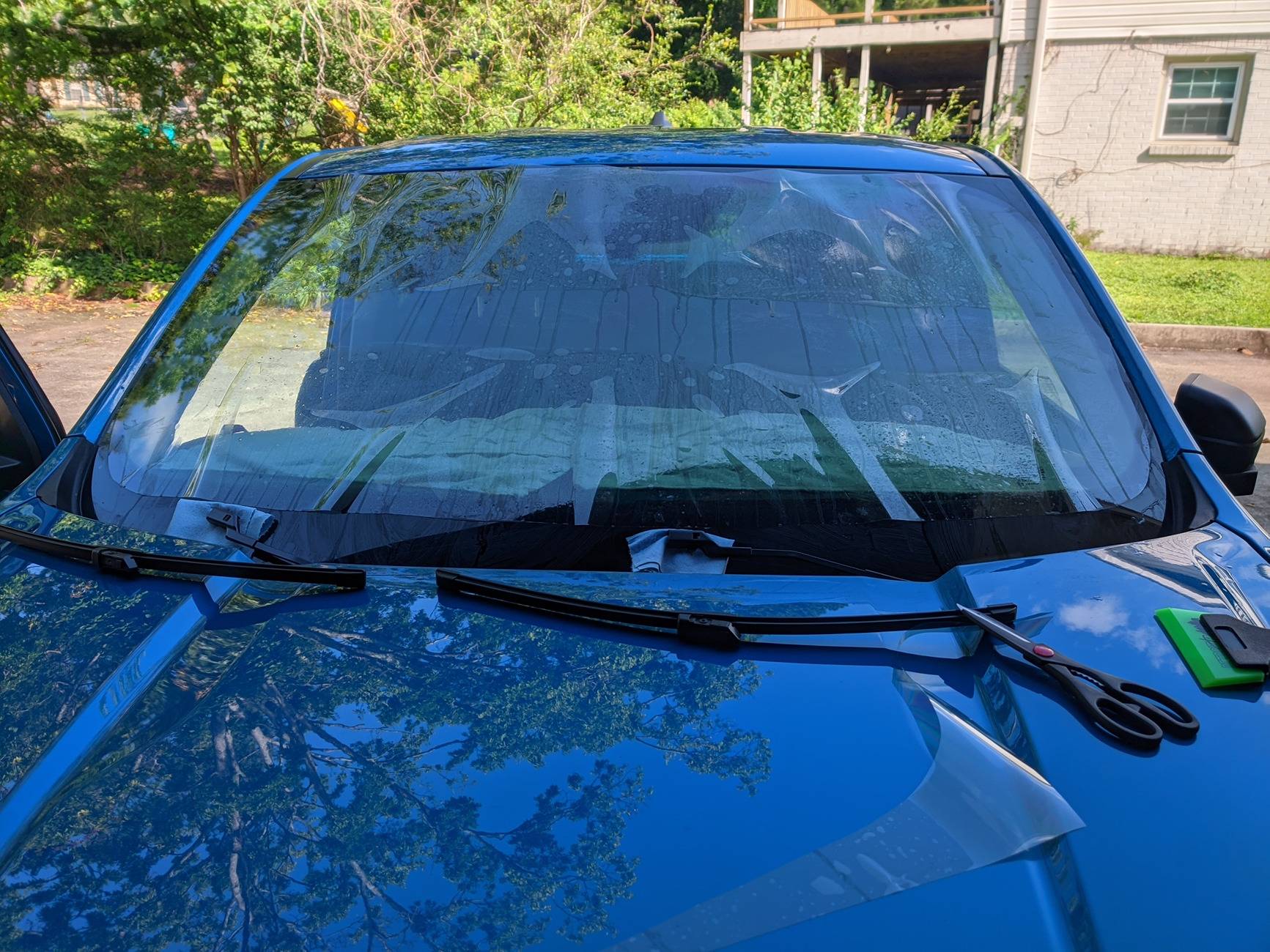

Did the windshield free hand. Wound up needing to be shrunk to fit, which left some wrinkles.

Did you put the tint on the outside of the windshield?
No, I place it upside-down on the outside to cut it to size and shrink it to fit the window's curve, then I peel the backing off and install it on the interior of the window.
