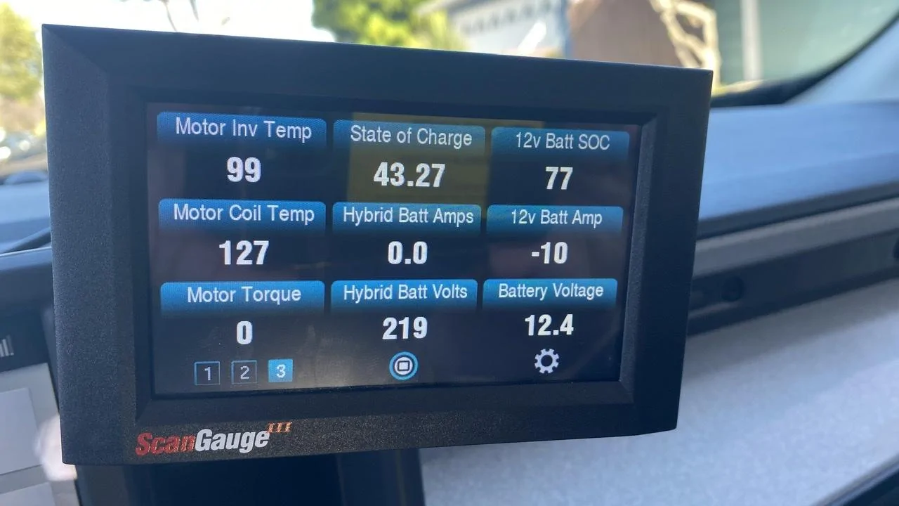

I did a test on flat ground. I put mine in Neutral Tow and looked at my ScanGauge.
ScanGauge / OBDII bus stays powered up. But goes to sleep after a few minutes, but it is easy to wake up an unlimited number of times.
The infotainment screen and radio stays powered on but goes to sleep after a few, maybe 10 minutes, but is easy to wake up an unlimited number of times. Pressing a radio button wakes it back up. Opening the driver door wakes it up as well as the scan gauge. I swear unbuckling the driver seat belt wakes it up, but may have been a coincidence. It did once, but I couldn't repeat.
5 amps was coming out of the 12v battery during my 36 minute test, which I think is quite a lot. I could turn on all the exterior lamps, and 20 amps was coming out of the 12v battery. Lights on and brake pedal pressed, 29 amps coming out of the 12 volt battery.
During my 36 minute test, nothing came out of the HV battery.
Entered Neutral Tow Mode 5:35 pm
HV battery 219v @ 43.27% charged
12v battery 12.4v @ 77% charged
Ended Experiment 6:11 pm
HV battery 219v @ 43.21% charged
12v battery 11.6v @ 68% charged
Data from OBDII CAN bus, as self reported by the vehicle, not independently tested.
You cannot remove the key, and I did not want to go to dinner and leave the truck in Neutral with keys in it.
I wonder, if at some lower threshold of 12v voltage or percent charge would the DC/DC kick on?
That was a big 12v drop for 36 minutes. But I did play with the radio, ScanGauge, headlamps, and brake pedal during this time. Once I heard some kind of pump running, but it was only for about 10 seconds.
Start 5:35 pm
Ford Maverick different battery problem E0A03AA4-8A8D-480D-8F5D-456A02CA5522
Shows 10 amps coming out of the 12v battery but parking lamps and radio was on. With parking lamps off, 12v Batt Amp was -5 which is still a lot. That's 60 watts.

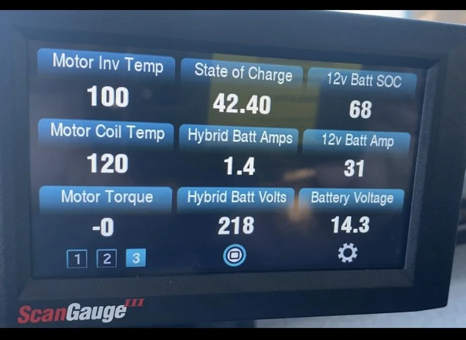

To end this mode you have to turn the key to run, but not actually start the truck. At this moment the DC/DC converter clicked on, and started putting 30 amps INTO the 12v battery at 14.3 volts.
36 minutes later just after turning the key to "on" (not started).
Ford Maverick different battery problem A1B128A2-A438-406F-AF22-357881749D6B
Don't be confused: for whatever reason amps out of the HV battery are positive and amps out of the 12v battery are negative. 🤷🏻‍♂️
