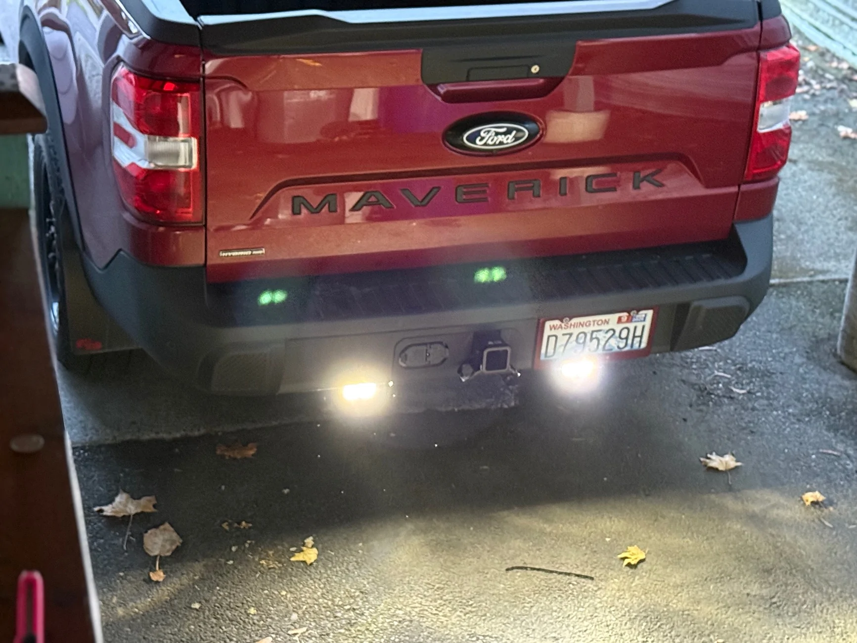

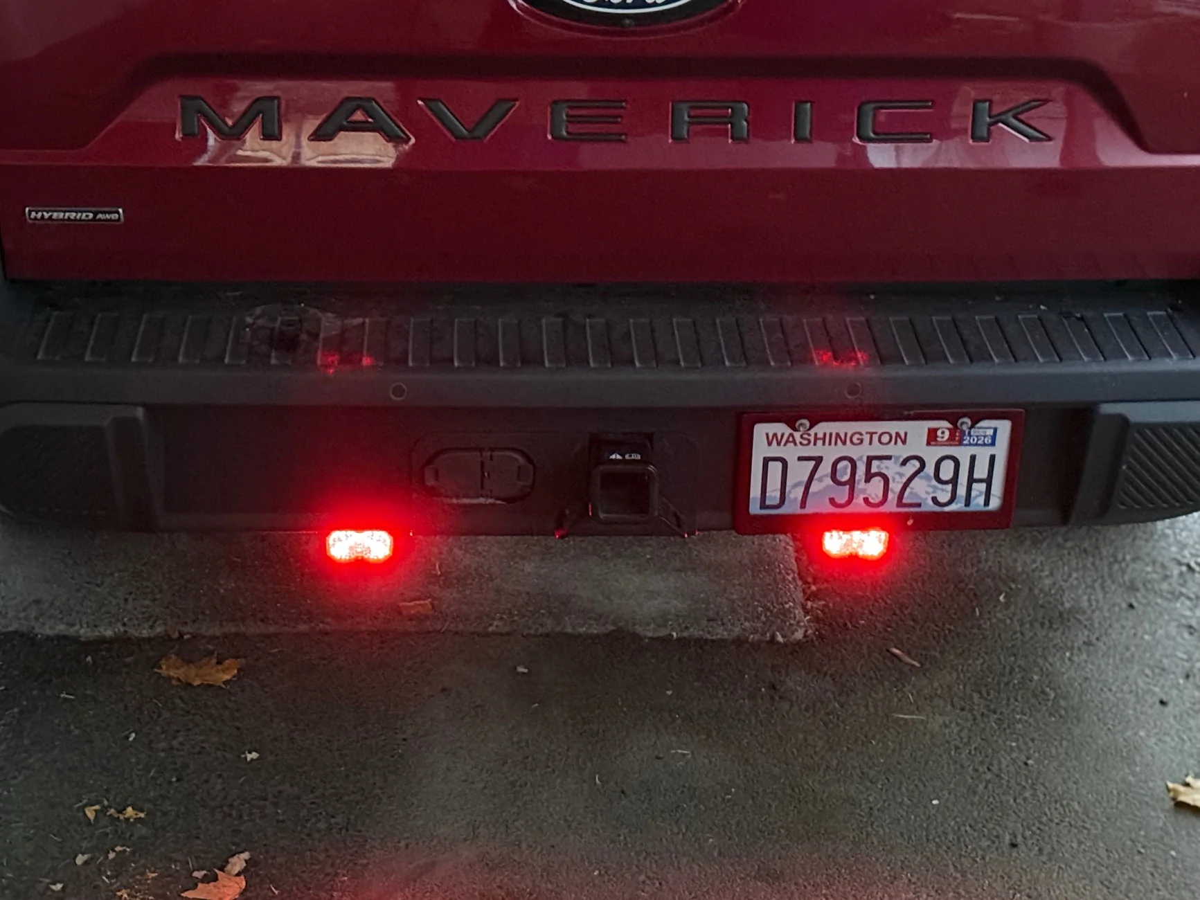

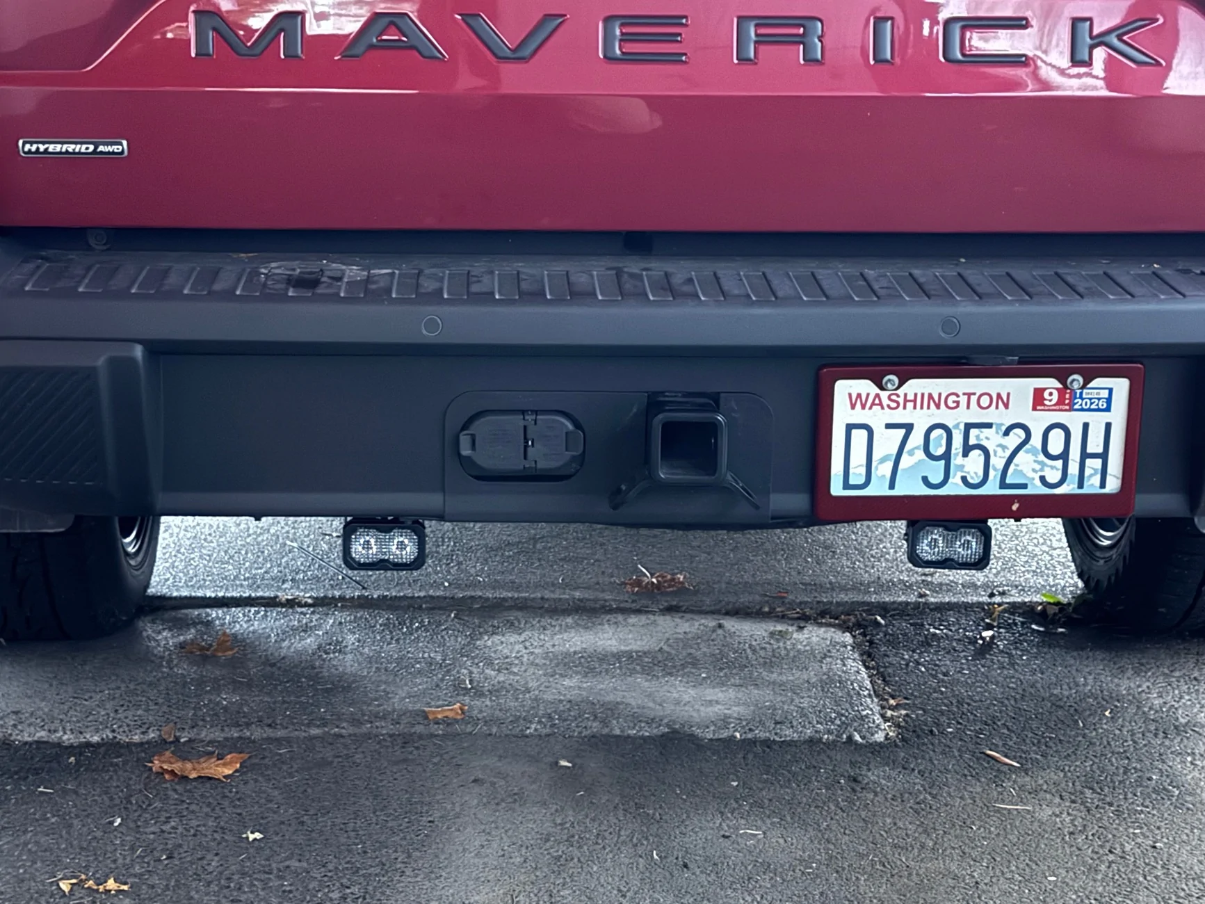

originally, was going to put some ss3 pods, but they're a bit too big & couldn't get them aimed high enough..decided to go with the SSC2's with red backlighting & I think they turned out pretty good..the backlighting should offer a bit more visibility & the lights themselves are a definite improvement over stock.

How are they powered? Separated switch or tied into the reverse light wiring on truck?
had a 2 to 1 deutsch splitter & a short extension:
from that, I wired a deutsch plug to a 16/2 cable & then ran it up & over the suspension, next to an existing wire bundle & to the front and up into the engine bay. another deutsch plug & then to the included deutsch connector that came with the lights. wired into my SPOD bantam lt wireless controller with the backlighting on one circuit and the lights on a separate circuit.
