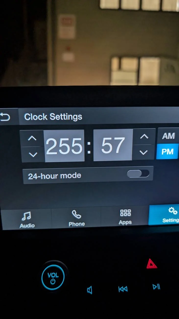

Clock Malfunction

I have had that happen as well. Also my display freezes up at times.
My display did more than "freeze up at times," it froze up period. When I drove up to the dealer and backed in to a parking spot, it froze up on the backup camera! The Technician in Service did a Reset by turning on the radio, then long pressing the On/Off Volume knob (p. 397 in Owner's Manual) AND the Station Seek Forward button (p. 399, Using Seek, in Owner's Manual) SIMULTANEOUSLY. After a short "loading circle" -- fixed!

Every morning I have the same issue while setting the clock. There is no way to save the clock only to go back and a repeat
Hi there! Would you send us a private message with your VIN and dealership name and location? I’d like to look into this concern on my end.  
There is a recall for the freeze ups. But the Fix has not been released yet.
