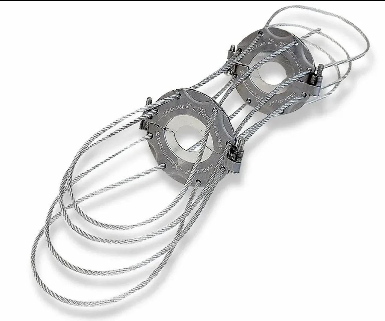

I've talked to Prius owners who have lost three, three catalytic converters. The last two had professionally installed Cat Clamps. She was a young lady who was not a DIY'er and had a muffler shop install them.
No match for power cutting tools.
No, I get it why she has had them stolen despite these. That's my point. Once they were under there with power tools, if doesn't take much longer to cut the cables than the initial theft. It's not like smash and grab for cars where the deterent of nothing visible is enough. These devices aren't stopping someone already under your car with a Sawzall.
