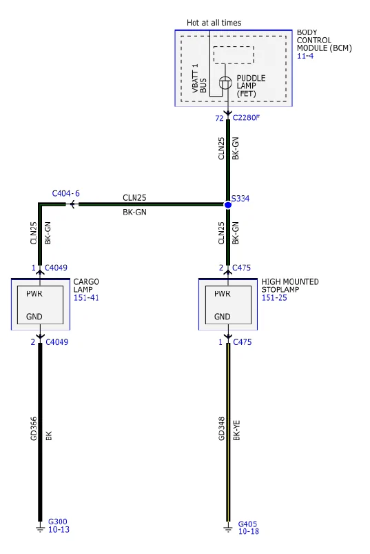

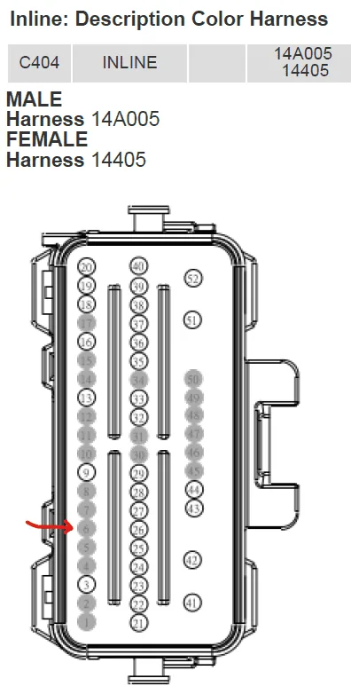

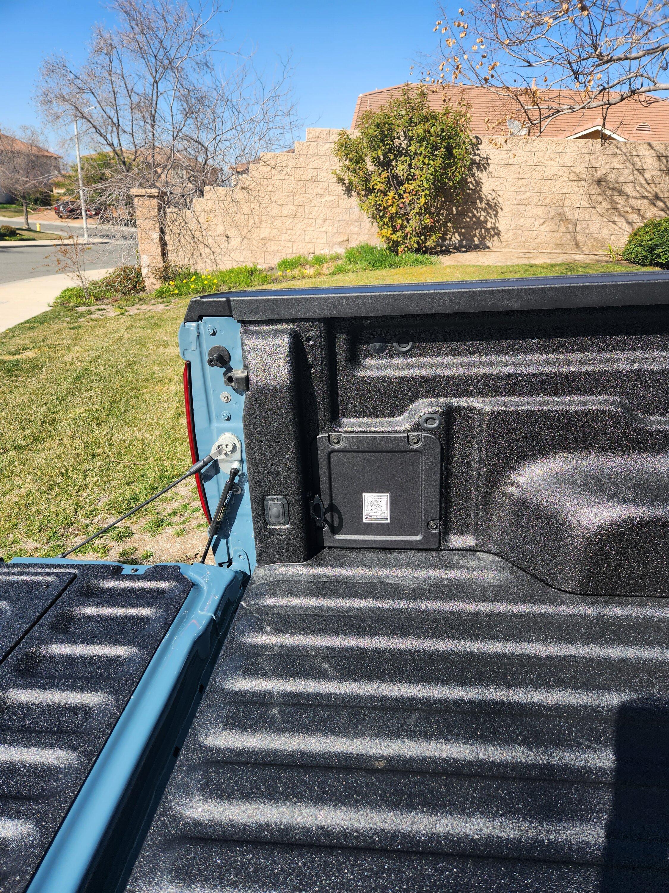

If you want to tie it into the cargo light to function as the bed light then you can tap power for the LED strip to Pin 6 of the C404 connector beneath the driver's rear of the bed. Pin 5 on that same connector is for the bed light switch. It needs to have some amount of resistance for the BCM to properly register it (versus just a short to ground).
Discussion between myself and Telemachus starts here: https://www.mavericktruckclub.com/f...-aftermarket-under-rail-leds.7570/post-511782

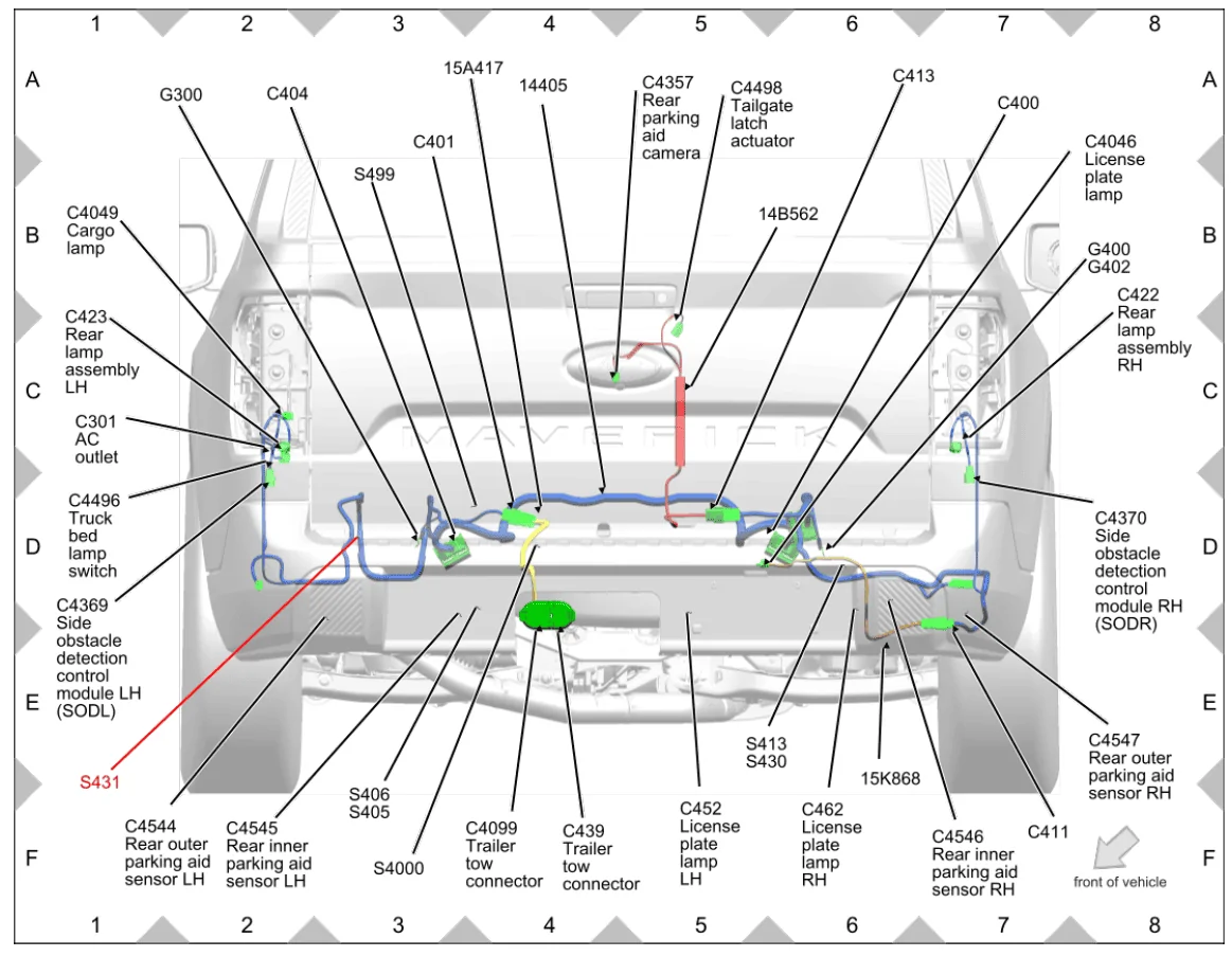

It appears to be part of the harness that spans the rear 14405. Should be pin 6 of that connector adjacent the spare tire C404.
I found the correct connectors for the female side of the C404 connector. I picked up a pack at my local Ford parts department:
DU2Z-14474-CA
It comes as a pack of 5 terminals attached to green wire and some crimp butt connectors with heat shrink.

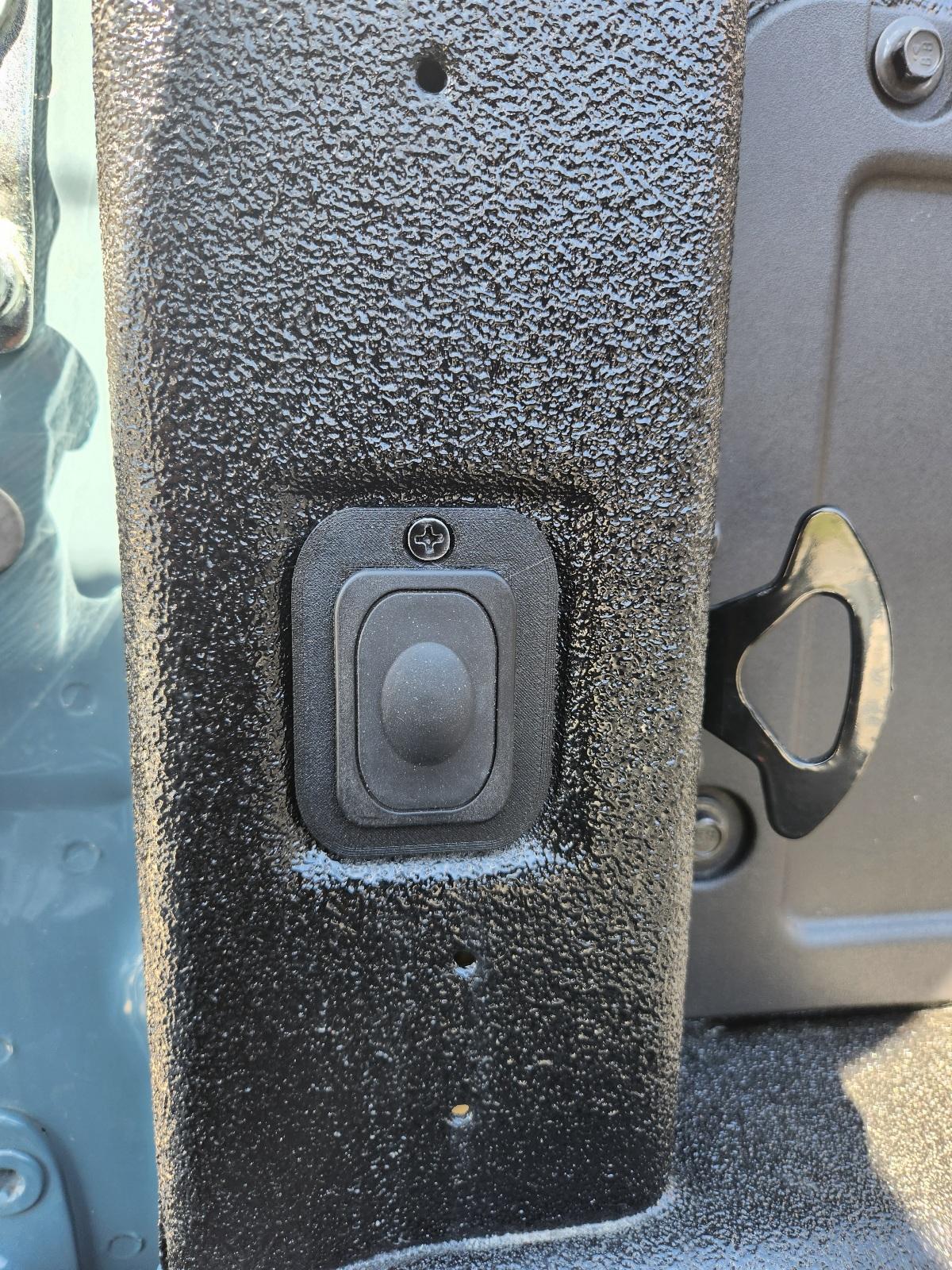

I Installed my wiring for the switch (pin 5), power to the bed lights (pin 6) and ground. I'll install the lights in the next few days, and the switch is on the way.

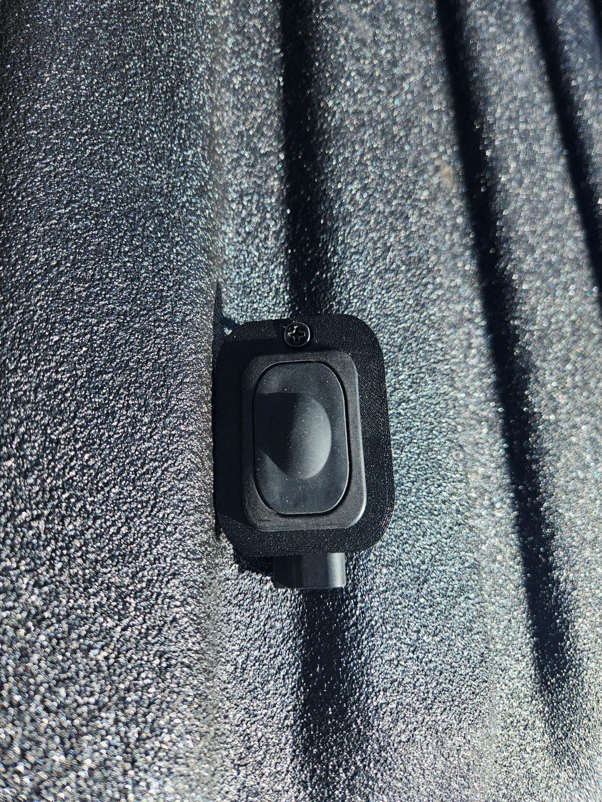

I finished up the install of my lux lighting button today.
I used a 1L2T-14K147-AA from Ebay ($10) and although it has no resistance on the button itself, my route to ground goes to the ground screw by the muffler, and it provides enough resistance traveling that far that this button works fine. If the grounding point is closer to the button, will need a 100ohm resister in line.
I designed a 3D printed bracket to hold the button where the flexbed covers are.
I bought a generic WPT-984 wiring harness off E-bay that interfaces this button.
Thanks to all for pointing me in the right direction. Lux lighting is doable on an XL, LOL.

The 12V light leads are ready to be wired to 12V LED lights around the perimeter of the bed. They work as they should when pushing this button or the cabin cargo button. I just haven't ran them yet.
