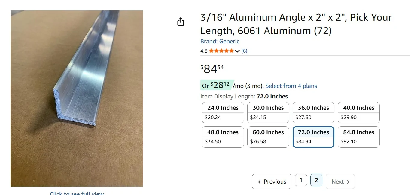

Since you already have the Elevate rack, that mounts on the t-slot rails, why not just add a couple of lengths of 2x2x3/16 aluminum angle, with maybe a Thule Aerobar sourced off of FB Marketplace for the forward crossbar?
Just some drilling and t-bolts.

That is a fantastic idea! I was considering buying some extruded aluminum and just building a frame atop the Elevate Rack, but this would keep things slightly lower and still maintain the look I need.
Thank you!

As for tools, yes I can def fabricate something and was leaning toward the extruded aluminum option with brackets to mount to the Elevate rack, but the 2x2 or 3x3 L-bracket will be MUCH cheaper and easier to work with.
I need something that can pop on/off easily as I don't want to take it off each time I go to the wash (which isn't often) but needs to be removed (I think) before going to the wash.
