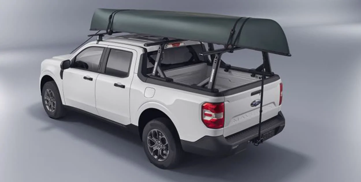

Can't seem to find any pics of a Maverick with a canopy carrying a canoe. Would like to see what people have setup on their trucks. Believe you would need a couple racks on the canopy and one on the truck to even the load out like in the pic?

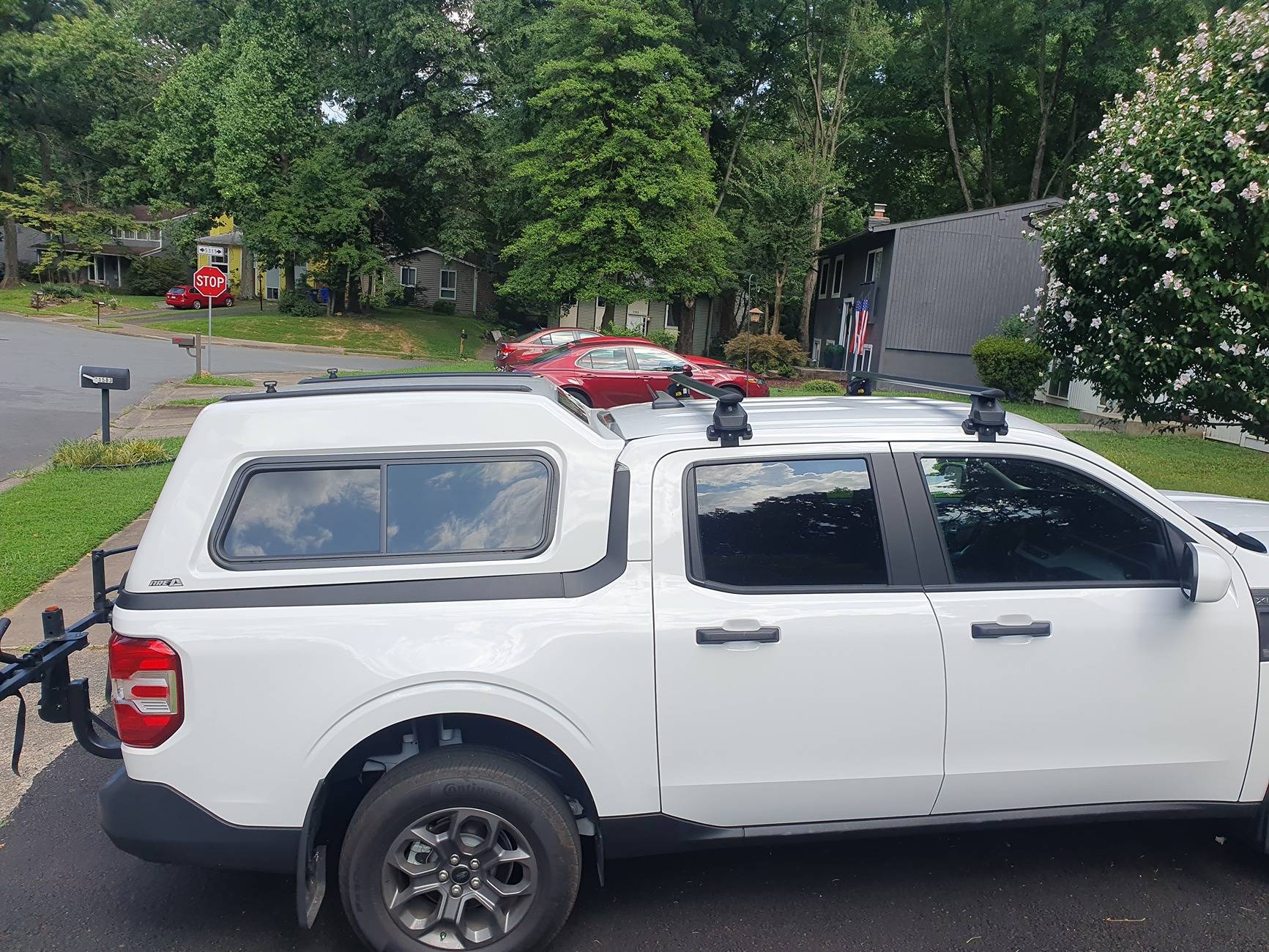

Easy as pie. On my ARE MX, the cab roof rack matches the height of the canopy, so I would just put some surf pads down or any type padding. Then the canoe would sit directly on top. The MX has roof rails and I have tie down cleats for the rail. If you had a cab height canopy ARE V, then yeah, probably both would need a rack.
