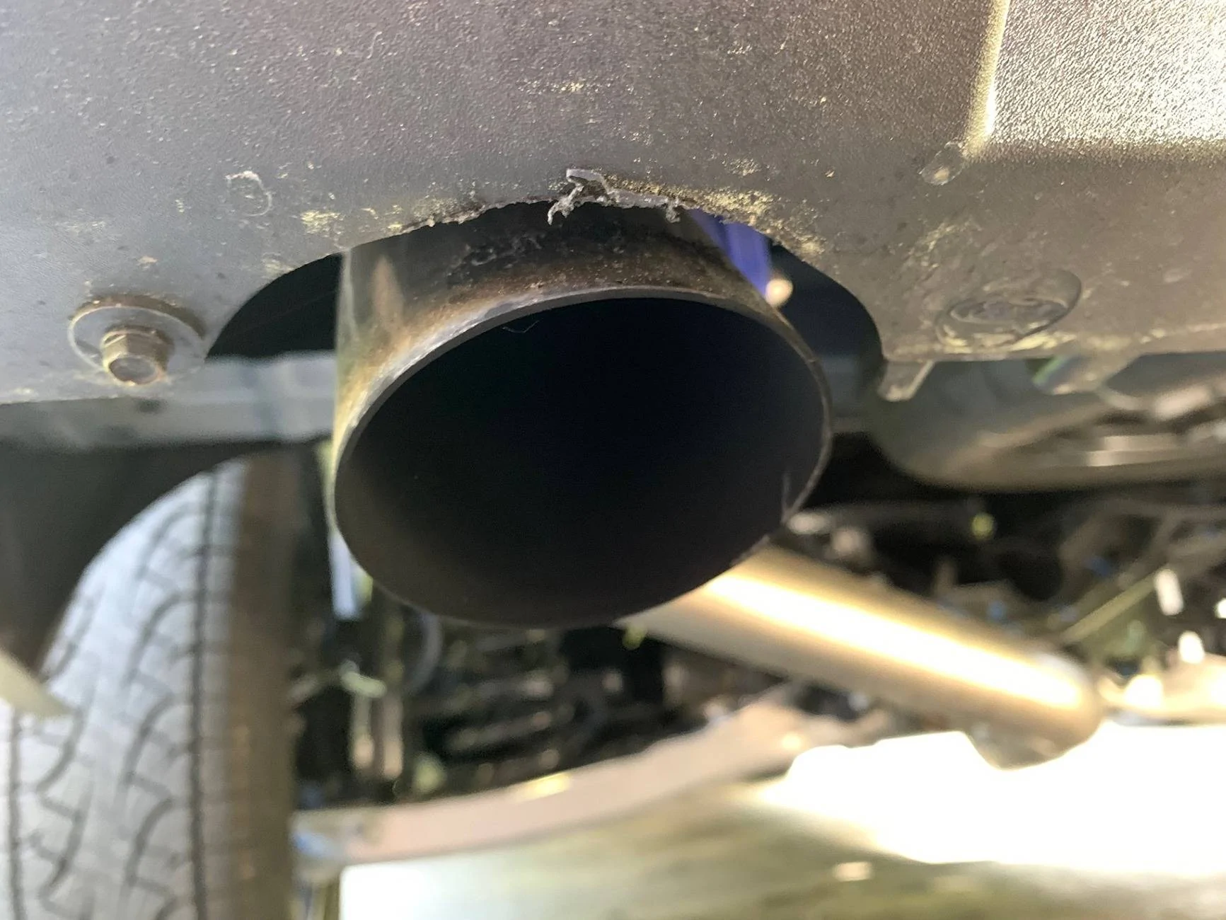

Makes sense I towed at least 20k miles of some very heavy loads and this never happened until I was pushing hard with less than 93 Oct fuel.
I must say mine is not nearly as bad as a few others. Mine is barely noticeable. But looking at a brand new 24 on the lot it’s not surprising. They are not bent or pushed up. The exit is blowing hot gas on the plastic. Bound to melt at some point when really pushing the engine.

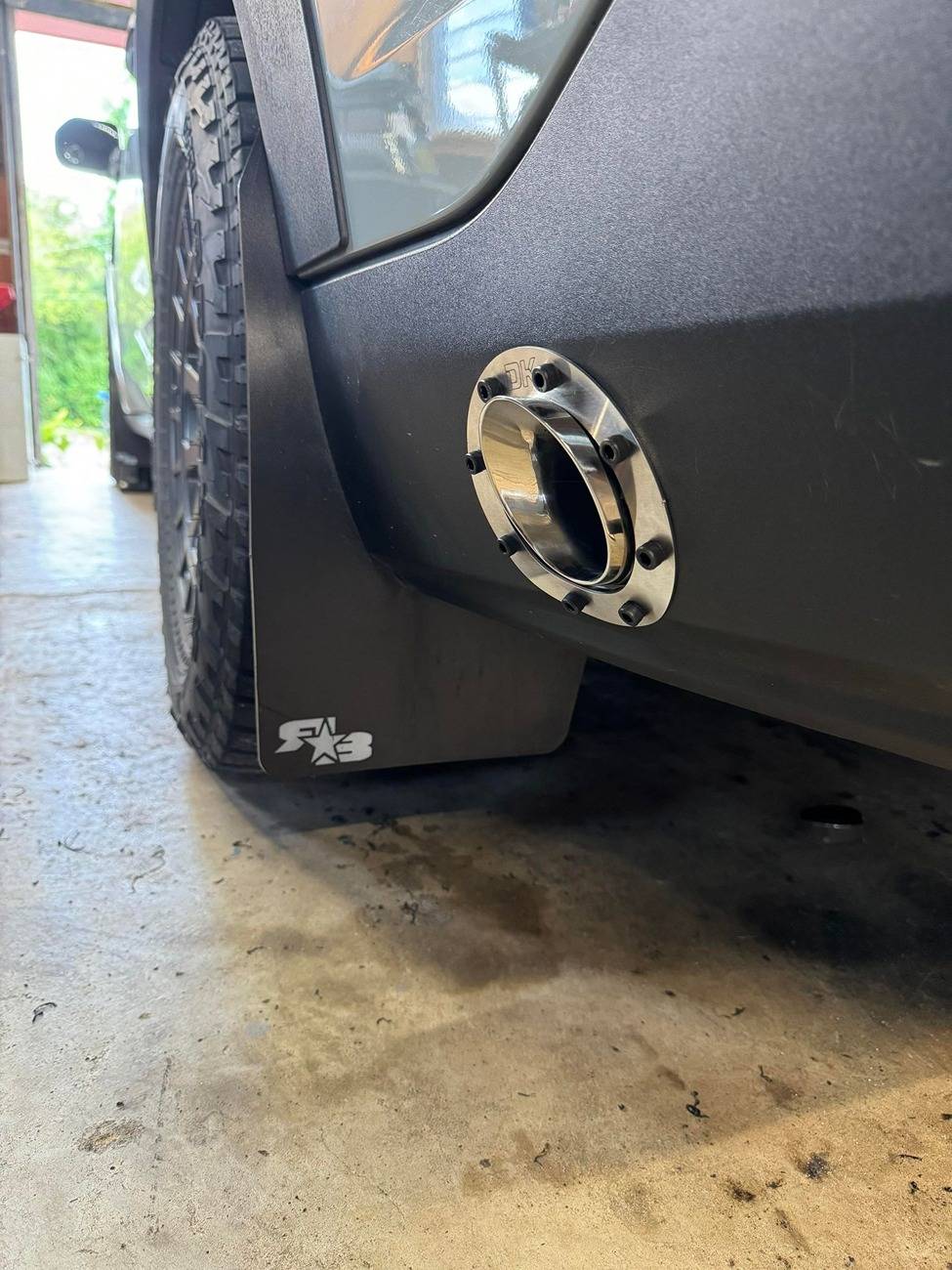

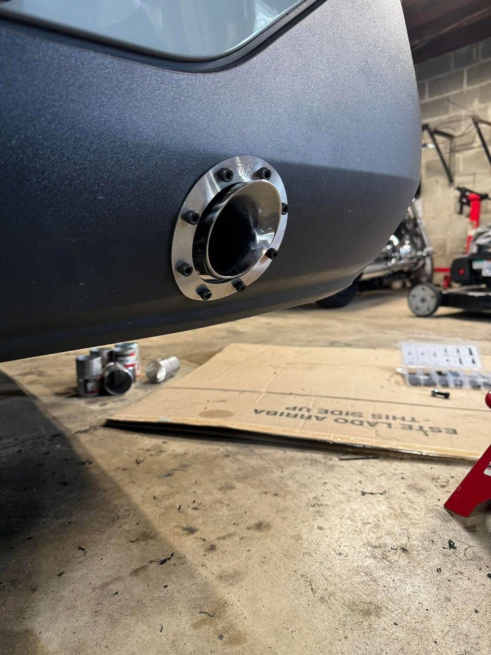

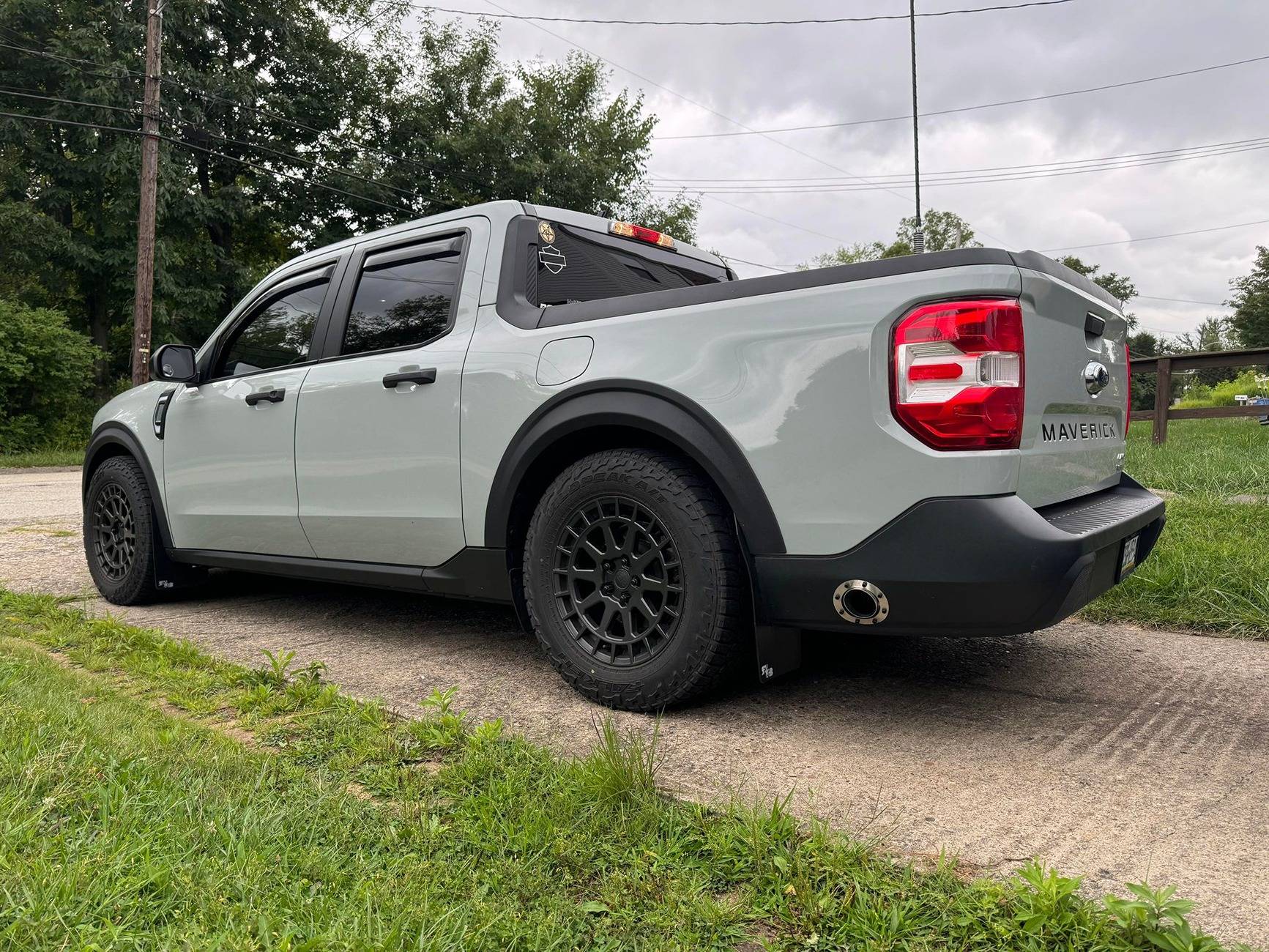

Hey all, just sharing my most recent modification. I've been wanting to do a bumper exit for a while, seen a few others took suite as well. Eliminated the resonator, used some off the shelf exhaust parts, as well as a nice pre-bent section for a 90 degree. Everything came out pretty good. Coupled with a Thrush welded muffler, it has a very hollow stainless sound, very Focus ST. (Added side shot and audio clip here)
