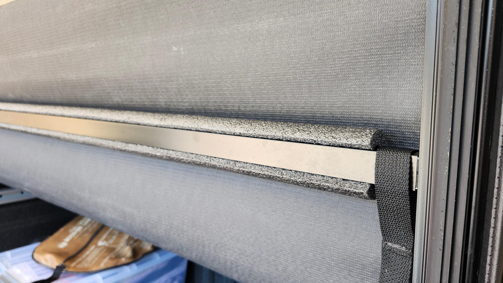

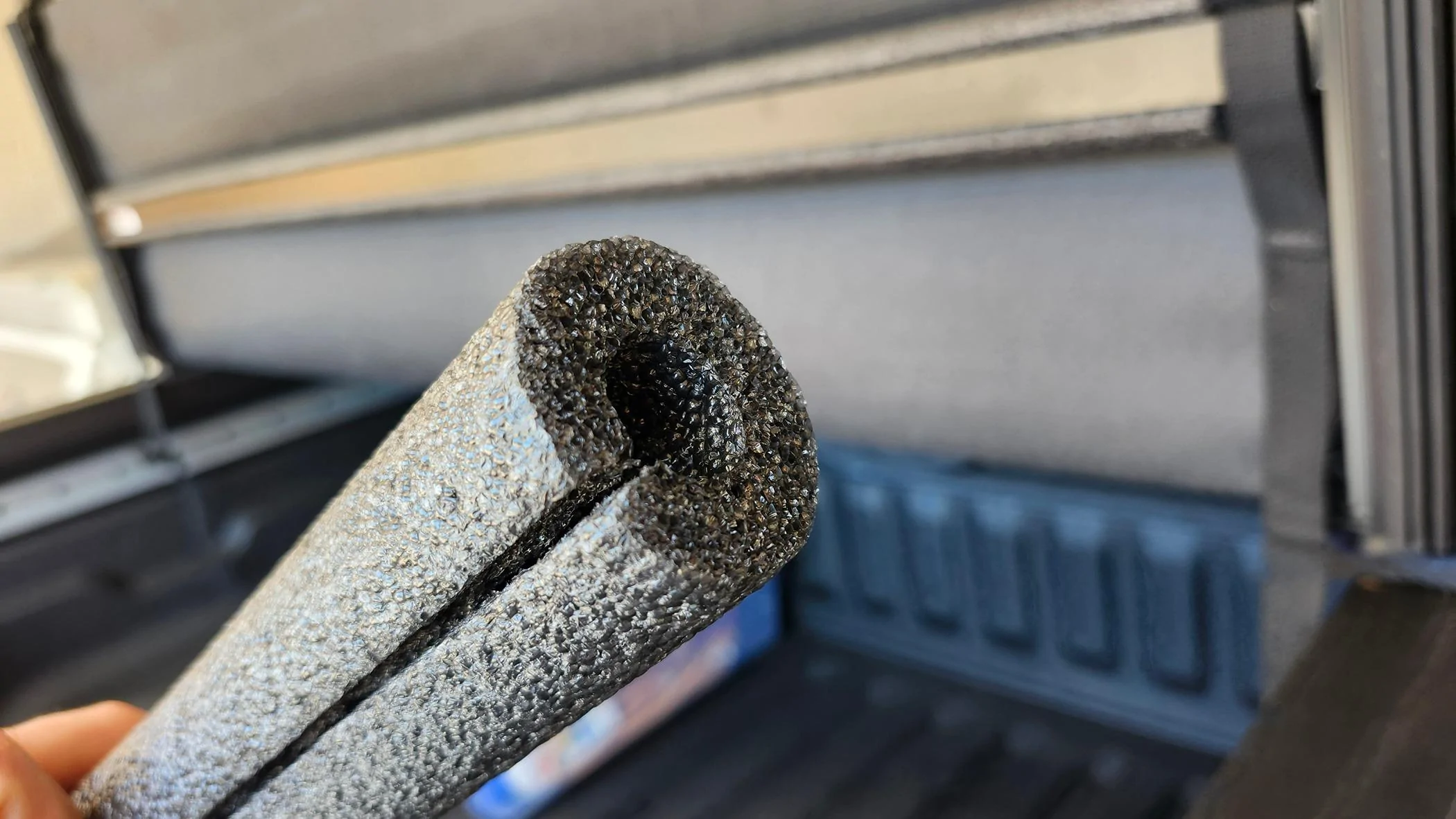

I'm going to try adding a pipe insulator or pool noodle to my cross bars. This can raise up the fabric to about where it ends up when moving at speed. Alternatively, I may go to Home Depot and buy one of their nicely arched (warped) 1X2 pine boards, trim it down for weight and try replacing the cross bars. They're just mounted with velcro straps anyway.

Ah hah! A creative use for those awful warped boards — I like it!

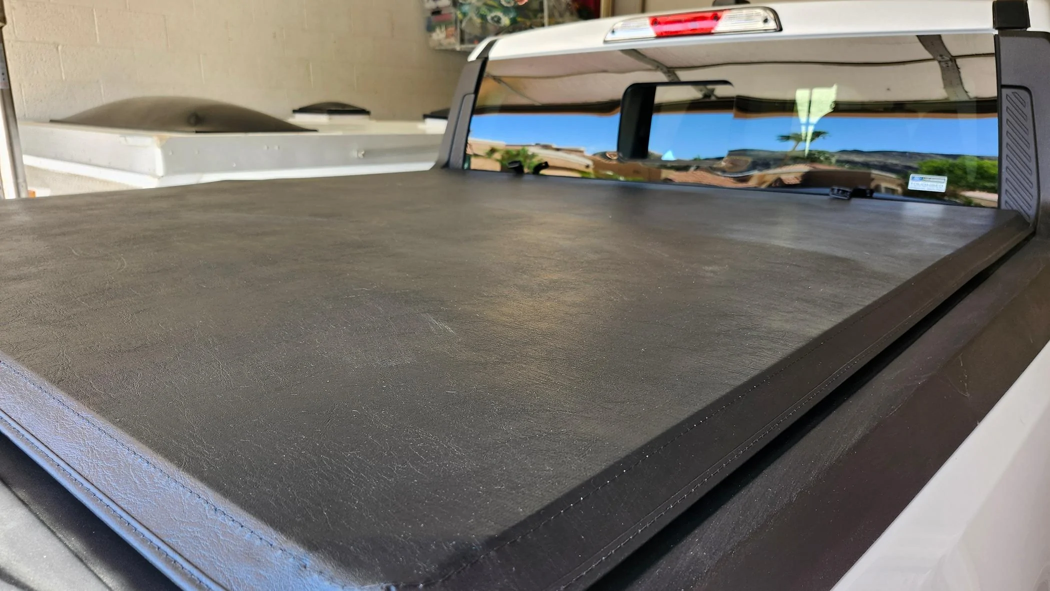

I I haven't tried it at speed but I suspect that for a 1.25@ investment at the dollar store it reduces the fluttering.
