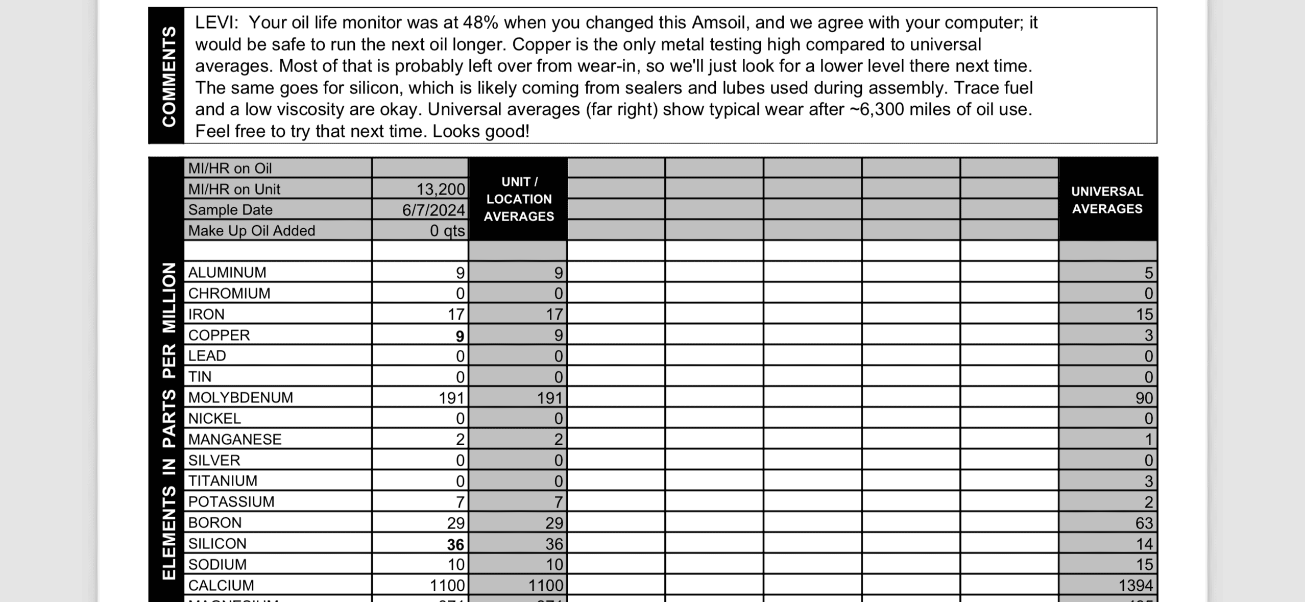

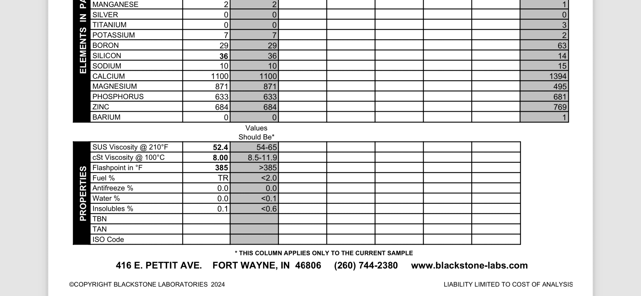

So got my report back.
This is on my Livernois tuned 2.0 running a mix of e30, 87-93 tow and performance tunes. About 50 percent towing a trailer over 5k lbs.
Mix and of spirted driving city and highway. Couldn’t get a better mix of driving.
Ran amsoil 5w30 and changed at 50 percent oil life just to check. Also running KN airfilter.
Everything checks out to run full oil life monitor changes. Kinda what I expected as I’ve followed this same protocol for all my ecoboost engines and have several over 300 and one over 400k miles with zero issues.
Ford Maverick Blackstone oil report! IMG_7350
Ford Maverick Blackstone oil report! IMG_7351

The low viscosity bothers me. I did Blackstone report on mine too, and report low viscosity as well. Our Escape report had low viscosity as well. Gotta be that 5W-30 oil values.

It’s only slightly low. Keep in mind these engine at one point had 5w20. I normally would look at a thicker oil but like I stated all mine have made over 300k so it must not do any wear. Also if it was an issue the oil report would show accelerated wear form the thin oil.
I e toyed with thicker oil in the summer while hauling. But it’s hard to change since I’ve had such good luck. I’ll do another report next spring after some more heavy hauling and a good mix of all my styles of driving.
