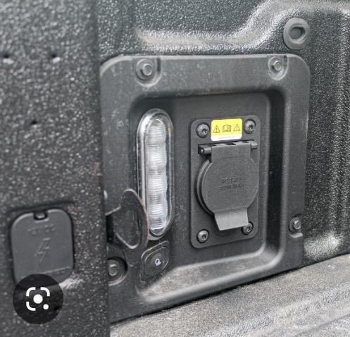

I have a hybrid xlt Lux that is scheduled to be built in mid-May, and have a question about the bed cubbies. Do they only come with one installed standard and if so, what is in place of the other?

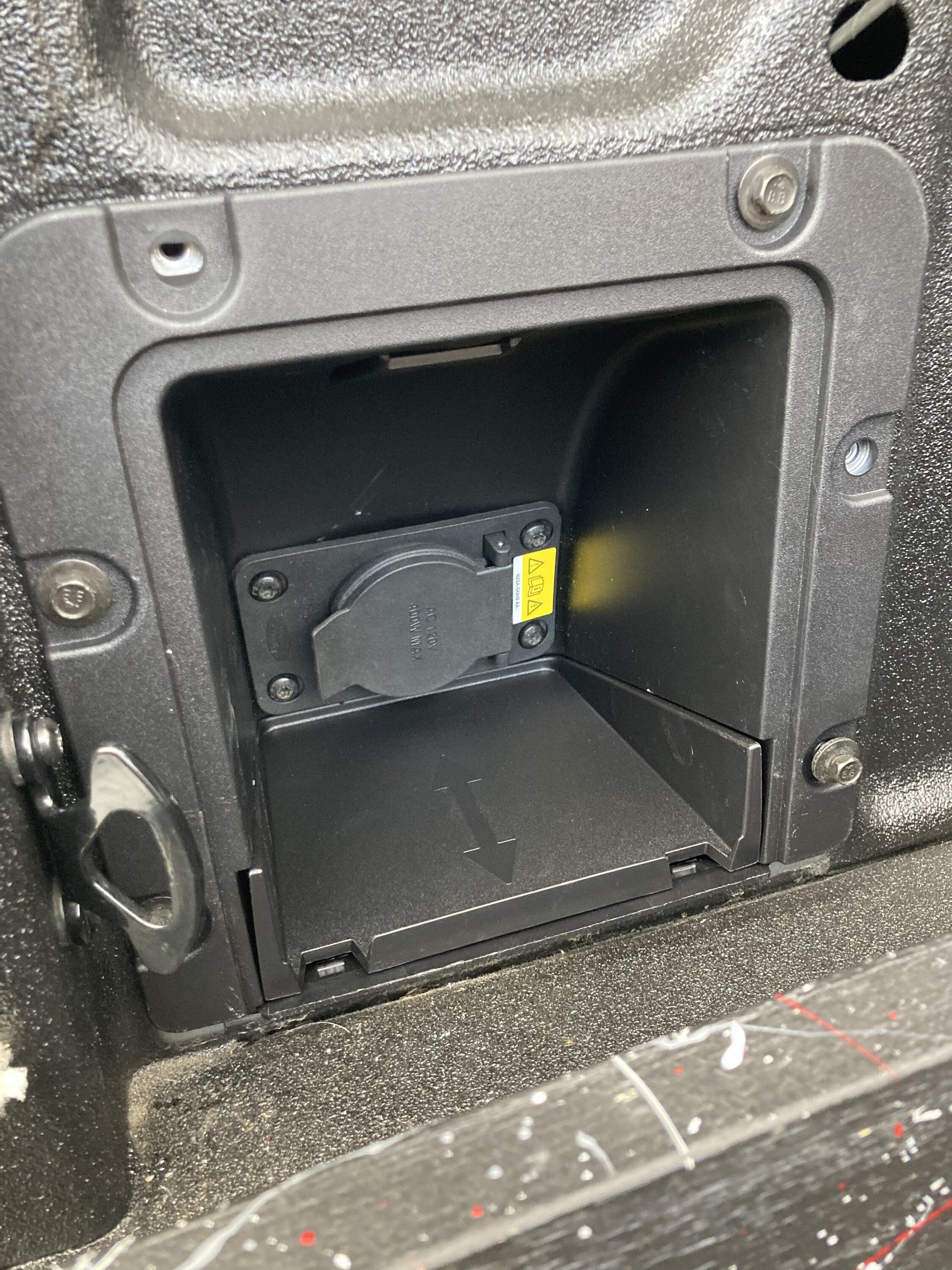

My XLT with Lux pkg had the 400w outlet and bed light on drivers side. Bed cubby on passenger side. I added a cubby to the drivers side, and moved the outlet into the bed cubby.

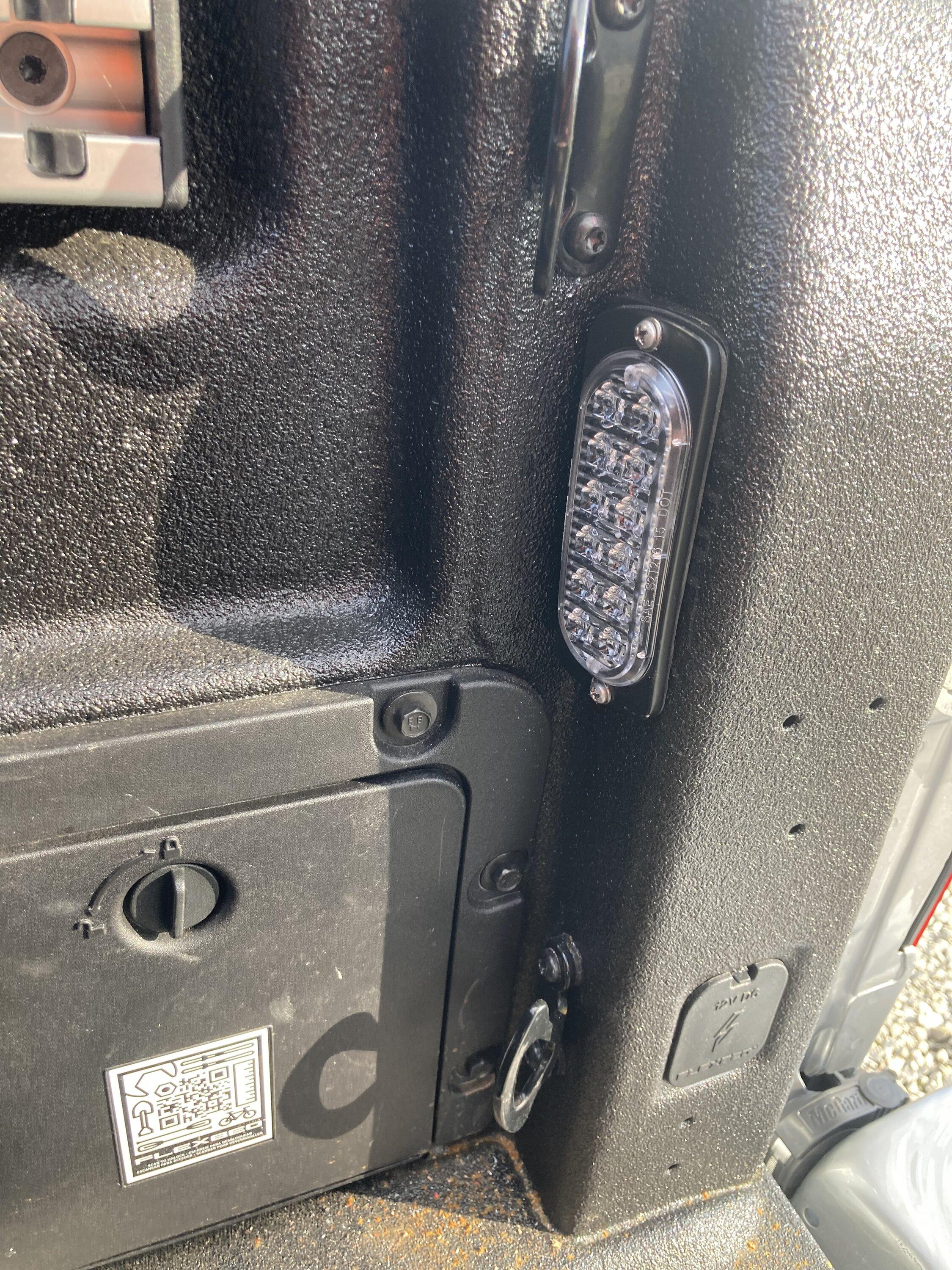

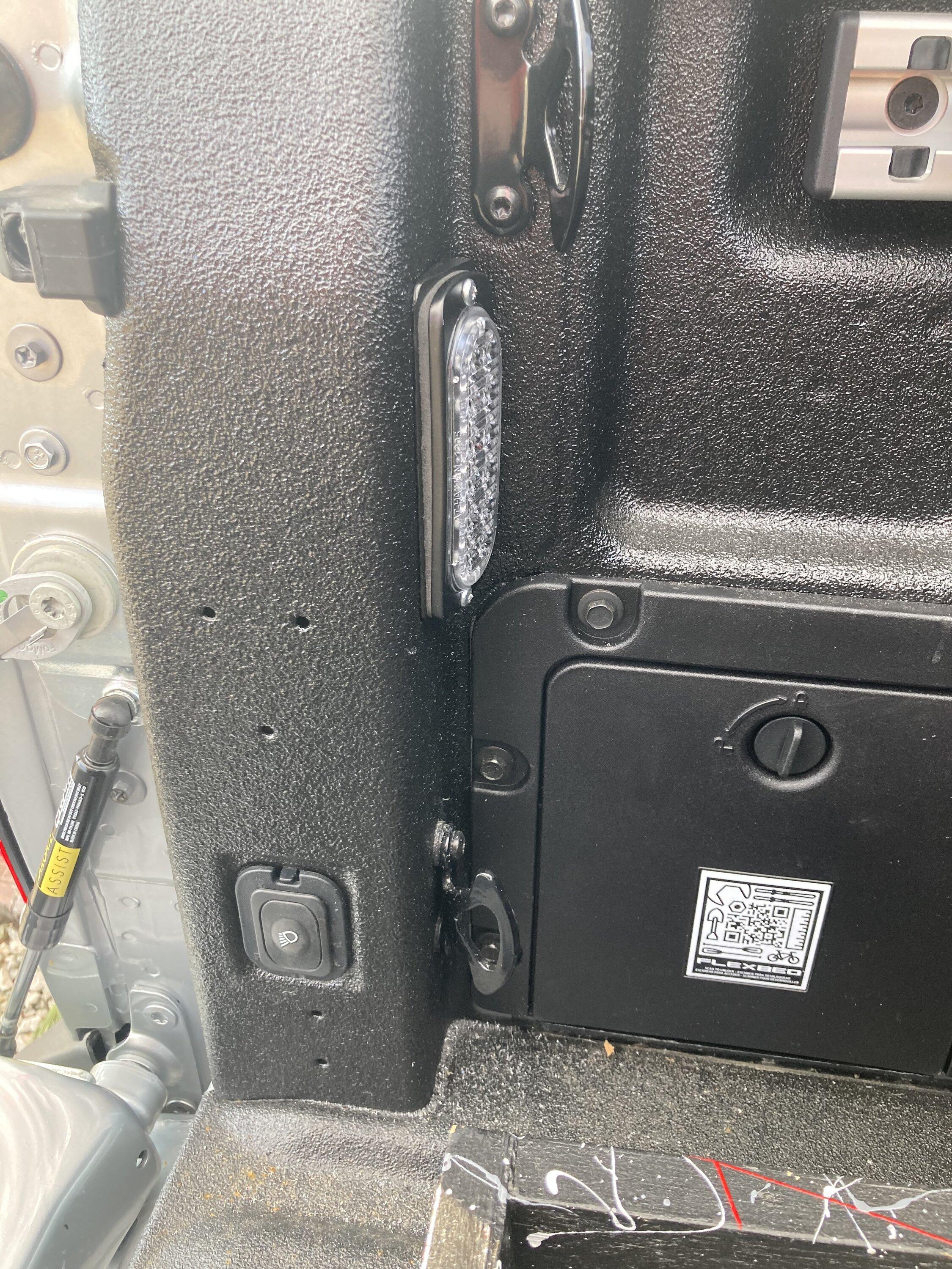

Not really possible the way the light is made. I added an LED on each side of the bed, and used the oem wiring and switch to run them. The extra pigtail wiring that comes with the truck will plug into the connector for the oem light. Moved the switch to the 12v power outlet cover. I copied this from another member on the forum. I think adding the cubby to the drivers side is a must, and when you see the back of the drivers side taillight without a cubby after a few days driving the truck, when you’ve had rain or snow, it’s easy to see why. Also installed a couple of wedges behind the lights to turn them just slightly to light up more of the bed

thanks..............where I mounted them would shine mostly on the bed sides, couple wooden wedges cut out the shape of the lights and spray undercoating turned them enough to light up the entire bed.
